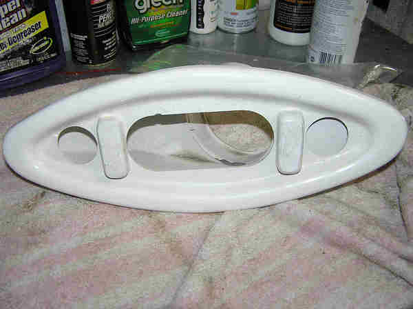

I agree 100%. I want to make sure that the air would be forced in . I just think that the wind may be deflected above the scoop in my boat. As I said, I dont need the extra clearance, just want the air flow. For now, I opted to upgrade my vents on the sides of the hull. The ones from the factory were very restrictive. Problem was, no company made a direct replacement. The holes in my hull were too big. Attached are a few pictures..

I had to use part of the old vents. I cut them up and mounted a billet vent plate on them.

Nice billet vent plates. Where did you get them? I am very interested in doing the same thing to our boat. How did you cut the original vents?

I got the billet vents from Fred @ TrickMarine. They are Eddie Marine vents. To get the old vents apart, I carefully tore off the plastic cover by hand. I cleaned them up with a hand grinder. Then bolted on the billet vents.
