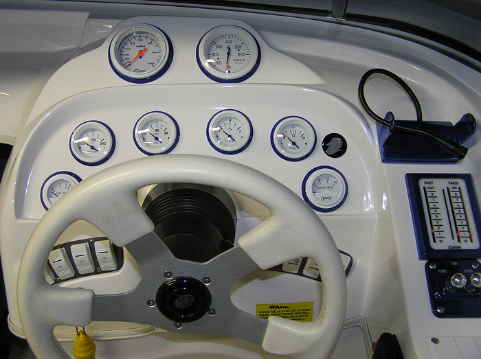

Our boats are identical. I used Imco's tilt helm. Fit like a glove. Take a look at the picture. Their hydraulic unit fit perfect also. I got it in through the wiring access panel in the cabin behind the dash. If you want to see, I can take a picture this weekend for you.

I ordered the Imco product you suggested the SA-2. I was under the impression they did not have a tilt helm. The stem angles would be fixed at straight out or 15 degrees. Pictures would be appreciated.
