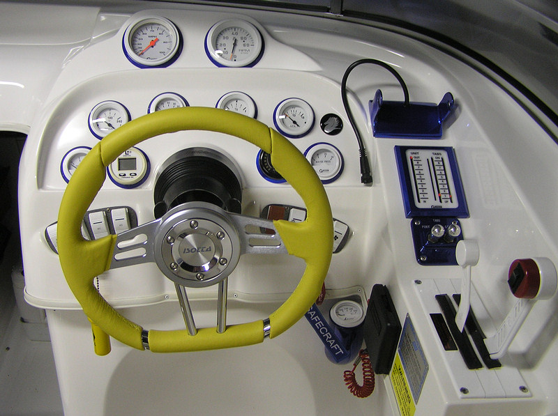

Rob,
I have HP-1000 tabs. The problem with installing these tabs is the extra holes you will have from the original tabs. I am not skilled at fiberglass repair. What I did to repair the old holes was hammer in wooden dowels drenched in white marine tex. Then a quick coat of white gel to finish it off. Unfortunetly, the repair looked like $hit. So, I covered some of the mess with a gunnel step plate. I'll take a picture later and post it.
The next problem would be the indicators. There is just no easy place to mount it. I'll post a picture later as well. It is the best I could figure mounting it.

From: long island, new york
Default Re: Engine Shop
OK, just came in from the garage. I took a few shots...
Attached Thumbnails Engine Shop-dash-.jpg   Engine Shop-tab.jpg   Engine Shop-transom.jpg
