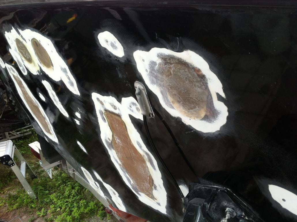

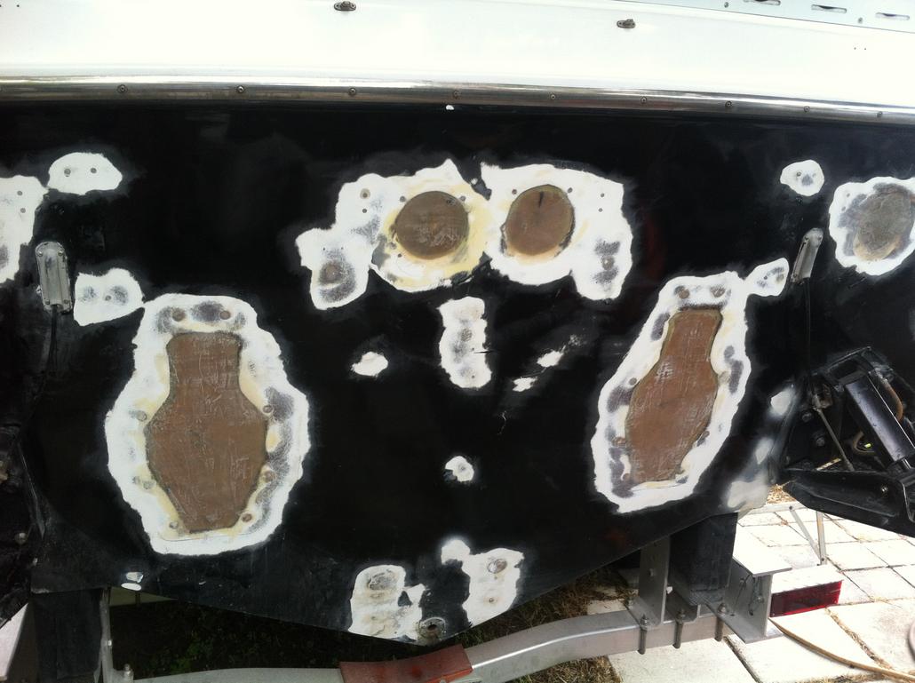

here are a couple pics of Bikerga's bullet outboard conversion progress

Wow if I could get 66 ish I would jump for joy I was thinking only 62 without fine tuning, tops. The transom is supported, transom painted and bracket for engines is installed. Now working on new deck where engine was. What a difference when the back is all opened and you have so much more space.

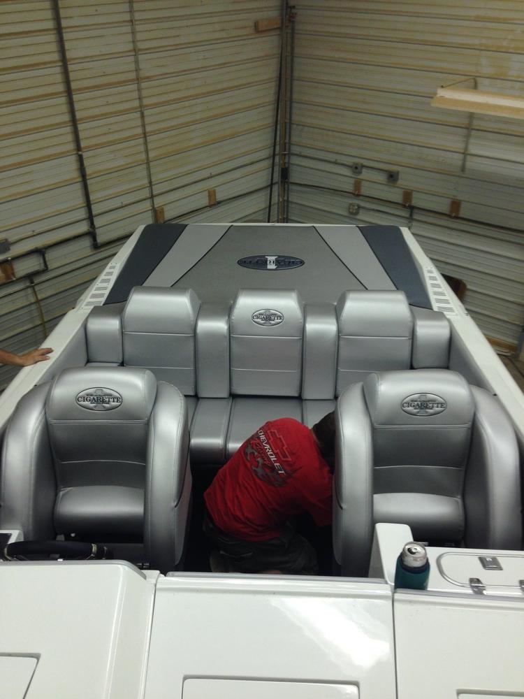

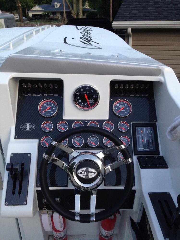

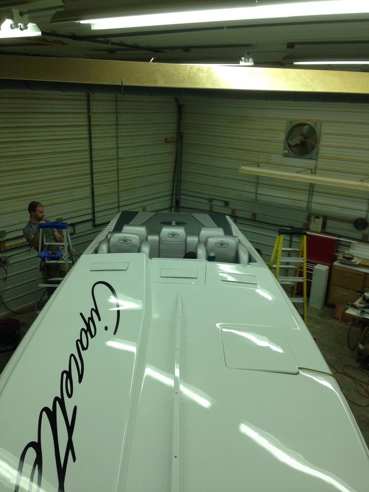

There some pics of my bullet I restored up cater was nice enough to post them for me is under Eric's bullet let me know what u guys think !!

Eric's ride
