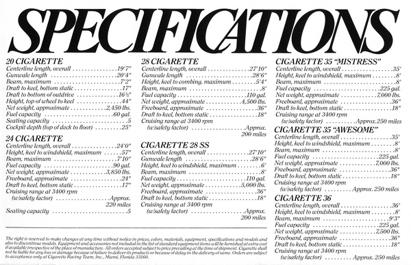

Some Cig Specs

The specs show the net weight as 7,000lbs. But everyone talks about how heavy they are, and 7000lbs for a 35' boat is not heavy. The one I rode in crushed waves like more than 7000lbs. What gives?

Thanks for the specs, what year are those from?
What's with the 35' Awesome? I haven't heard much about these - any pics?

I went to the scales with mine and about 80 gallons of fuel and then back to the same scales, same spot with just the trailer and she weights 10,500
