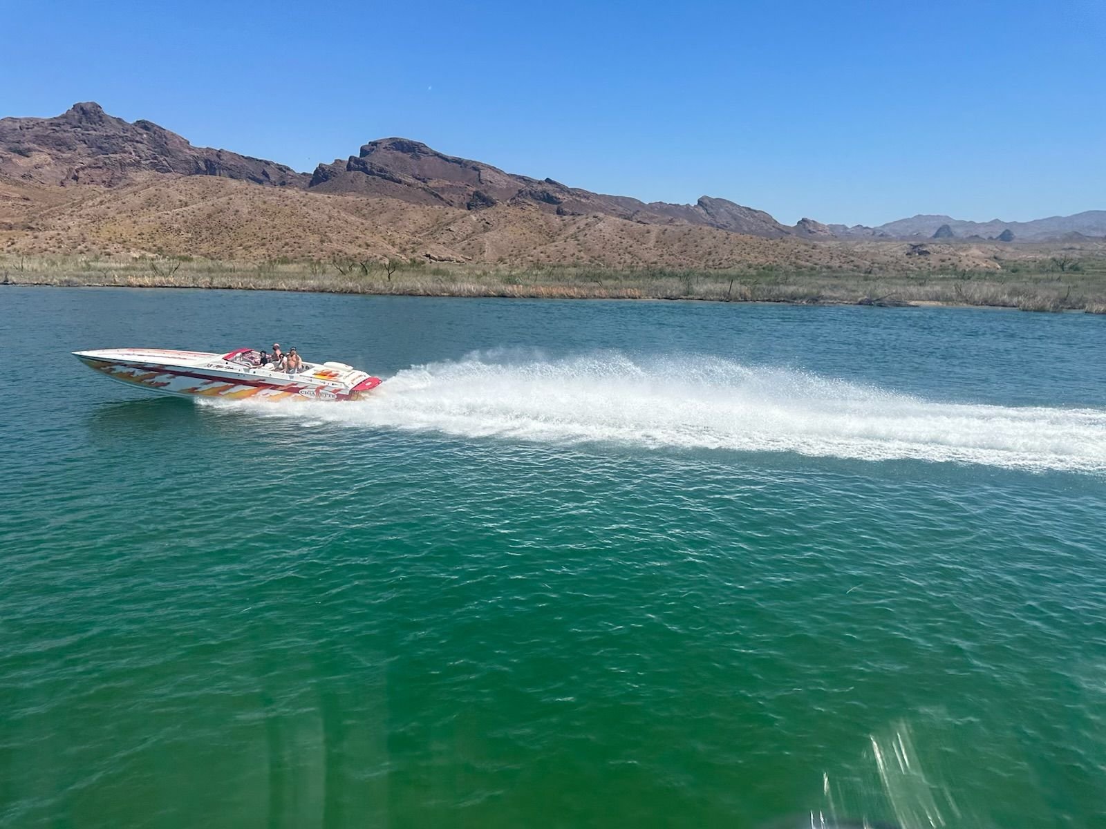

It definitely sounds like the high x is your issue. We ran with the rat for a little while on the 05ish key west poker run. Didn’t notice any porpoise. Ran smooth at 80ish.
our 99 gun is vacuum bagged. Dry 6’s, 1,000 hp power, running 17.50x30 / 15 rake mercury 5 blades turning in. Runs 105+ (I haven’t personally seen that or tried but that’s what I’ve been told by prior owners) I ran it up to 95 last time out and it had a lot left. It’s a factory 6 boat and like frick said I heard the x is conservative because it was built to run in the Pacific Ocean in rough water. I’ve eye balled the shafts and they look like they’re even with the bottom of the hull but I need to actually measure it. It pops up on plane pretty easily and has crazy torque, props turning in takes some time getting used to around the dock for sure.
I think you drop that x it’s gonna be the fix you’re looking for.
photo for property sakes lol
