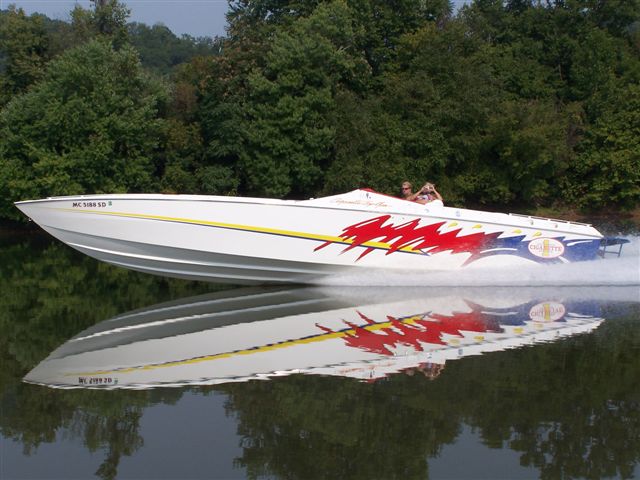

Picture of her from this summer.

Looks good
