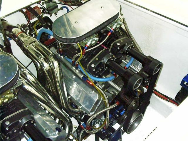

I'm not sure if it's different for a twin step vs. a straight bottom as far as clearance, but my blower engines fit under the raised hatch (It is a 2001 or 2002 hatch). I can get you a measurement from the middle of the crank pully to the top of the flame arrestor if that would help.
Attached Thumbnails Blower Cig question-tgcockpit1.jpg   Blower Cig question-tgengine1.jpg   Blower Cig question-tgengines.jpg
