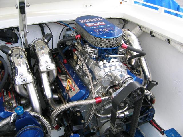

How many lbs of boost are you running now at 650? How much more will you need to be at 800. I would like to try this I'm running 509ci 250ci blower 5lbs boost 30 bravo with boxes straight bottom TG 82 mph on GPS. I think My HP is 650. What is your set up?

Seahawk, I would not try this running bravos. You're asking for drive failure. Your boat is running and looking great! I would hate to see you get frustrated with drives breaking.
Yea, I'd second that for full time use, remember we are going for a 5 day set up then back to "stock".
After seeing Dennis run 2 years ago, we have to give it a run
I was just thinking that if it is as easy as changing a pulley and a prop I could have some fun with it. I agree with keeping it the way it is. I just came back from the drag races and wow, talk about horse power. I guess after that the boat seems slow
