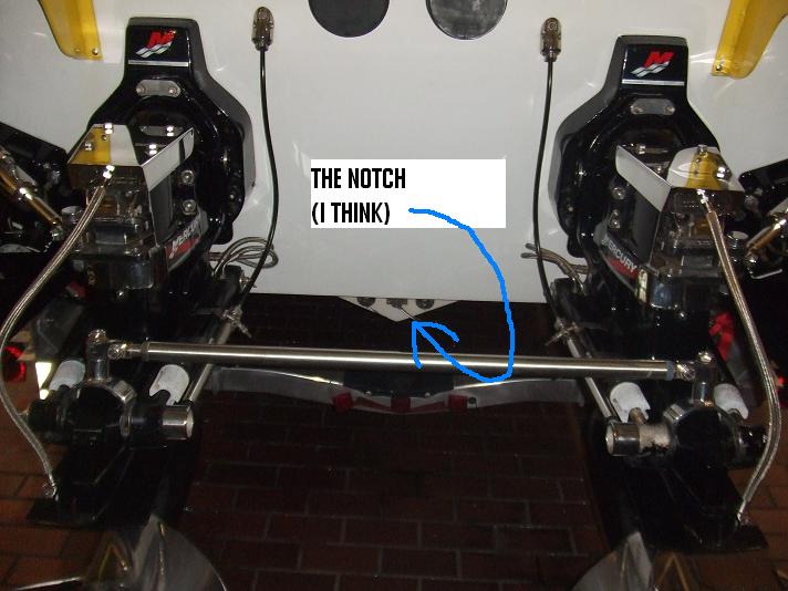

im thinking the notch is the area of the boat underneath where the V runs down but then stops short of being flush with the transom, where the 2 brass water plugs are to drain the eng compartment,
by "taking the notch out" i think it means extending that V all the way back to be flush with the transom
my question is how does anyone know it would work, have any other mystiques had this done to them

This Is The Notch, (i Think)

Boomer's pic shows a notched transom. I think originally, in the 80's, makers started to add notches to hull design to get more water to the props and be able to raise the X-dimension of the drives, especially on single engine applications. All this was done to increase speed.
I'm not an expert, and the hulls may be a slightly different design, but Bullets seem to have a slight porpose problem also. They came in various years with and without notches and I think both porpose. I also think just saying there's not enough running surface is not necessarily true. There are lots of boats with similar hull designs that are shorter than 30 ft that don't have porpose problems. Running surface is only one of many factors that include rocker, chine and strake design. If there is a fix, the best source to find anwsers to these problems would be the original designers at Cigarette.
