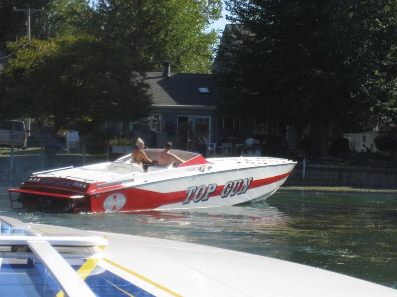

Im running 600 H.P. Roller Motors, Bassett Exhaust and with my 23 pitch marage 3 blades I can see 70-72 at WOT 5300-5400 rpm. When I put my Hydramotive 4 blades I hit only 65-67 at 4600-4700 rpm I cannot get it to spin more than that. The Nice part is the crusing Speed at 3200-3700 rpm with the 4 blades I dont care about top end The boat sounds like its running a 100MPH at 4000 RPM. This is the first boat I have never had some one run up on me to race them Weird. Or mabe Lake Saint Clair is always a 3-5 foot chop and the 30 footers and under cannot handle it.
