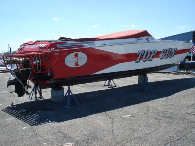

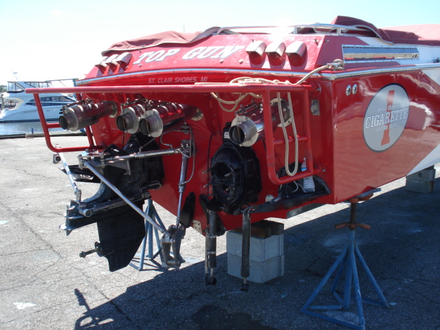

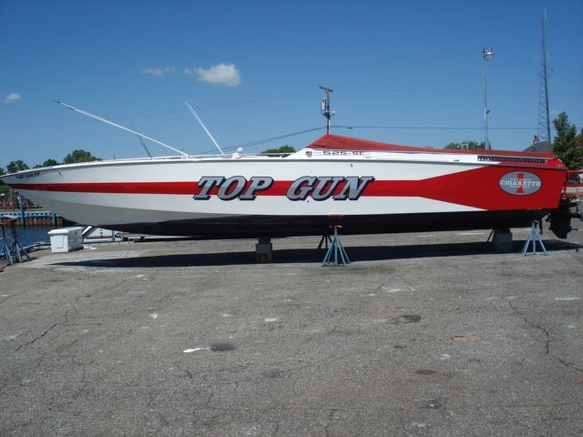

I want to strip the bottom this winter.
Chemicals? or Soda Blasting?
Any Ideas?
Here is bottom now Im haveing new drive put on this week that is why it is out of the water.

Got any idea what type of paint is on the bottom ? It may be an ablative which will wear off over a couple seasons.
ed
