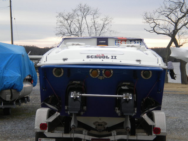

Originally Posted by jaysflatdeck
Thanks for all the info dose any one have any PICS even of a FLAT BOTTOM TOP GUN
Here's mine (1988 Top Gun). No porpoise when trimmed correctly
Attached Thumbnails Flatdeck with #6-pokerrunhelo2resize.jpg   Flatdeck with #6-boat-project20111-065.jpg
I cant tell are you using boxes also what do you have for power & get for speed
for them to work on your boat 100% perfect ....you either need to cut a notch in the transom or use boxes. The above 88 has a notch !!!!

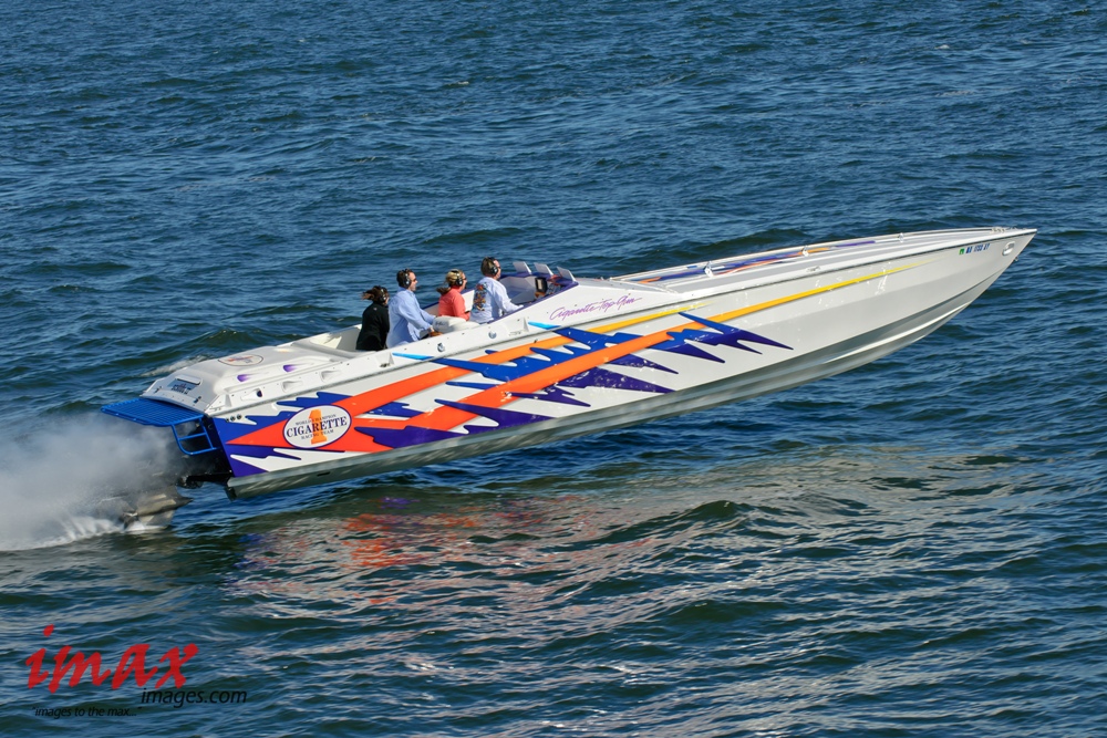

Originally Posted by cougarman
If you search the forums about 7 years back a chick had a 38 with boxes and #6s,..sweet set up and it porpused.....she didn't care cause she like how it looked.
Jon
That was BlondeCigChick, & the boat was called "Ruckus":
Here's "Runnin with the Devil":
I've got a few good pics of Primal Instinct too, but I'm still looking for them.
I haven't ever seen or heard of a Flat Deck having 6's that I know of. They didn't start making 6's until a few year after the Flat Deck had been replaced with the Top Gun if I remember right.
No boxes, just the standard #6 setup that can be seen more easily on "Runnin With the Devil" above. I'm running big ci N/A's in the 750-800HP range per side and see mid 80's.
