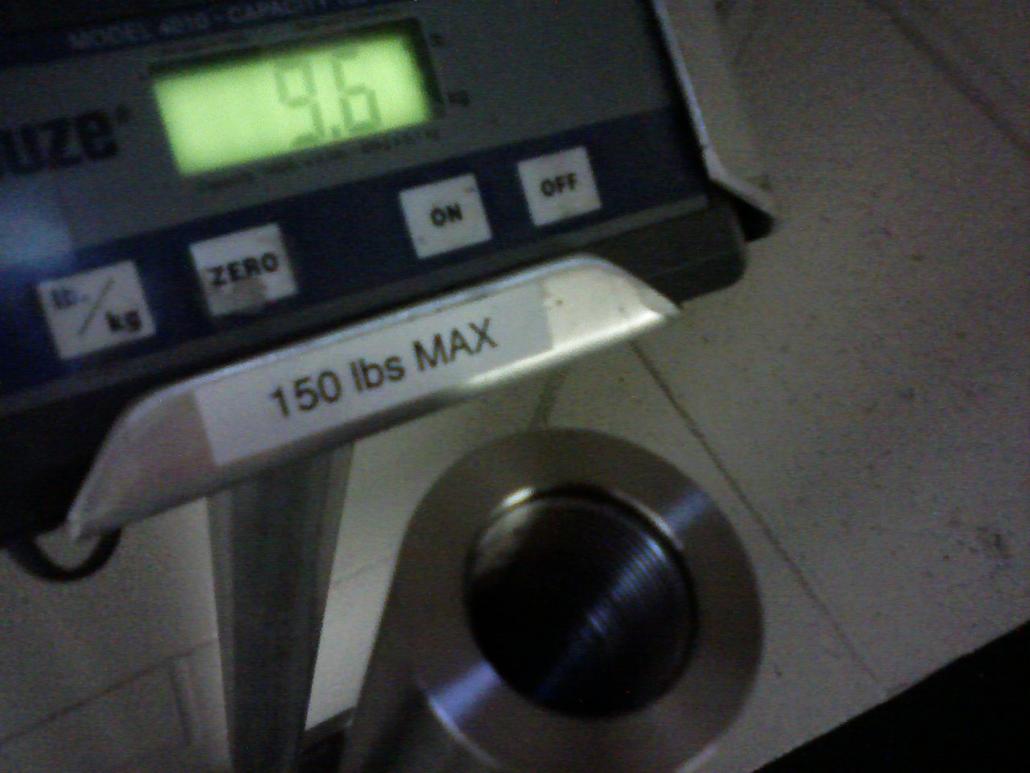

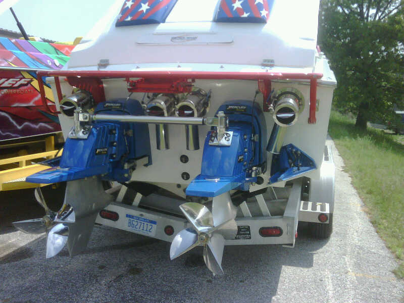

Speaking of tie bars,....here is the monster tie bar (Titanium)
weighing. ( 9.6 LBS ) after gundrilling the inside out. Weighed 15 LBS.
before drilling.
( Mitch's 38 cig with wetsump #6 conversion 1:62 gear ratio)
Torque multiplier,....lots of mid range acceleration
Jon
Attached Thumbnails Flatdeck with #6-mitch_joppich_01.jpg   Flatdeck with #6-0521101313.jpg

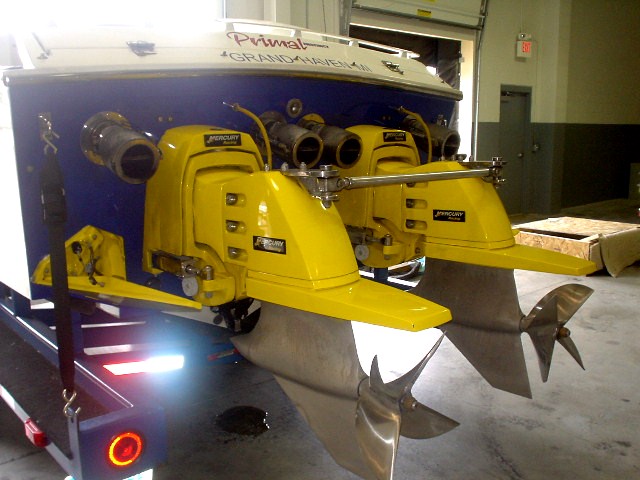

Few more pictures of Curts 38,.......posted by ( BLee ) in another thread.
Primal Instinct / Chief Engines
Jon

Curts boat running dry sump 6s also do you no what gear ratio

Mitch Joppich 38' 1.62 ratio WETsump
Curt Ganos 38' 1.62 ratio also,.........not sure if Curts is Wet or dry?
Dan Adams or Nautikitty would know for sure.
Nautkitty ( Parnell ) also ran the 1.62 in his 41' Saber
and Curt and Parnell ran together alot.
All these boats are maintained, wrenched on or stored at the same camp,
See a pattern with the gear ratio? It Works! Pretty tight group of enthusiast.
