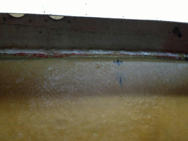

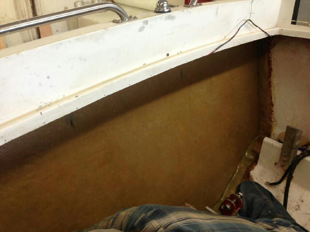

Well I have been movong along. the new transom is now done. this weekend I will reconnect the stringers to the transom , then I will finish the notch and begin the rerigg. Here are some pictures of the finished transom.
RG.[ATTACH=CONFIG]501238[/ATTACH][ATTACH=CONFIG]501239[/ATTACH][ATTACH=CONFIG]501240[/ATTACH][ATTACH=CONFIG]501241[/ATTACH]

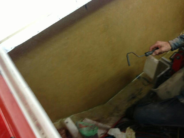

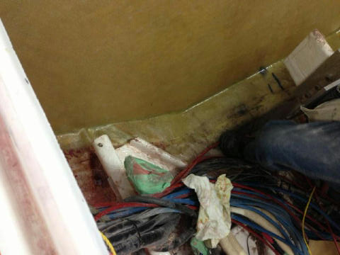

I worked on the stringer reconnect on the weekend . Here are a few pictures .
Rick G[/ATTACH][ATTACH=CONFIG]501455[/ATTACH][ATTACH=CONFIG]501454[/ATTACH][ATTACH=CONFIG]501456[/ATTACH]
