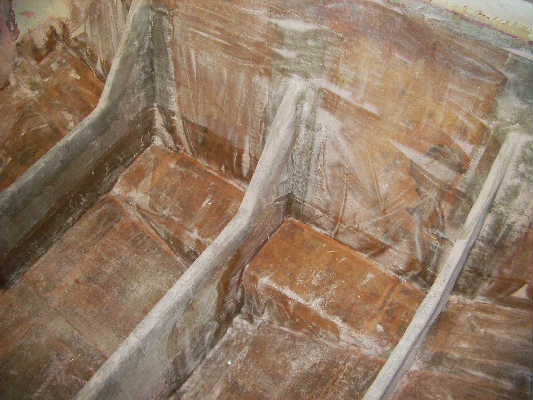

Well the heavy lifting is over . I have the notch roughed in and structurally complete . Now begins the finishing and final gelcoat application . End of the week it goes to my buddies marina where we are going to replace the transom ( need an extra pair of hands ) . Then we rerigg.
Here are a few shots of the roughed in notch.
RG.

Sorry its Monday.
Attached Thumbnails How to put a Notch in a Flat Deck-img-20130505-00204.jpg   How to put a Notch in a Flat Deck-img-20130505-00205.jpg   How to put a Notch in a Flat Deck-img-20130505-00206.jpg

Rick,
Looking Good, are you adding and Stringer Gussets?
Adds tons of transome support...
Jon

Absolutely . I need to redo the transom , that will happen the end of this week and then I can complete the stringer reinforcement.
RG.
