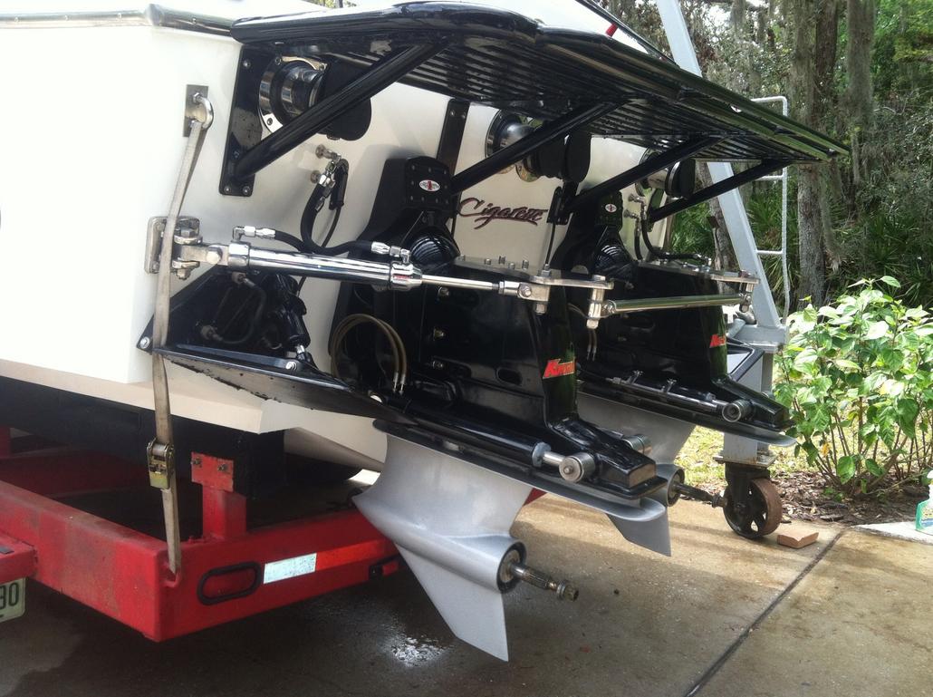

Just finished today, this Conversion, 86 Cafe, New Fast Forward 509, 550s, Konrads.

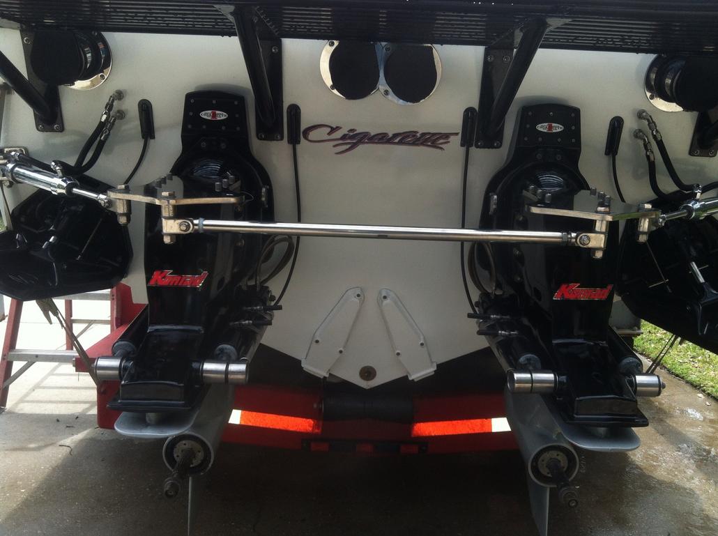

New Stainless Marine Gen 2s. Pro 1 Heads. Prop Testing On Monday.
