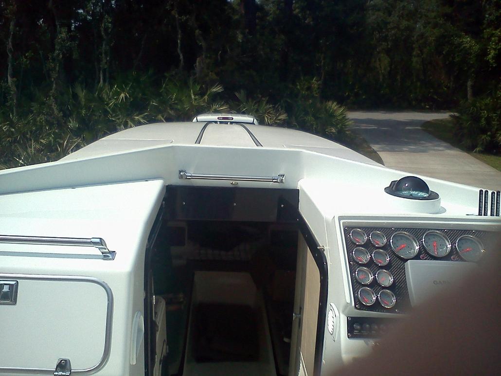

Have got some p5x 28s and bravo 1 28 s to try. Past experience says the Konrads like Herings in a 16 inch diameter and 20 degree rake. The owner is very pleased with the installation, and steering. He got a new dash also.

Sweet, looks like a similar setup. What HP and Props are you running. Your drives look like they are mounted deep like mine, factory setup? What steering and tie bar (mounting plate) do you have, is it re-used from your TRS setup?

Friends Boat, I work on it with him. TRS boat, so the Konrads are 1.74" higher than TRS. Steering Plates by Konrad to Mimic Marine Machine dimensions. The drives are removed from my Top Gun. New home on the Cafe. New 6a's on the Top Gun, New Chiefs. New Transom. Its all Fun.
