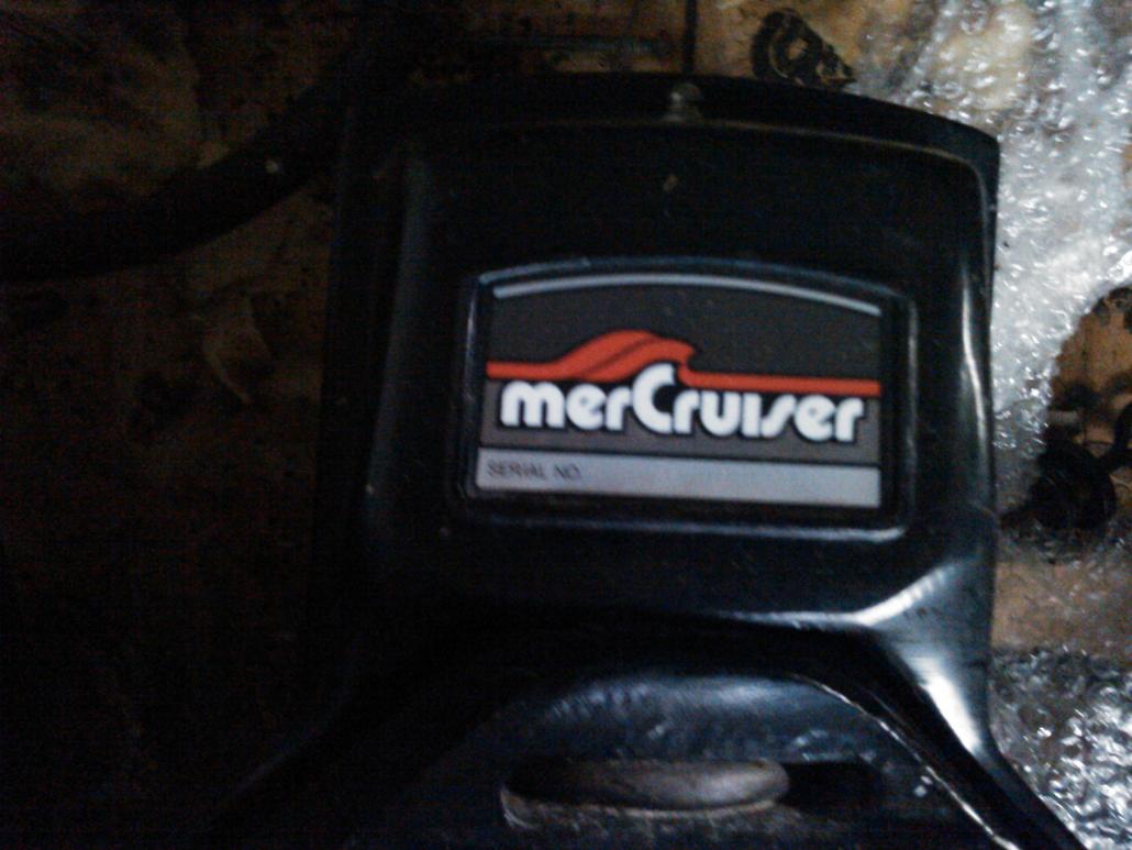

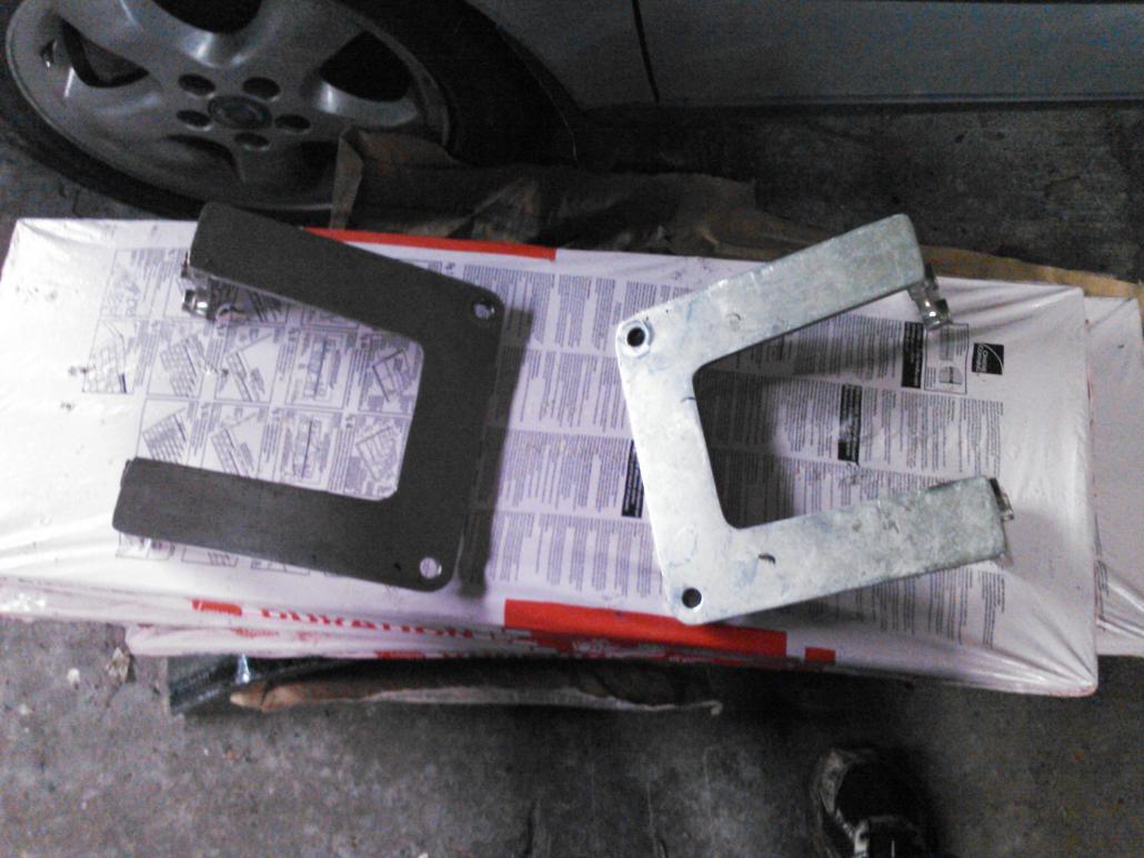

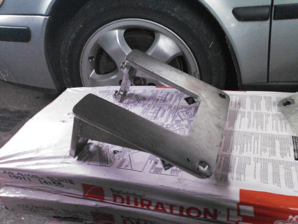

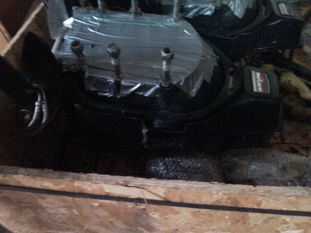

check your gimbles. the power assist will over ride the seized up pins and could crack your rings. ive got wingplates for trs if you wanna go hydraulic. i also have a pr of spotless trs gimbles and transom plates if you wanna put some clean ones on the boat

Old 03-25-2014 | 01:09 PM
Joined: Sep 2013
Posts: 1,653
Likes: 392
From: Syracuse Ny
what specifically would i be checking and looking for? thanks
315duramax is offline
Old 03-25-2014 | 01:15 PM
Joined: Mar 2008
Posts: 3,307
Likes: 40
From: lockport ny
your upper and lower pin. take your tie bar and steering off and more your drives side to side. also turn your wheel and see if it still binds. that will tell you what is bad
