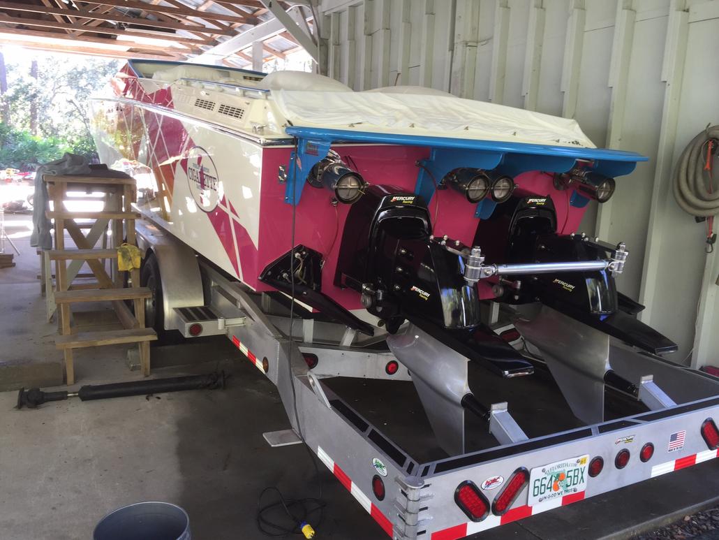

I went from TRS, to Konrads, to SSM dry sump Sixes. 800 Chiefs were the constant power. I broke; TRS, Konrads, and transmissions. The failures would happen while cruising at 3500, 50 mph. The TRS were 5.5 inches below bottom, Konrads 3.75 below bottom. 6A's 1 inch above bottom. Same power, 6A was 12 mph faster. Bam 1350 transmissions now. I don't run mine fast. 62-63 mph at 3500 cruise now, up and down the coast of Florida.
Do yourself a favor and listen the guys on this forum. They know what they are speaking of. Bravos XRs are a great product up to 500 hp. Iffy at 600 hp, after that keep a spare in the bow. The Bravos on 800 plus hp are good if you idle.
I am now in the process of converting a #5 drive, staggered, 90 mph edition boat, to 6A SSM on extension boxes

For now I have to stick with the bravos money wise. I guess the best way to go would be to put surface drives on . The motors have 70 hours on them since rebuilt and never broke a drive. I guess is it how you drive it the main question is will 2" shorty help with more top speed. The drive now are 5 1/2 deep
