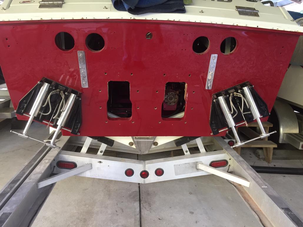

Originally Posted by CIG3
ZERO,
Which 90MPH did you pick up. I would love to do one of them someday.
Not mine, Mr. Picketts. Lock and Load, #4 of the 5. It lives here with mine.
We have the transom recut and the drives at paint. Waiting on driveshaft fabrication.
Zero Patience is offline

Hey Zero , do know what Mr. Picketts is dong with the hardare he is removing from the boat ?
On another note is the X dimension the same with the 6's as it was with the 5's ?
Rick G.
Rick G is offline
Old 02-05-2015 | 07:31 PM
  #36
Zero Patience's Avatar
Posts: 1,596
Likes: 12
From: Crystal River Fl,USA
The boxes, #5 drives, steering, all went to someone in Michigan. The x was a pain in the ass. The 6a,s are longer than #5s. We had to use 12 " ext. boxes on the sixes to get the driveline to connect, or you move engines, buy new tailpipes again, fight hatch issues, etc. The sixes will be 12 " back farther than the 5s on boxes. So the height has to come up. Without exceeding max drive shaft angle. It took a little time to mock up, and some advise from John Pompi ( marine performance), and Chief Performance (Tommy), to arrive at a template location. We then drilled and recut it, filled all the old steering holes, #5 holes, airfiled it, and repainted. Then reassembled the six boxes and measured for new driveshafts. They are being built now.
