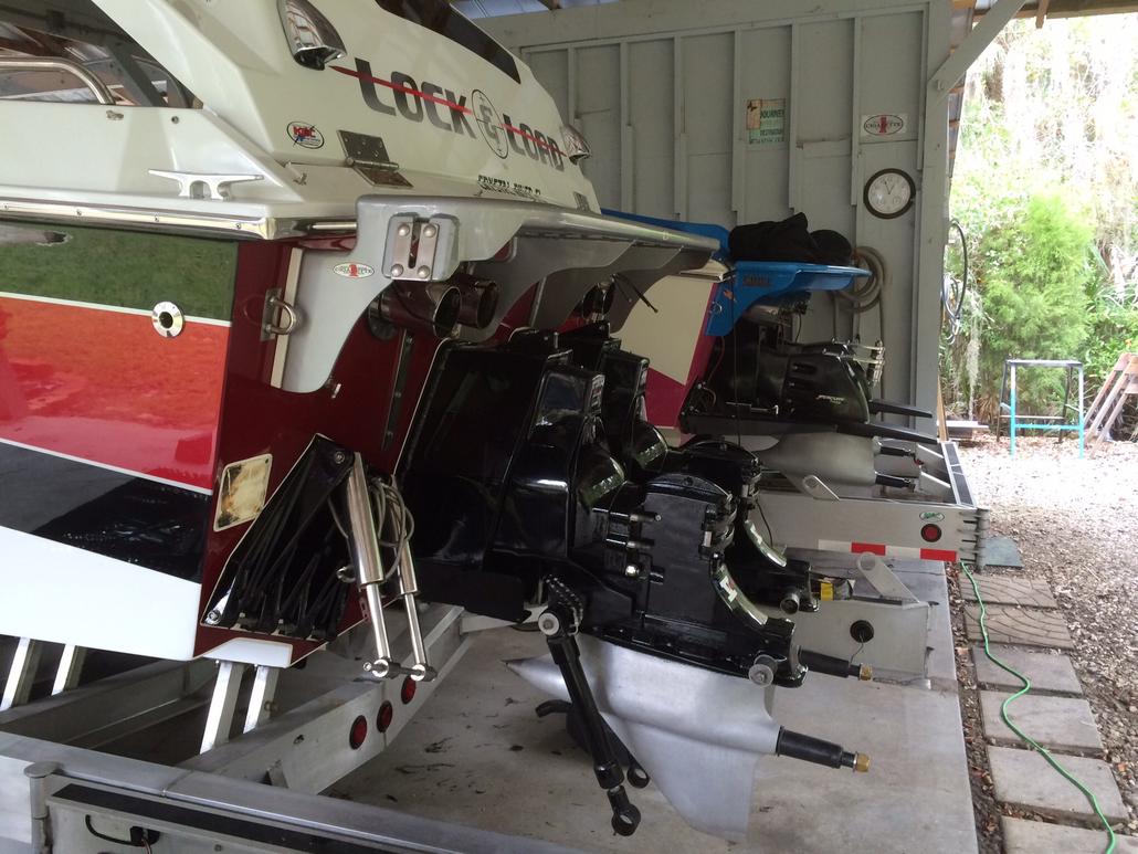

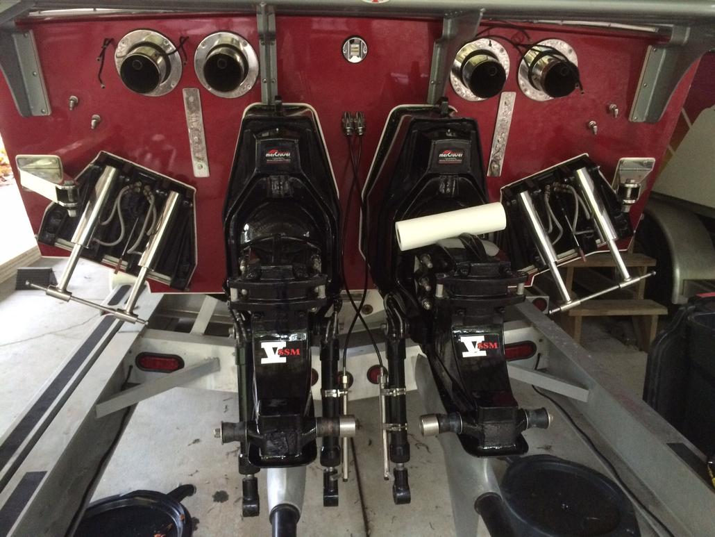

Lock & Load was built with SSM V drives. While perfectly functional, the 5's ate lots of HP on its way to the props and looked like a young Forrest Gump (with all that hardware) compared to the sleek appearance of the Six drives on Zero Patience.

In almost every transaction, a trusted broker makes all the difference. I was fortunate to have Craig Colabella, THE MAN, when it comes to Mercury SSM out drives agree to broker our transaction. Specifically, Craig inspected and assured me that the drives I was buying were "all there". The removal of the 5's got started right away. Having ZP's Six drives parked next to me was a constant inspiration.

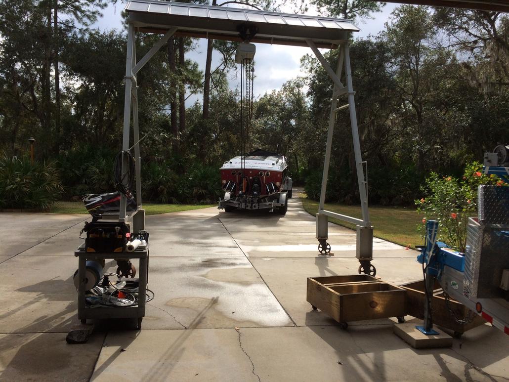

Drives came off easily with the overhead crane. Extension boxes were quite a bit tougher and knuckles were sacrificed, but they were soon ready to go.

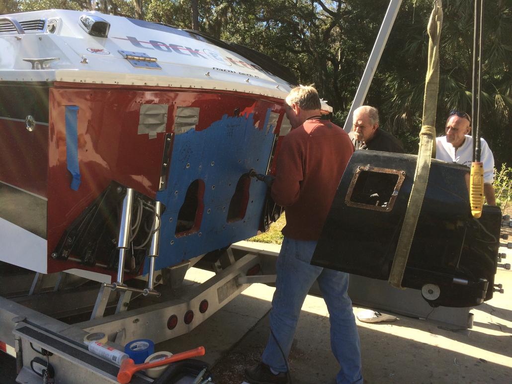

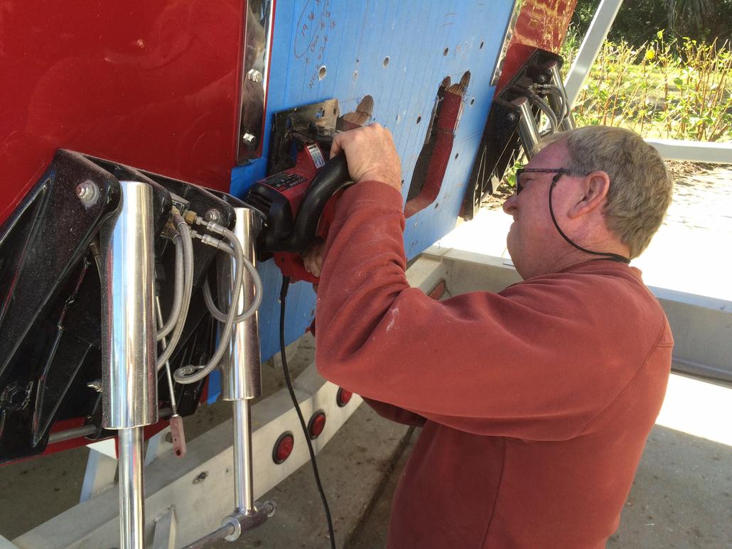

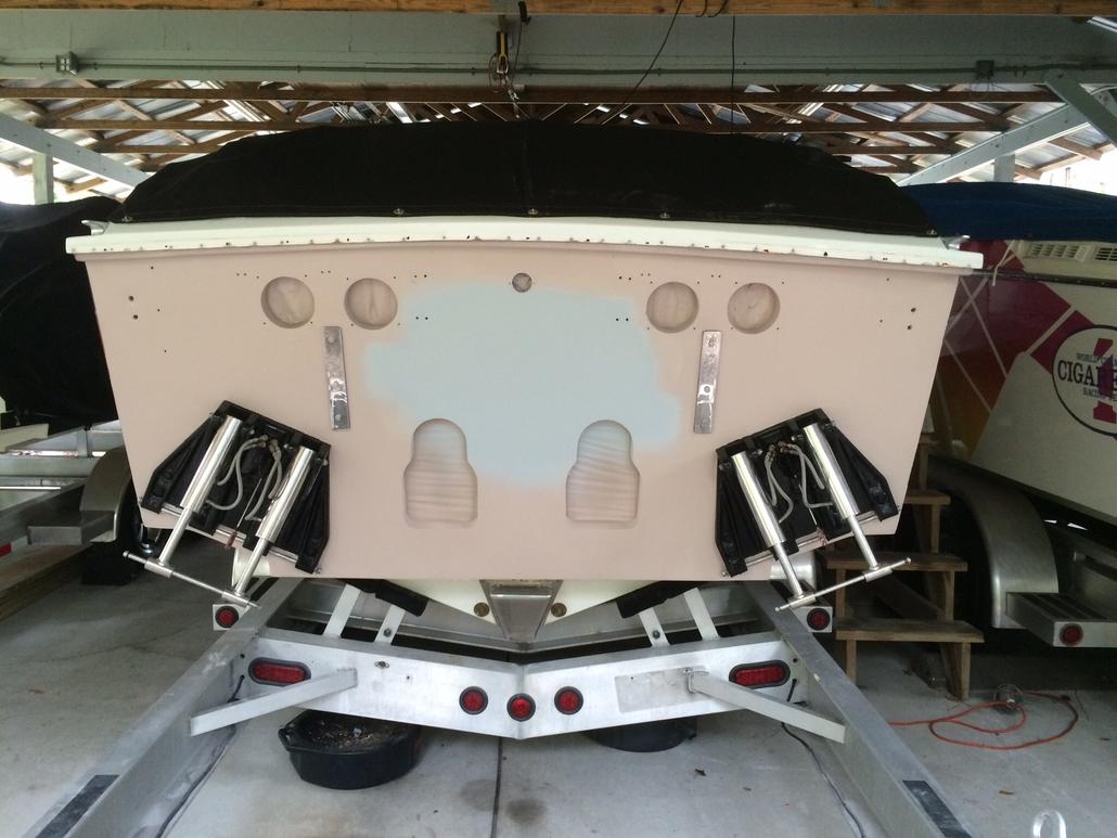

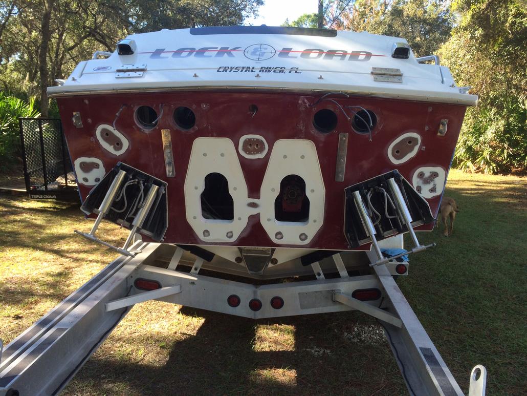

In a Five to Six transformation, we wanted to keep the engine in its original location. This was opposite the usual method of new mounts, rebuilt tail pipes and hatch modifications that are generally required. With input and advice from Tommy Hofstetter at Chief Performance and John Pompei at Marine Performance, it was determined that Sixes on 12" extension boxes would give us the necessary X dimension and stay within required driveshaft angle limits. After all the geometry homework and with the help of Cigarette brother First Gun, the transom modification began. He filled all the holes for the external steering that wouldn't be needed as well as the mounting holes for the 5's.

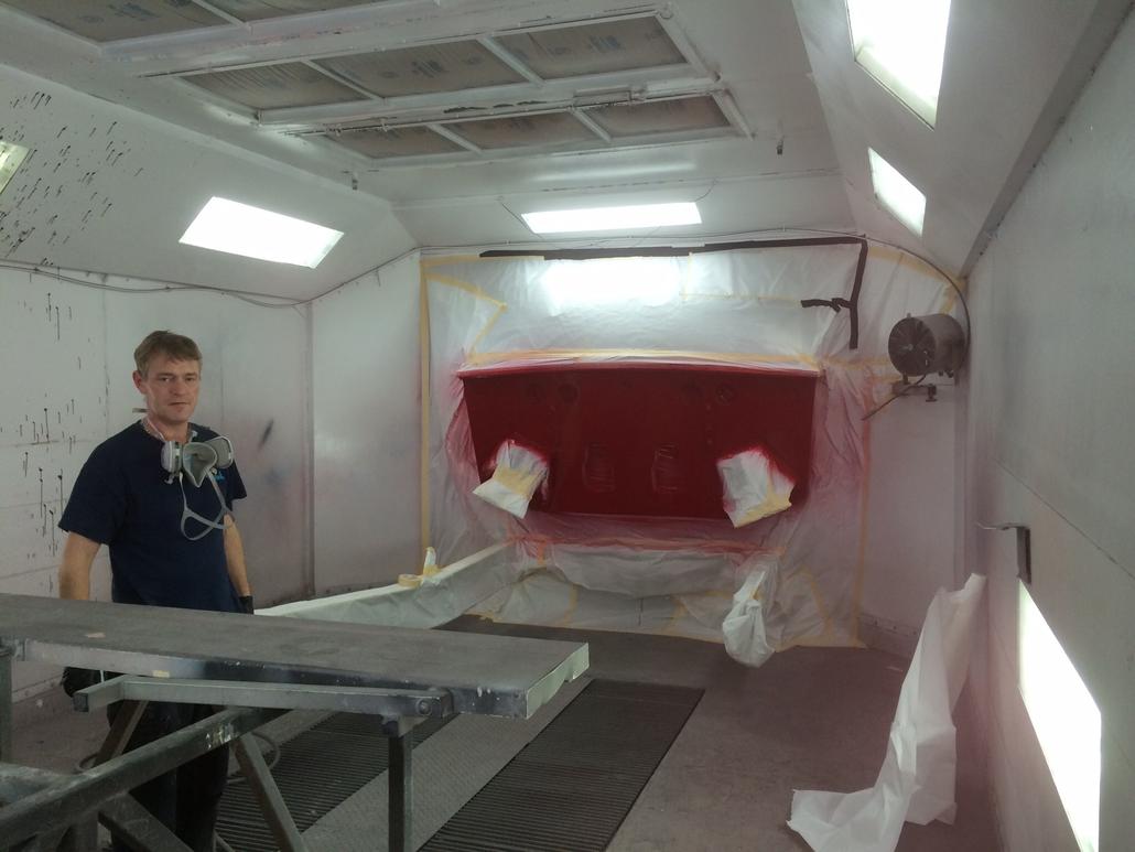

Next it was off to paint to get the "blank canvas" ready to redrill the mounting holes.

The next step in the transformation was to mount the template for the six drives, drill new mounting holes and enlarge the drive cut out. Mods completed, First Gun glassed everything up and renovated the inner transom by filling holes and reapplying white Awl-Grip.
