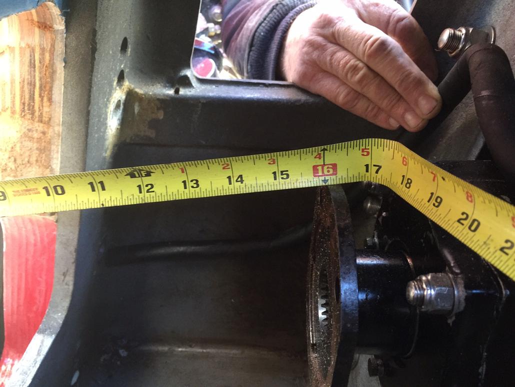

...meanwhile, back to our story. The decision to go with extension boxes for the Six drives meant néw driveshafts. Our man Colabella recommended a driveshaft builder in Orlando, so we measured everything and placed our order. ZP made sure the drive angles were within specs and all the bolt patterns were correct.

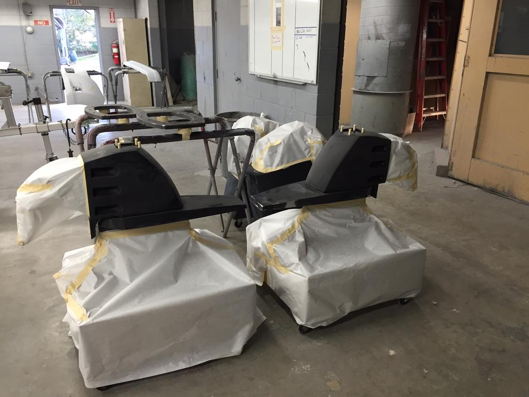

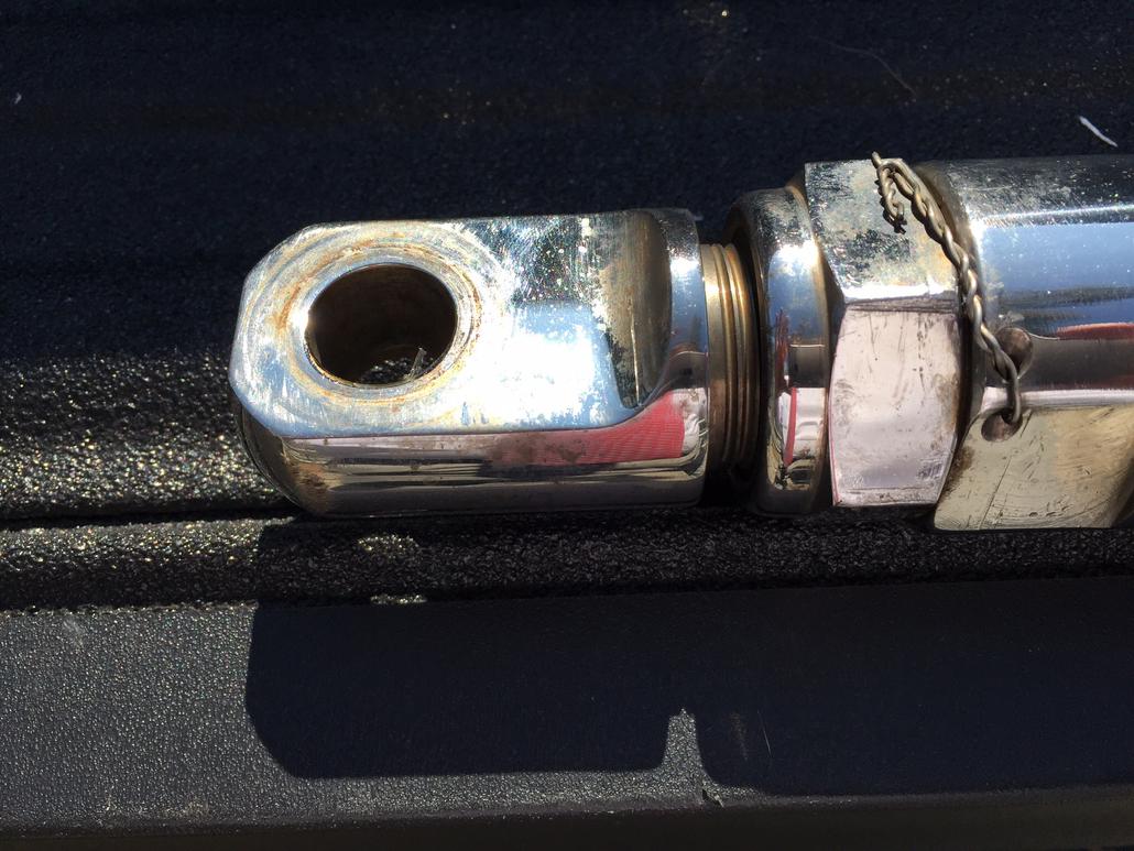

While the boat was "in paint" we worked on the Six hardware. Lots of refinishing.

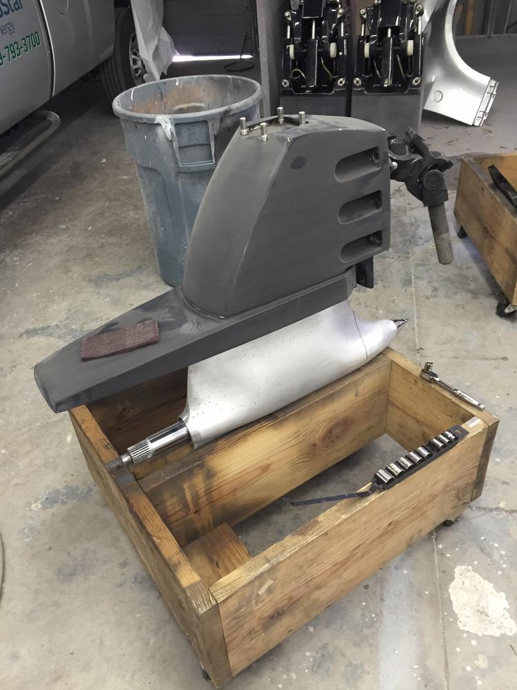

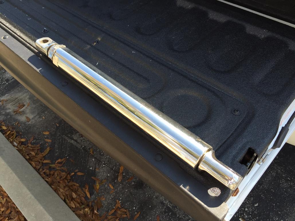

The Sixes we traded for came with MASSIVE tie bar set up. As Lock & Load is a stagger set up, the bar was way too long. ZP arranged to have it cut down and machined to our specs.

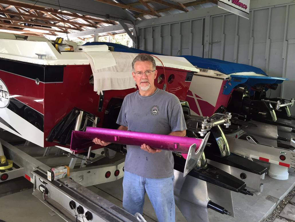

Sixes on boxes are LONG. I decided to modify the swim platform while we were updating everything else at the stern. Our local aluminum builder fabricated a platform frame mod with a new top plate and our artist Chris designed art to tie in with his overall paint design.

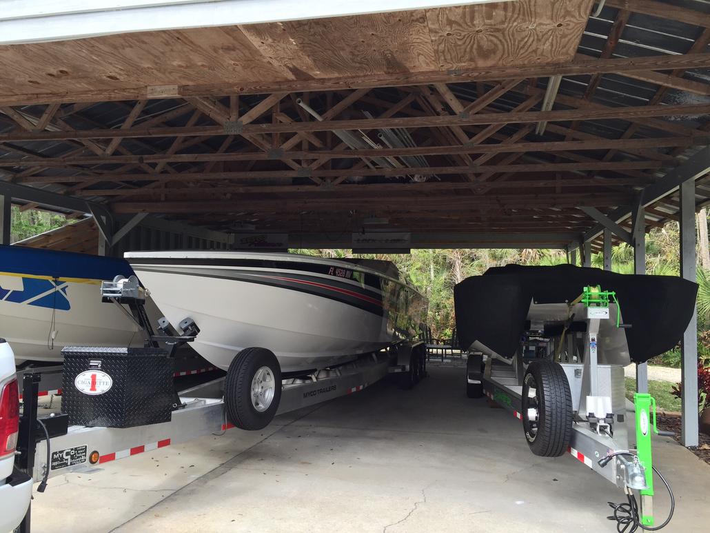

With beautiful new clear coat and foredeck logo, the boat came back to the ZP boat house, ready for some new drives!!

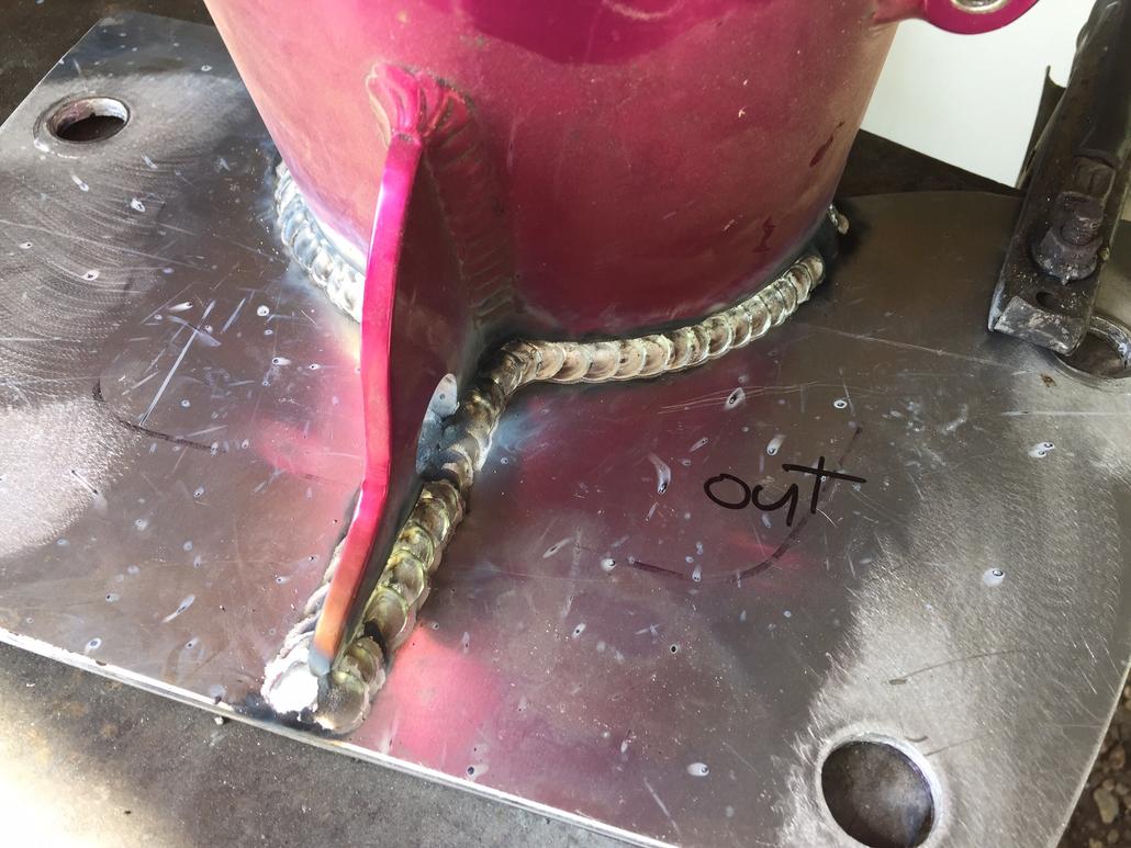

The inner transom brackets on the Sixes are much beefier (thicker) than the number Five hardware we removed. That required modification of the driveshaft covers. Old ends were removed, new pieces fabricated in cardboard and test fitted. Once ZP was happy with "the fit", aluminum was cut, fitted and welded.
