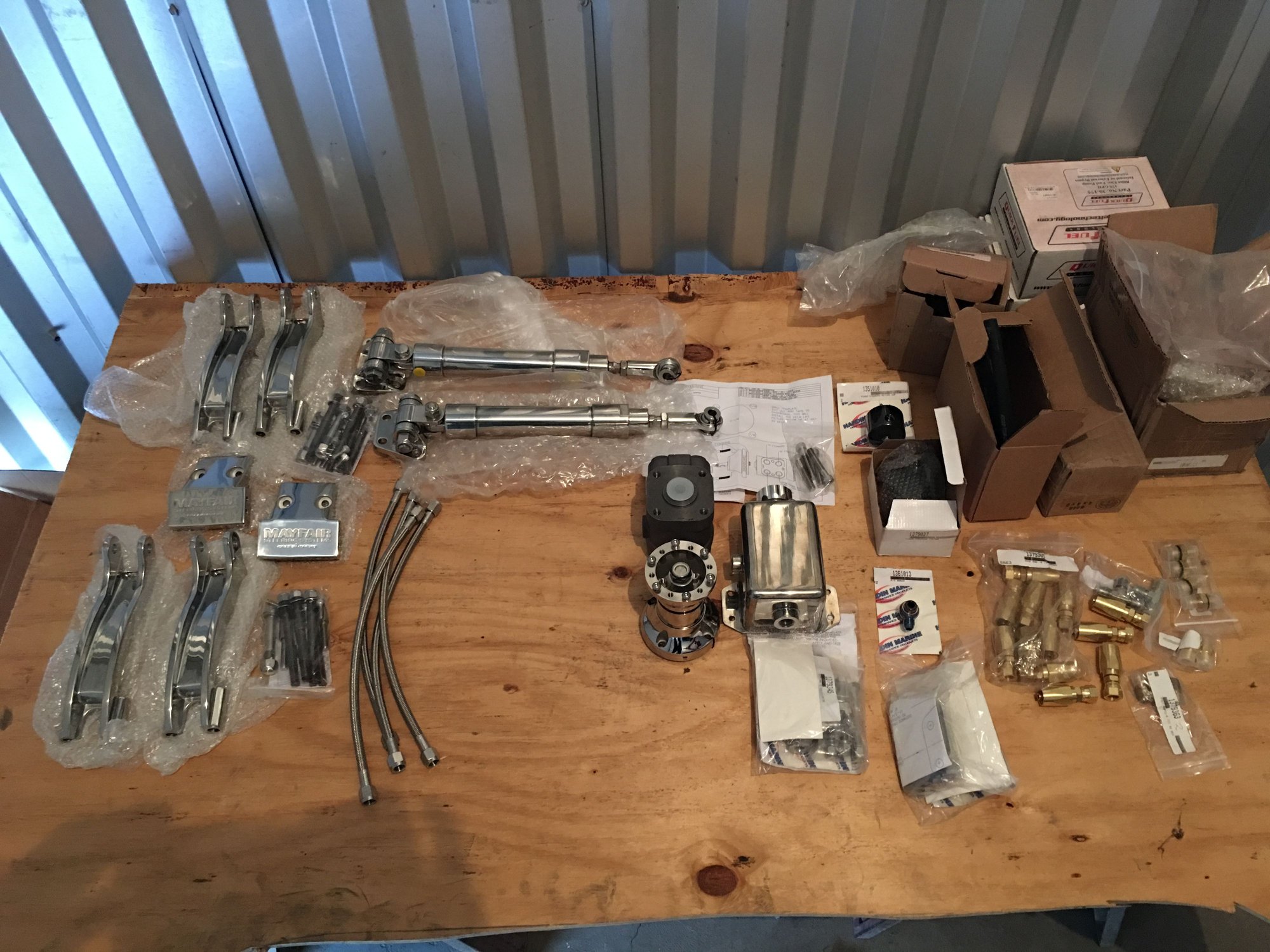

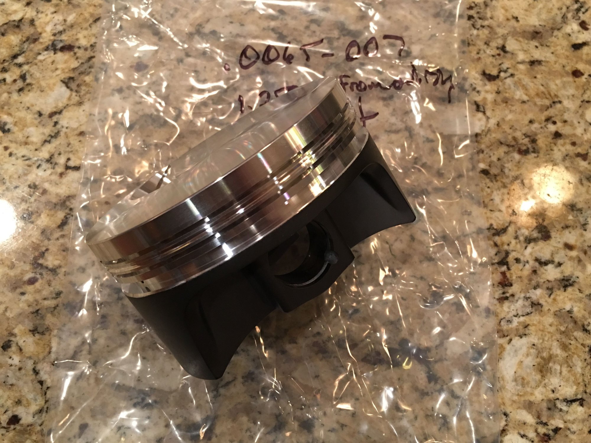

All Kinds of fun last night my upholstery guy is just about done!! I got started on my new steering and when I got home my pistons I've been waiting for showed up went with a Diamond lightweight narrow pin 4.600 now I can finish my blocks, balance and start assembly next week!!

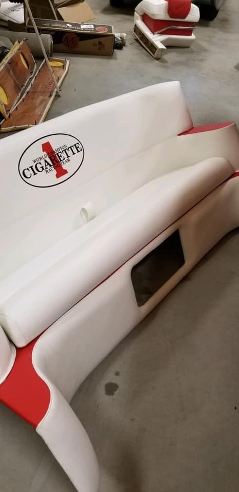

Just picked up the seats, he did a great job and very reasonable in my opinion, unfortunately I will not be installing the interior till steering stereo and engines are done...

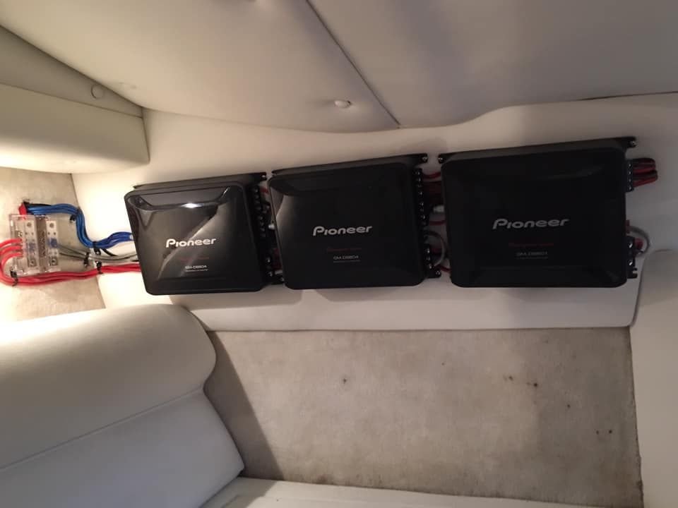

I haven't posted much its been a busy month and going to get real busy quick, Havasu trip is coming fast!!
My amps are wired in I decided to mount them in the cabin on the port wall...

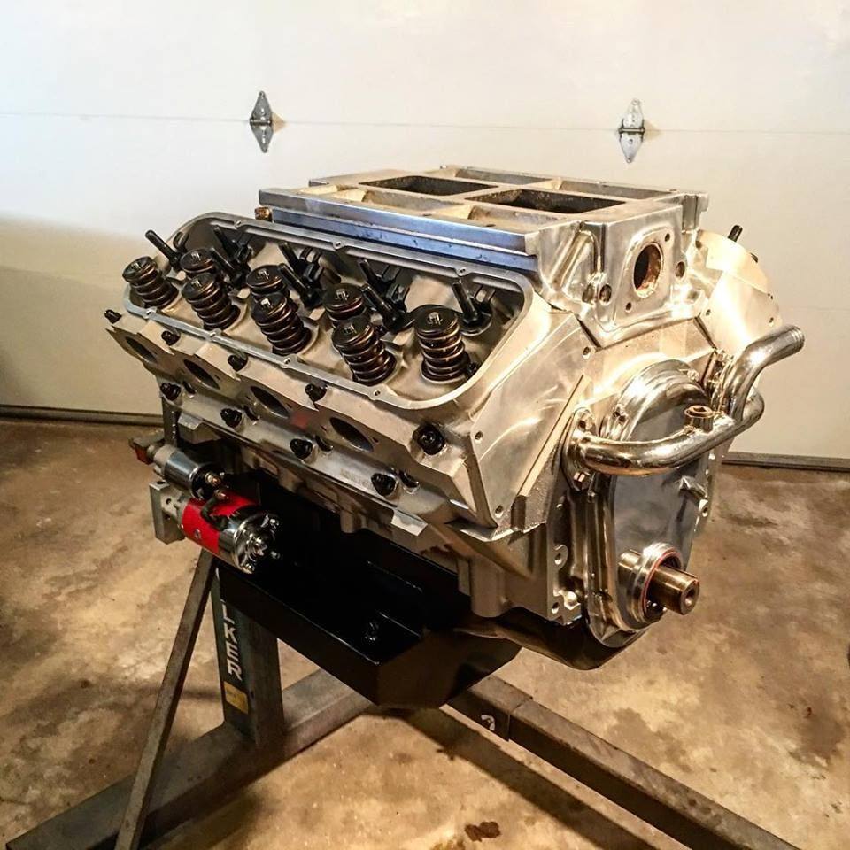

One Engine I just about have finished, I would have finished it this weekend but needed to get correct length pushrods, I knew they would change with these heads but wasn't sure the exact length till I assembled it, I should have both engines done next week and time to get the old girl back together

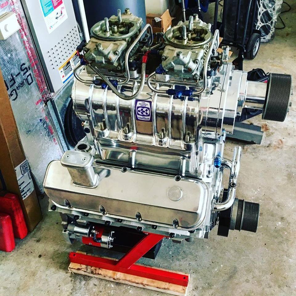

One done, I should be putting these in next weekend

Looks good, if that's an MSD starter ? if it is be sure to check the ring gear engagement, friend has one eating the teeth off, I highly recommend spinning it over before it goes in.
