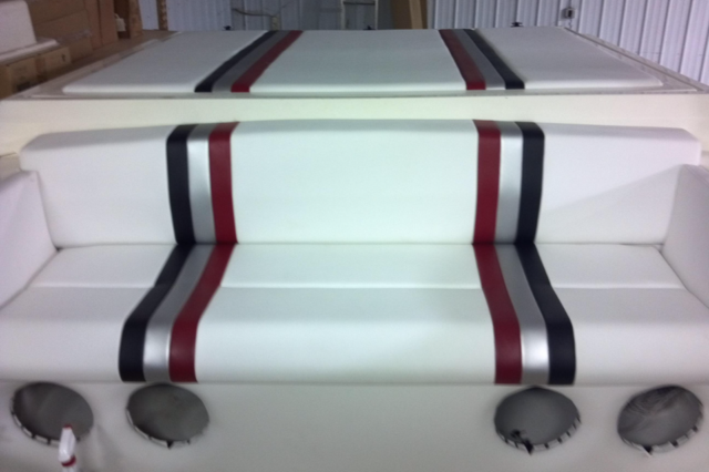

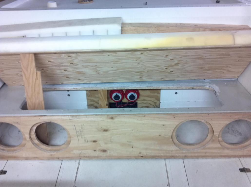

4 JL 10" unders rear bench, seat was custom made for a big stereo and the face is 2.5" thick with wood and glass, that makes the subs really sound good and something most guys do not do and let them vibrate too much.

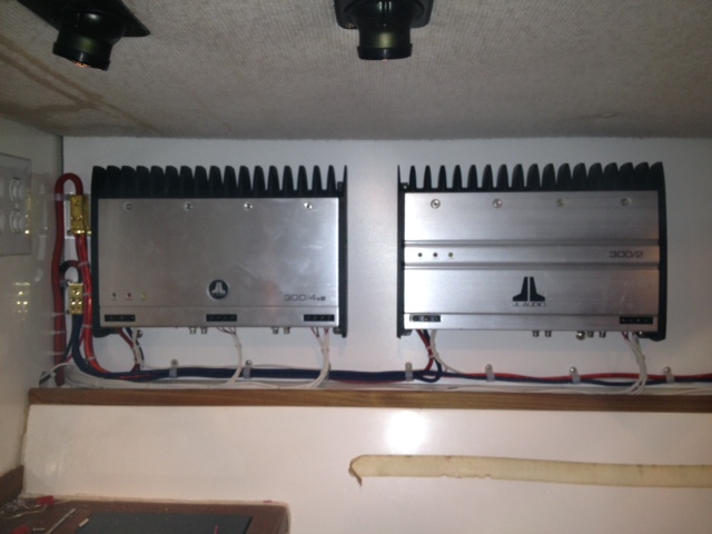

Amps are in cabin above bench seat since I have AC it helps to keep amps cooler, I am not a fan of hiding amps they need air..
Stereo is another place to not get cheap stuff especially amps, buy good part they sound great, cheap stuff will overheat and sound like crap..
[ATTACH=CONFIG]546481[/ATTACH][ATTACH=CONFIG]546482[/ATTACH][ATTACH=CONFIG]546483[/ATTACH][ATTACH=CONFIG]546484[/ATTACH][ATTACH=CONFIG]546485[/ATTACH]
