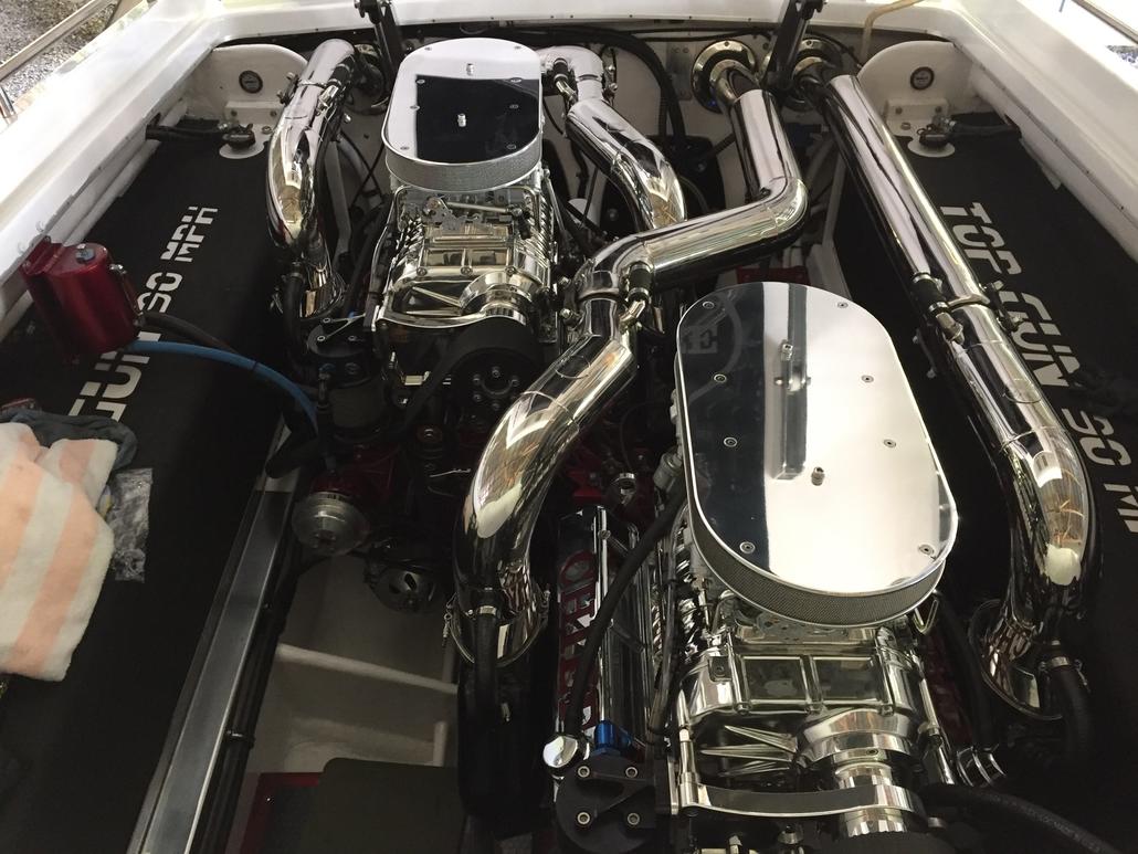

The saddle tanks create a very tight space to work in. Lots of creative climbing down there required to keep it clean.

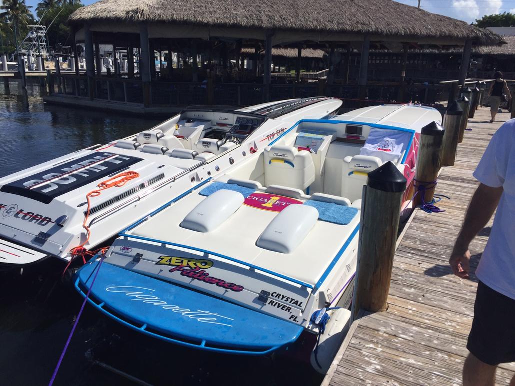

Originally Posted by bookshelf
Yours and MrPickett's staggered gun is a great comparison since both have big power and #6's. Do both handle and fly essentially the same?
They both sit about the same in the water, mine docks easier, I am more comfortable in mine because the bolsters are 5" farther back, which allows me to be lower in the boat. The short cockpit in Lock and Load dictate where the bolsters mount. They fly about the same as far as I can tell, and the handling is not noticeable to me. We have kinda tested that on the yearly around Key West run we do in the afternoons during race week. (A complete 360 circle around Key West, with some 2-3 g turns). The staggered drives are high, but still lower on the hull, so it has more grounding issues, he used to run aground a lot, even when following me. He does not run aground any more. my slip is 5-6 % less, than the stagger, so I cruise 62 -3500, at about 300 rpm less than the stagger. We have tested all props, 4,5, and 6 blades, diameters, rakes, etc. L&L is faster at top end now, twin 875s vs twin 1150s. L&Ls slip comes down as the speed increases. L&L would be faster, if his wife was not on board.
It is very cool to be able to run both types of setups all over like we do.

Old 05-27-2016 | 06:57 AM
  #45
Joined: Jul 2008
Posts: 377
From: ny
Worked on a friends boat with staggered and was mother*ucking the pipes from the port motor while changing plugs and wires on the starboard motor. It also doesn't help being 6'3" tall lol
