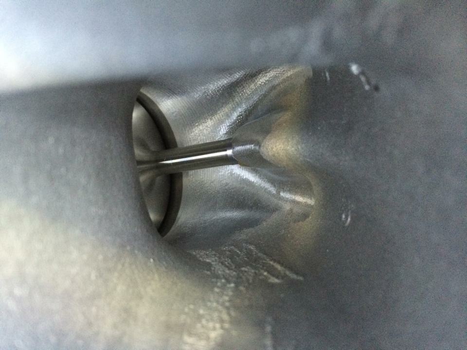

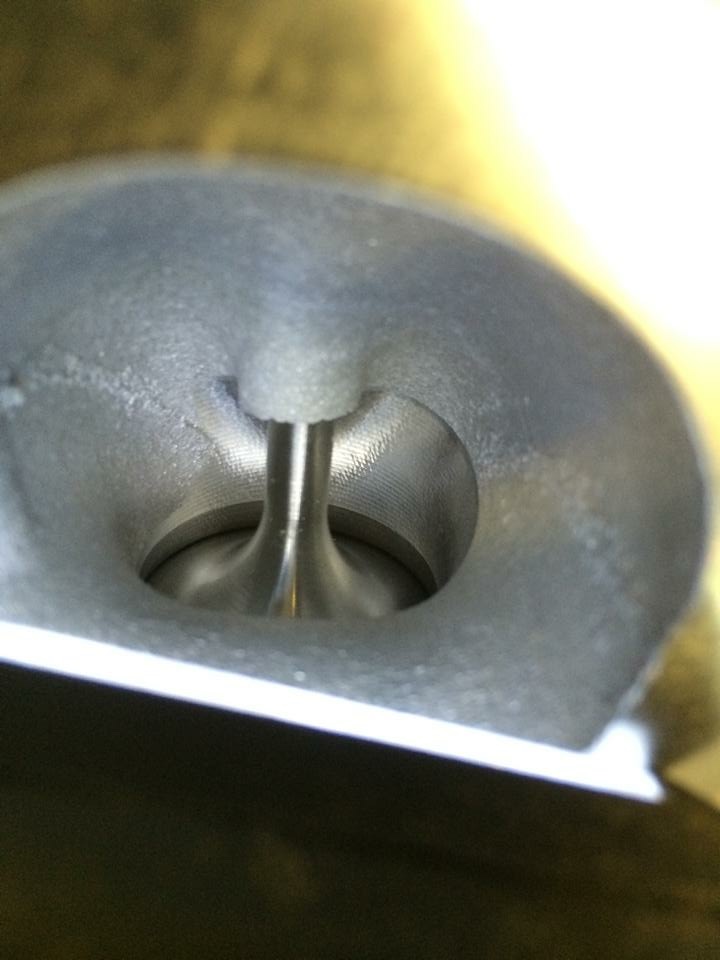

[ATTACH=CONFIG]561966[/ATTACH][ATTACH=CONFIG]561967[/ATTACH][ATTACH=CONFIG]561968[/ATTACH][ATTACH=CONFIG]561969[/ATTACH][ATTACH=CONFIG]561970[/ATTACH]

update as of now...
Cam motion says cams are fine, the marks would not have gotten worse, and some guys say they have seem much worse with no issues, that being said cams still being changed as out of 5 cam companies we have talked to all but one said 241/246 is too small for a 540 to see 6000 rpm especially in a heavy bot like mine..
heads are ported and flowed, looking at cams now, not releasing them details at the moment at least until it is decided, if at all..
lidters will be short trave HR, every cam company said thats the way to go with HR these days, or go solid... but I am not going solid.
intakes cleaned up and portmatched to heads, compression getting bumped to 9.7
