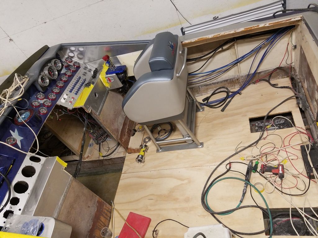

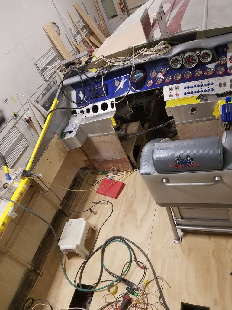

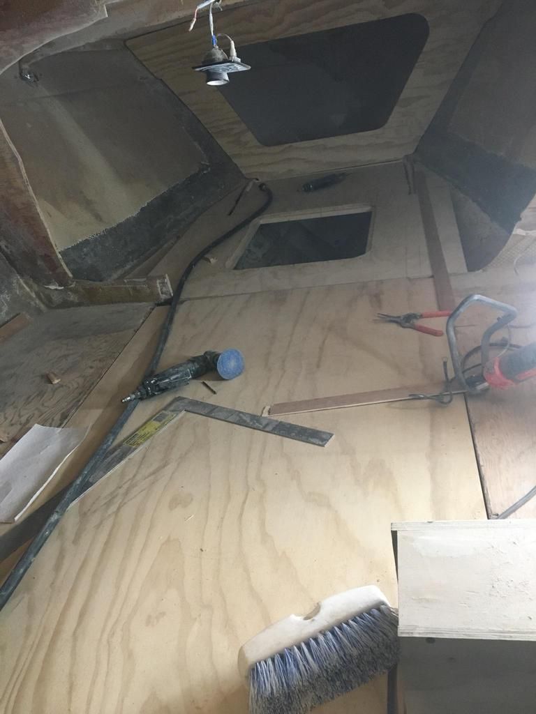

Cockpit floor roughed in, 1/2 of the rigging moved over . Bulkhead cutout for new cabin door, cabin interior structure getting built. Batteries getting a new home.
[IMG][/IMG][IMG][/IMG]
[IMG][/IMG]

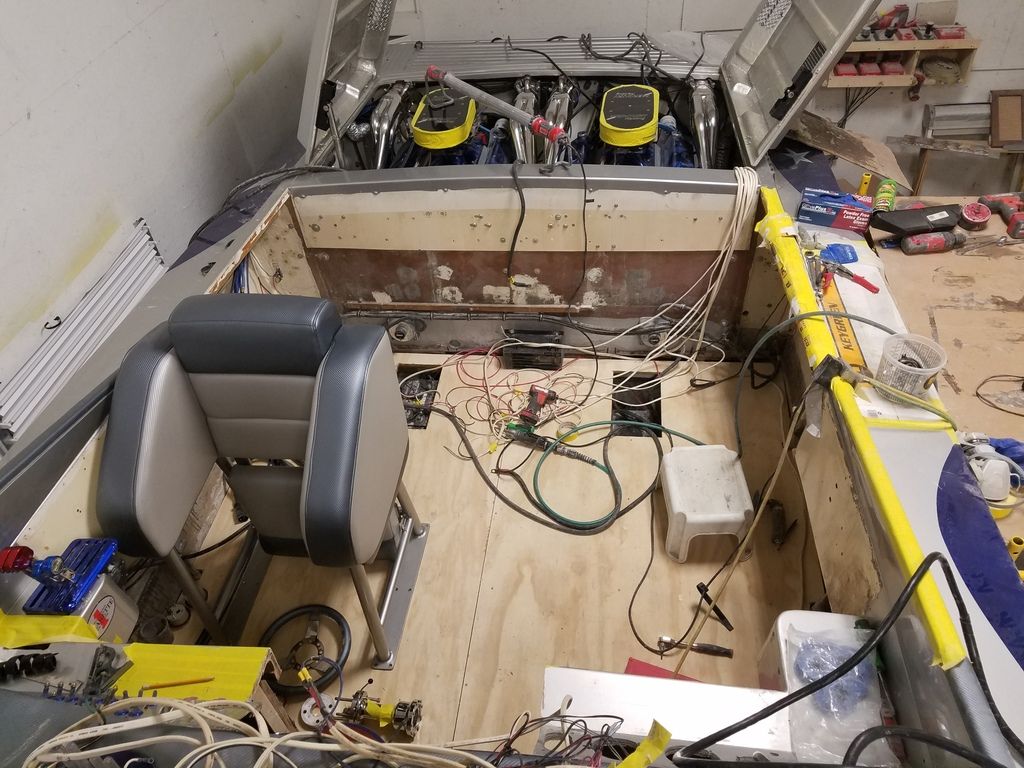

[IMG][/IMG]
