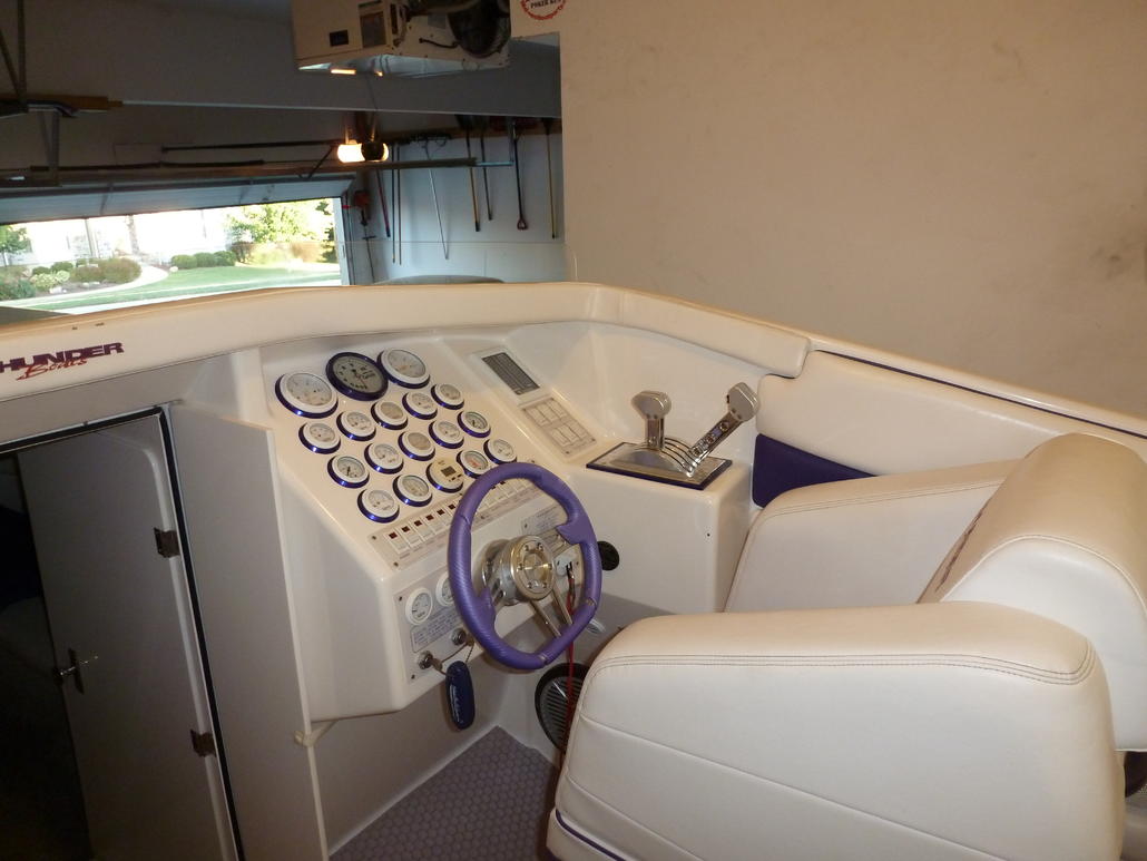

Originally Posted by class6
If the helm is long enough, you can use angled plates inside and out, enlarge the hole and possibly need longer bolts. Without grinding any glass.
That is basically what was done on my 32 AT. No brand name on the piece.
Ok, so theoretically parts do exist to achieve this, correct?
It did in 1997 when my boat was built. The outside part is nice billet piece. The backside has some wedge plates.
