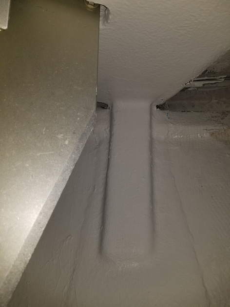

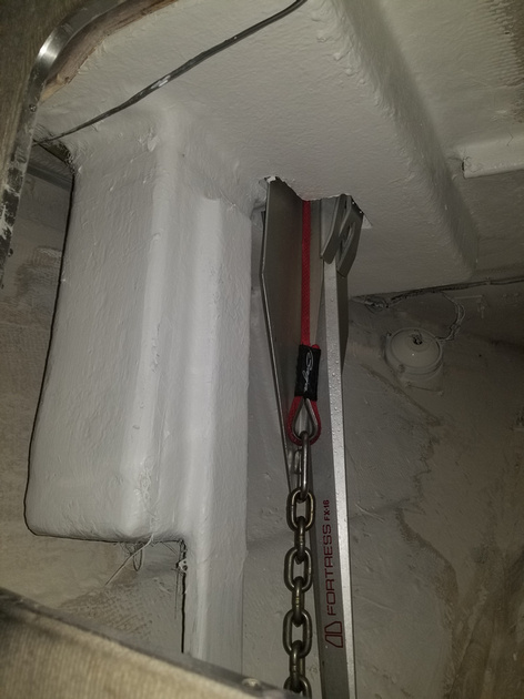

I wanted my fiberglass guy to make a mold of the anchor holder (probably still could) but in the end they just covered my wood creation with fiberglass.
Attachment 571311
Then fiberglassed and gelled everything in from the inside and out . I`m putting a gasket around the whole thing , if any water gets in it just gets drained back to the bilge.
I was concerned about the thing coming down in rough water so I had em make some supports on the inside..
Attachment 571312
Attachment 571313
...and I left when they were cutting the hole in the boat I couldn`t watch :noevil:
