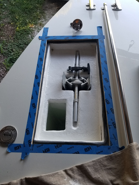

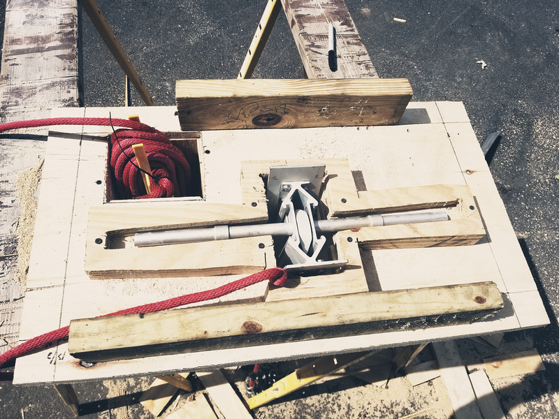

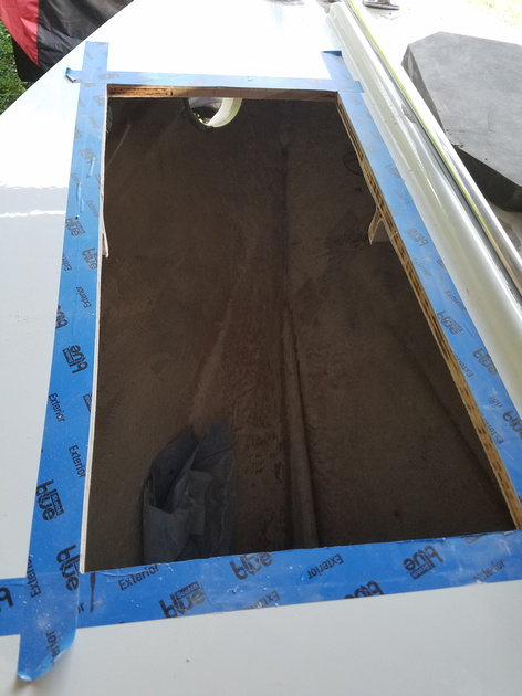

We anchor A LOT.
This should have been a factory option IMOP. Getting people to move to get under the rear bench, dragging it up and down the sides/bow. Draging mud into the boat .. I got tired of that noise.
Attachment 571298
Attachment 571299
Attachment 571300
First attempt
Attachment 571301
Attachment 571302
Attachment 571303
Attachment 571304

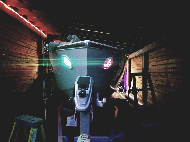

ICDEDPPL 10-06-2017 10:56 AM
1 Attachment(s)
While I was in there made use of the useless docking lights , now they`re navigation lights.
Attachment 571305
F-2 Speedy 10-06-2017 11:24 AM
nice job on both..........:champs:......man I'd of been all puckered up cutting a big Azz hole in my boat....lol
Padraig 10-06-2017 11:57 AM
Very nice and I like how you secure the anchor.
Padraig
MullenTJ86 10-06-2017 12:19 PM
Wow! What a great idea and looks awesome. Beats the old lifejacket and shirts I wrap around mine and store in the fwd anchor locker.
frickstyle 10-06-2017 01:23 PM
Love it, very tempted to do this....
thisistank 10-06-2017 02:40 PM
That's bad azz! Nice work.
Have you run the boat yet?
Id just be concerned about the weight way up at the bow. I stored our anchor in the bow storage once, noticeable ride difference with the weight of the chain and anchor that far forward. Went back to storing it under the rear seat.

I doubt its noticeable, I have a 20 or 30 gallon water tank up front, boat rides the same either way I cannot ell difference from empty to full.
