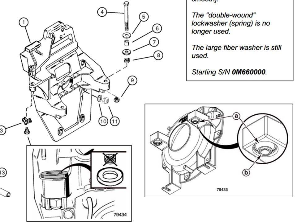

Does anyone know the order these going ? Been a long time since it has had an engine in it. I do not recall the order. I thought the felt washer went in between the tail house and inner transom plate but I do not think so mabye one there and one up top ? Trying to get alignment right

It depends which bell housing you have but there is a bulletin but unable to upload because it's 4.9MB pdf
The page indicates wound washer is not used if bell housing is as pictured and serial number is above 0M660000
thats bravo not Trs

Yes this was a trs set up. The boat has the Konrad conversion but still uses the trs inner transom plate and hardware

Middle picture in post 1320 is correct. The large washer sits on top of the felt washers and the tail stock on top of that the the smaller washer goes on top of the tail stock and the blot through that . Hope that helps. Rick G .

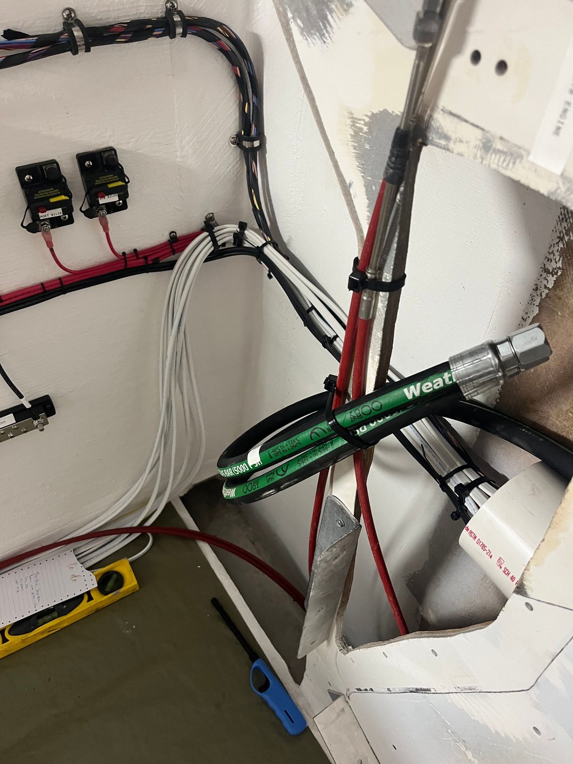

Update .bilge is rigged with all the small stuff trim pumps , bilge pumps , all new trim lines , harnesses ect. I did all that ran all the new trim lines and was able to do a system test on all of it before putting engines in to test for leaks and such. Ran all new steering lines ,engine harness. I ran all the new power and battery cables and labeled it all been a real process lol. Getting there

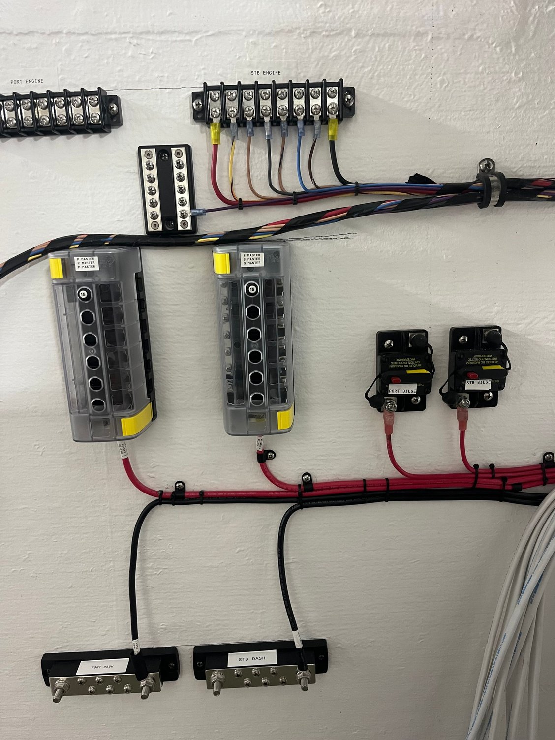

All new power runs
Used stringer washers on all rigging
Starting to assemble helm wiring
This my not look like a lot but I can tell you it took about 15 hours and I’m only 1/4 way done lol

Looks freakin fantastic!!
