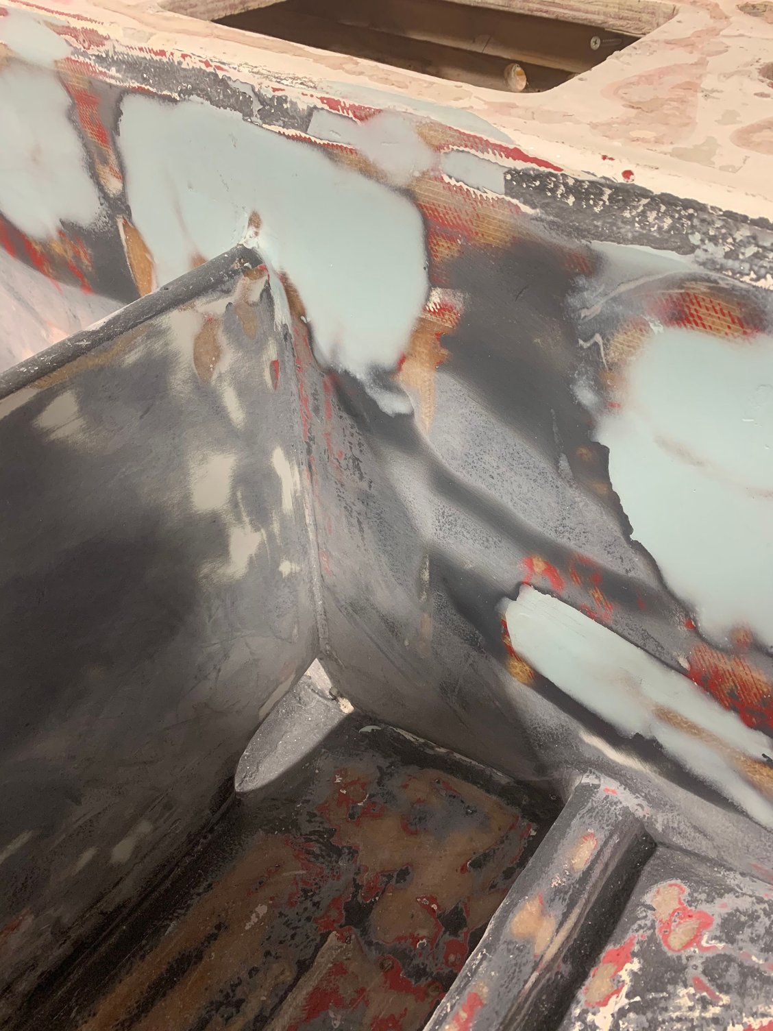

Yes I have heard the darker colors make it harder. Got the drain holes drilled and glasses almost ready for final coat. Tanks are being made moving along . It liquid foam still the way to go under and around tanks or is there a better solution know a days ?

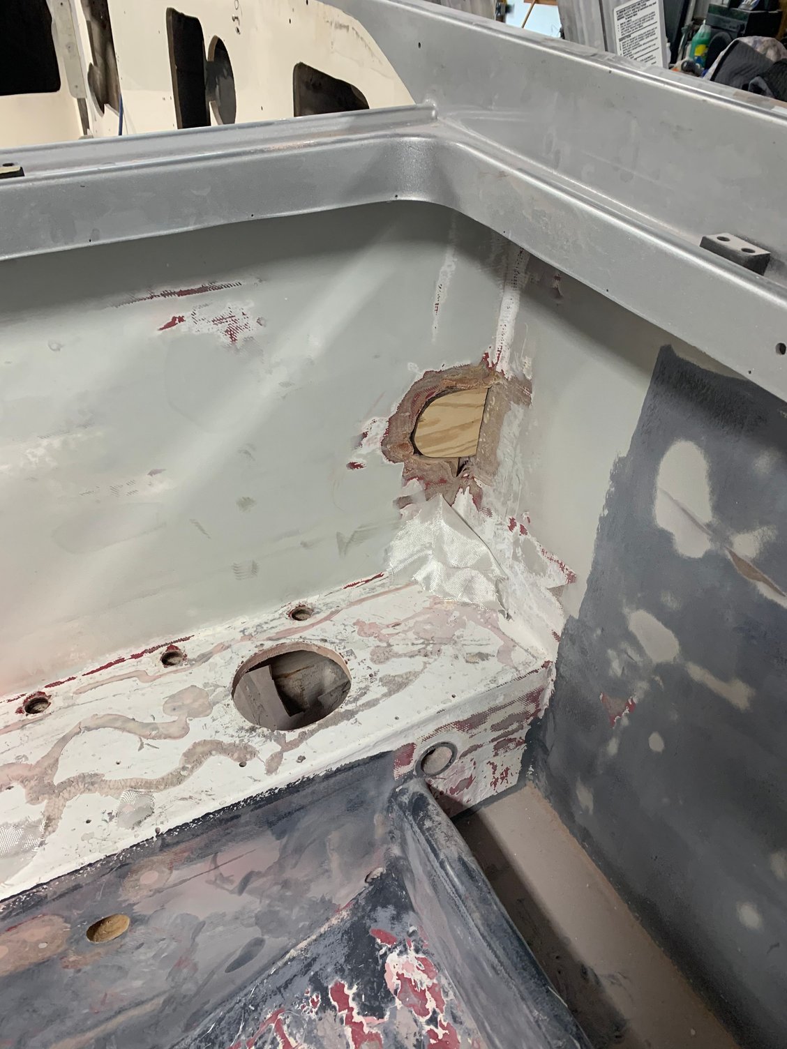

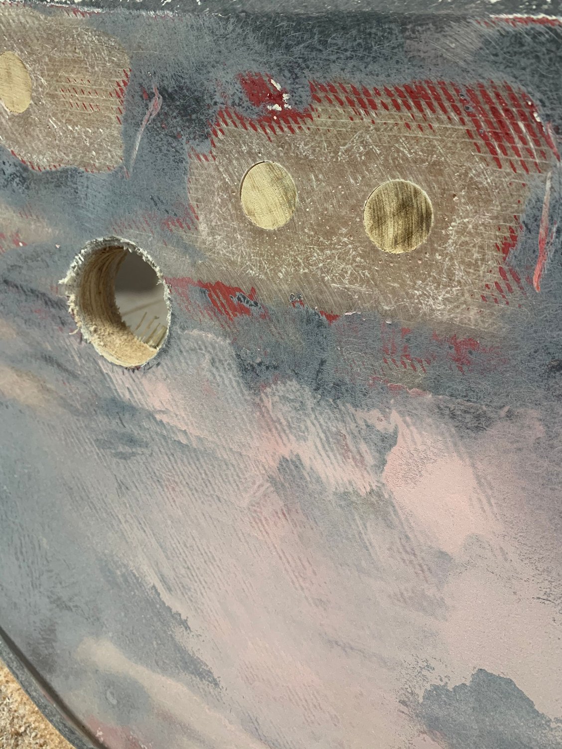

Drilled the old mounting holes out to 7/8 and glasses in doll rod and glasses over then used marine filler. Didn’t want. Just use filler.
Filled in we’re old pvc pipe ran for wiring.
Filler applied !!
Glasses up and ready for filler
