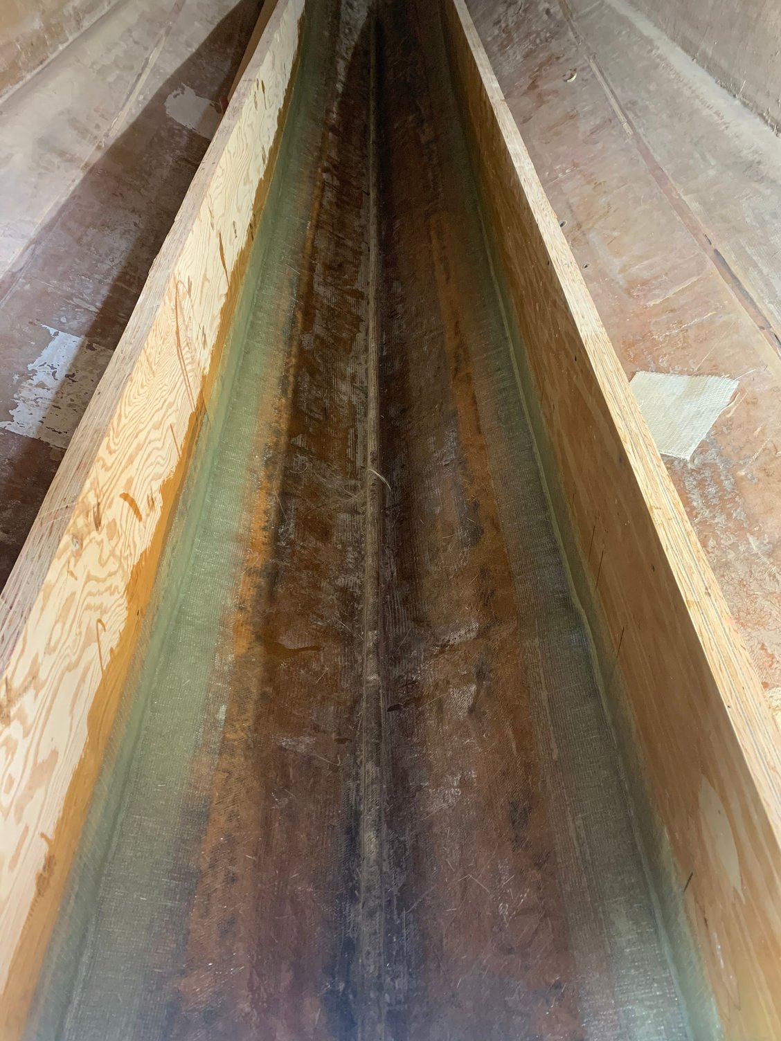

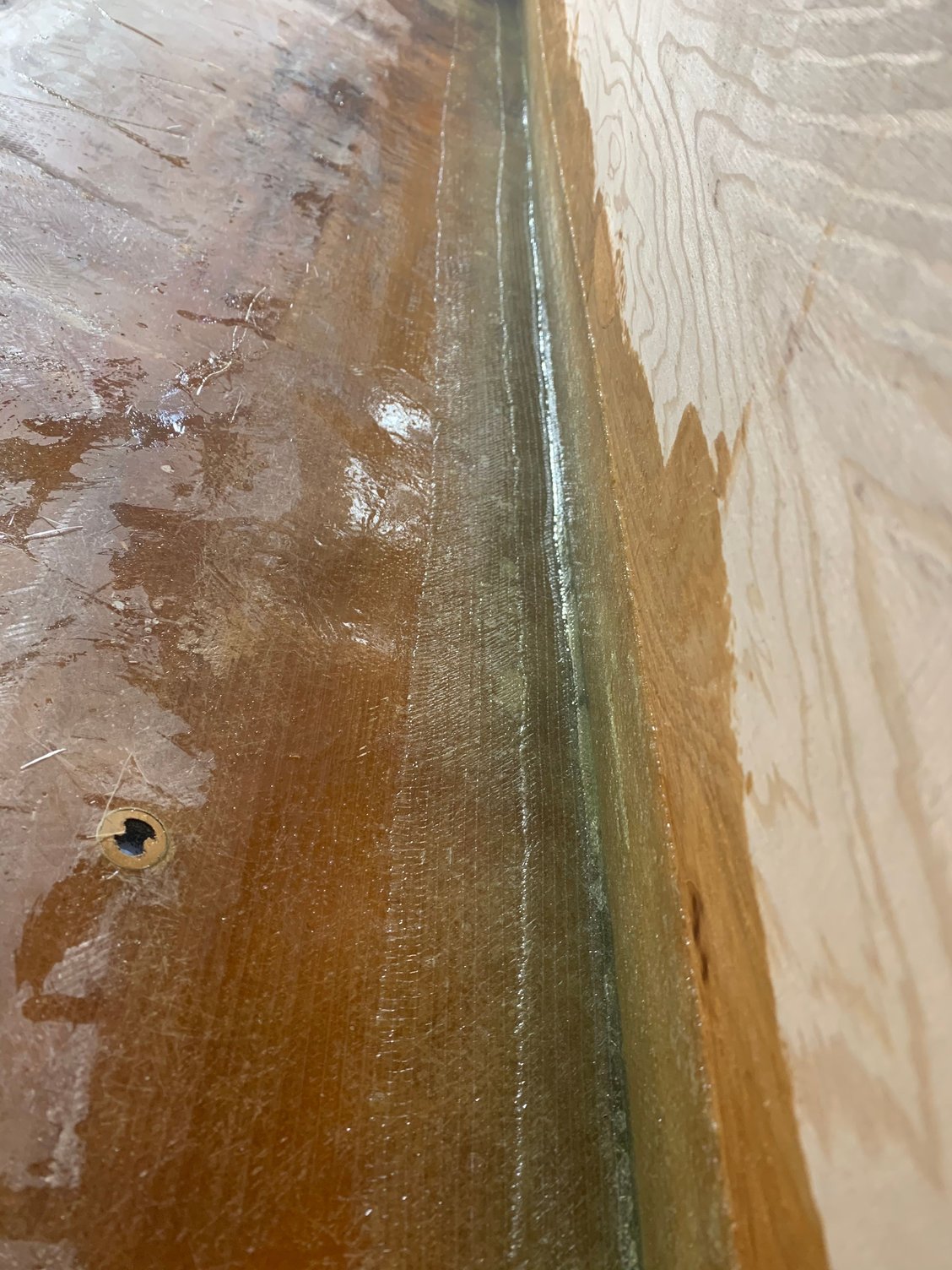

4 layer of tabbing on there sitting on there own I know it doesn’t look like much but I feel like it’s finally moving along .
Ready to start wrapping them in glass

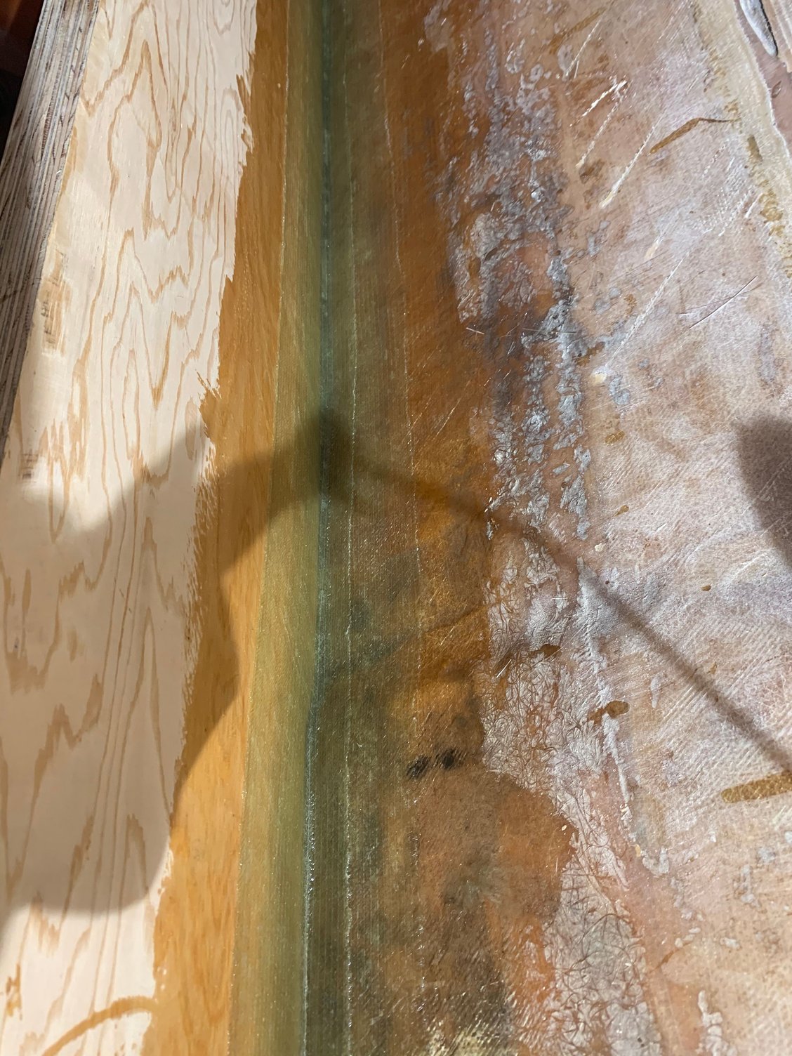

Got one layer on my coring repair and a few more layers of tabbing on gas tank stringers just about ready to start wrapping them !!! Slow progress just been working on a few hours a night

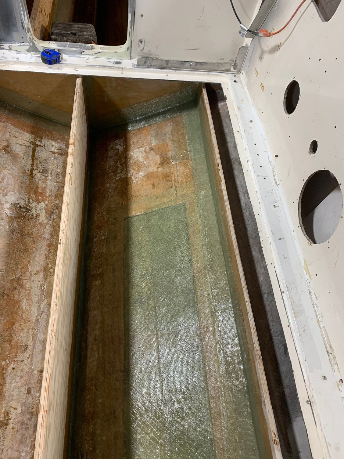

Got a layer of 1708 on the center stringer few more and fuel tank area will be wrapped up !!

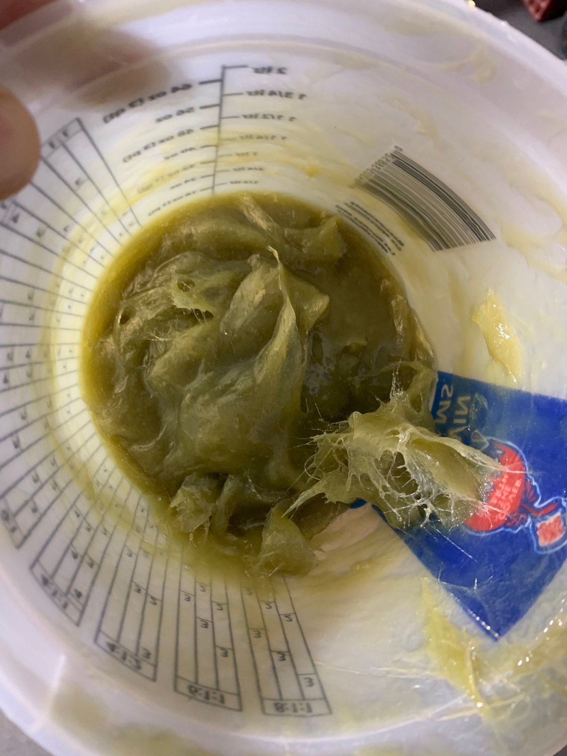

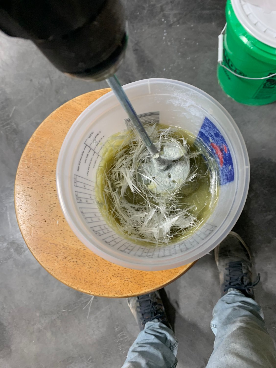

Made some resin with chop strain in to fill any gaps under stringers
Figured the chop strain would give it strength
After I pushed that in any voids I put 3 layers of tabbing on once that cures I’m going to put 2 more of the bigger layer on then wrap the stringers she should be plenty strong 💪
