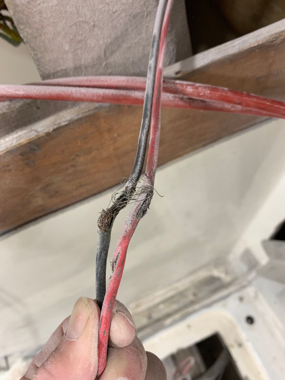

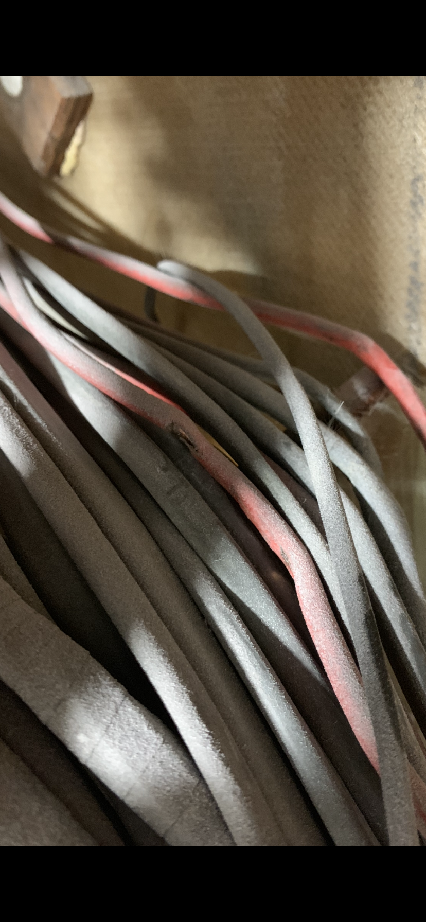

Just going threw camera roll these pics were from when i removes the liner in the cabin looks like the liner was just sat in over top of some wiring. 25 years of abuse.
This is what made me decide to re wire entire boat. That is all the wiring that runs up the Stb side next to helm we’re it sits on top of the side bulk head (that was broke) all the wiring is rubbed threw. So that’s explains the gauges dancing around and lights flickering. If you have those problems check there !!!

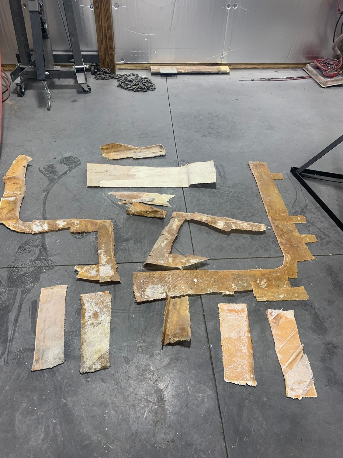

That’s cabin tabbing that I was able to peal off in pieces that used to tab in the liner.

Those circuits probably did not work very well either. Someone was lucky there was not a fire !!
