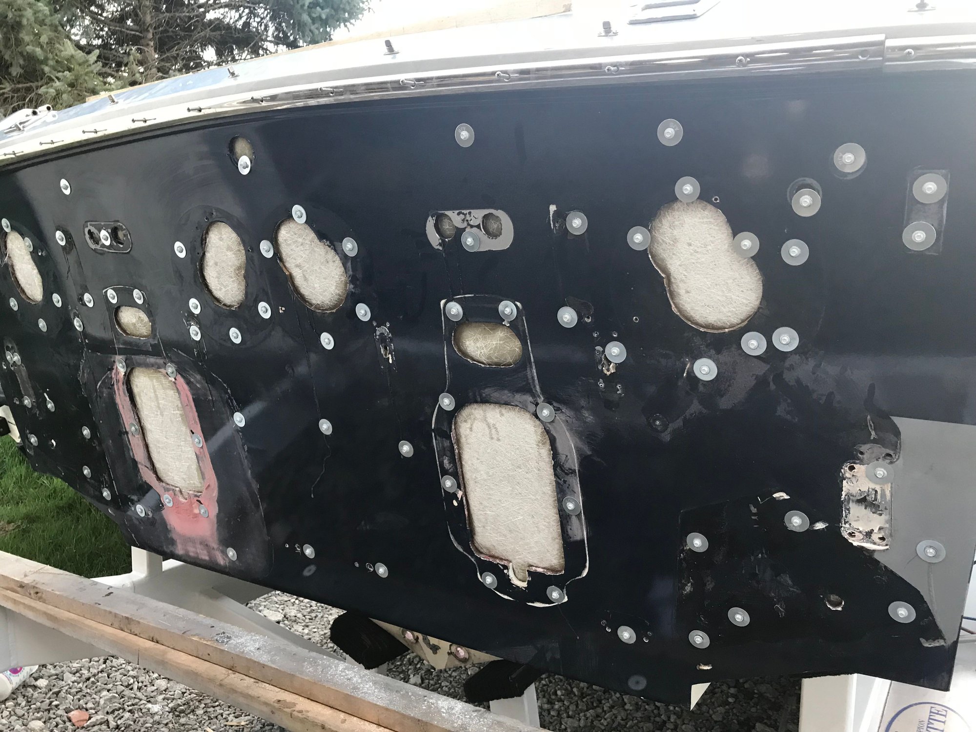

Blowers are going no to dmpe they have been gone there and have the updated parts already they will go get all checked out. We are going to have the heads all gone three and use a young performance roller cam and his updated injection. We are also going to have him stop tune them all. Hopefully they will run well and be reliable. Far as drives go the Konrad have been very reliable and I check the gears a few times per season uppers and Lowers still good at this point. Going to use a high build primer and some awgrip in the bilge after a hole lot of sanding lol.

For the locals transom glass party tomarrow after work !!!

Thanks !!! Going to be a long winter of projects intend to be done in February so I can be on the water for the start of a season for a change. I cut my season kinda short this year to get a good jump on it and get the glass work done before the weather turns. After that I can just lock the door turn on the heat and work on it

New transom in and al screwed tight
