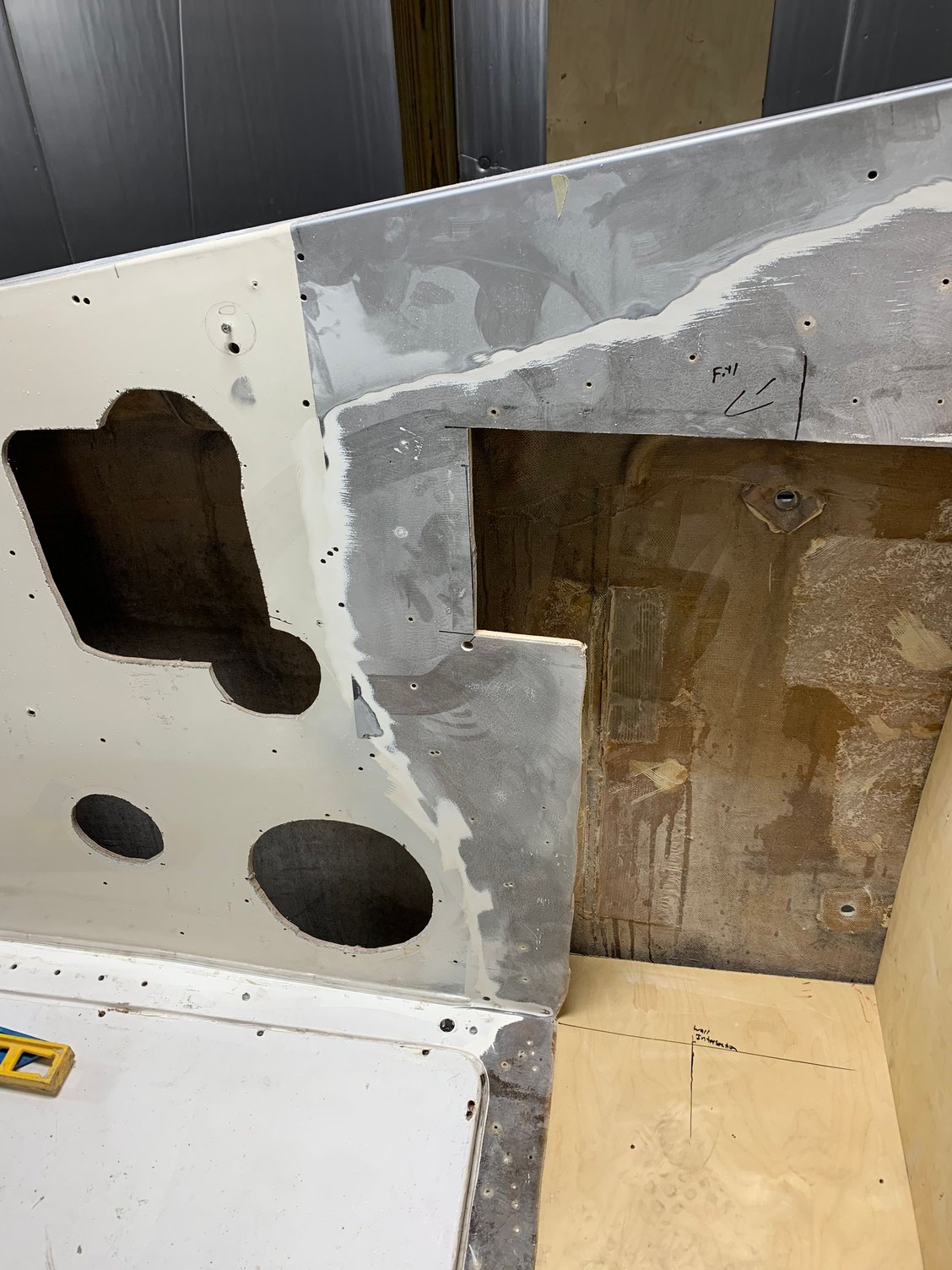

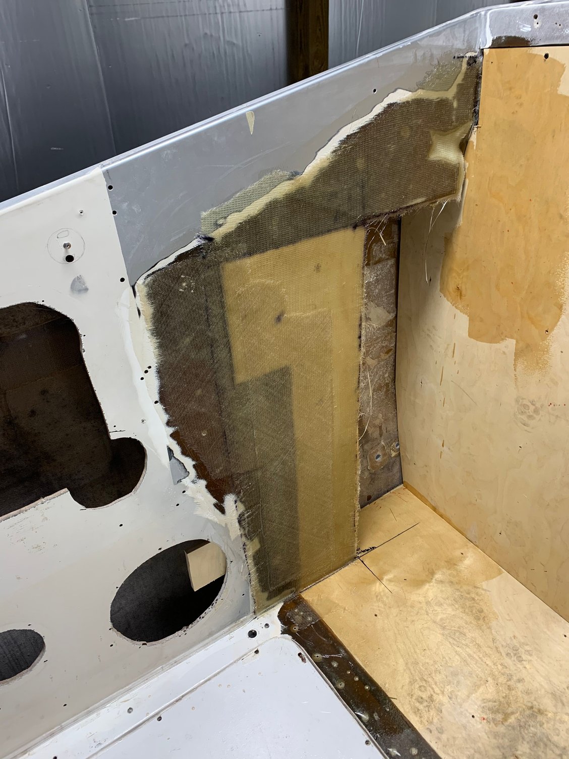

Starting the forward bulkhead
Ready to fill in
Need to clean up
Filled in some void space
Glassed up ready for mounting

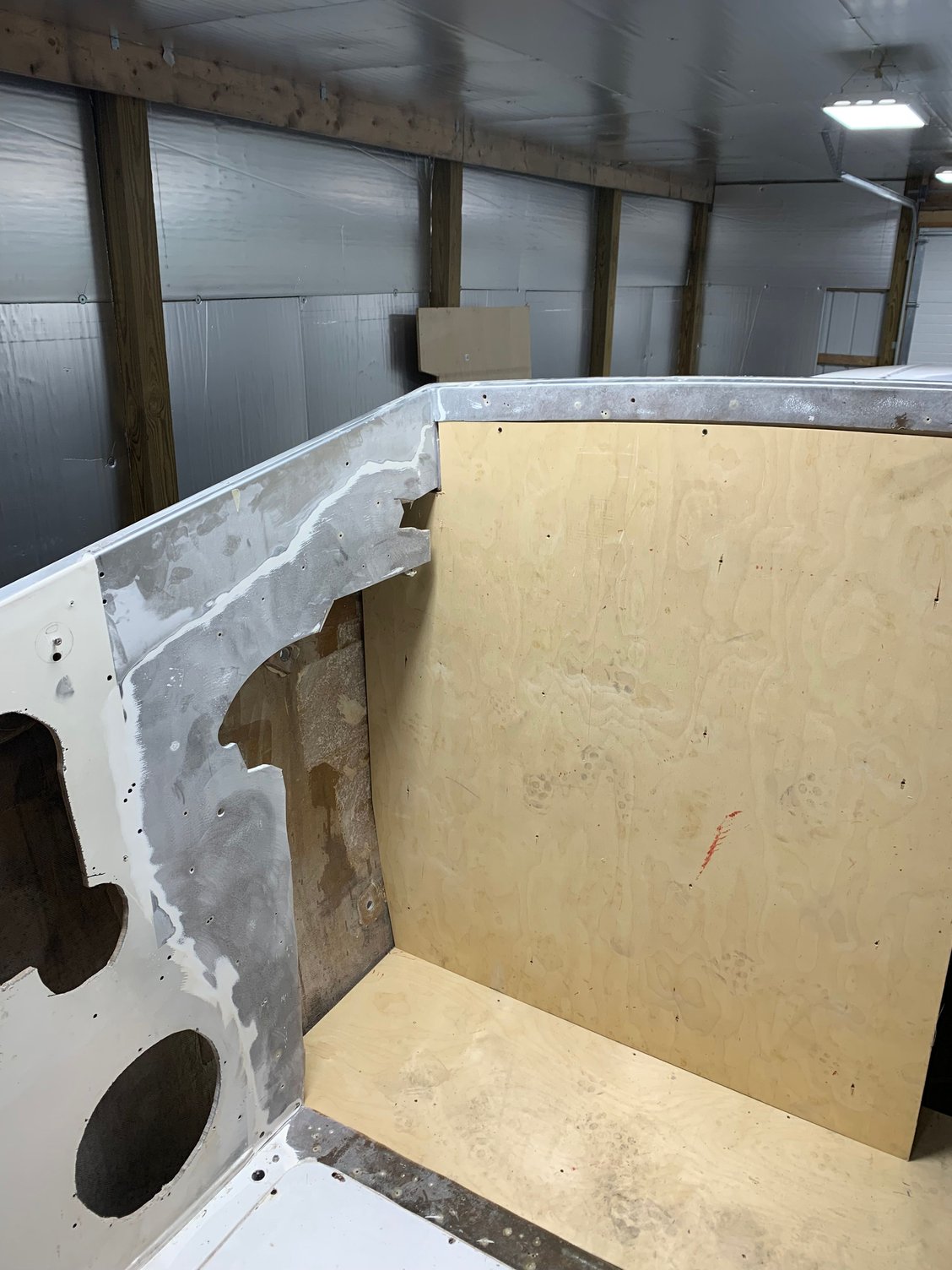

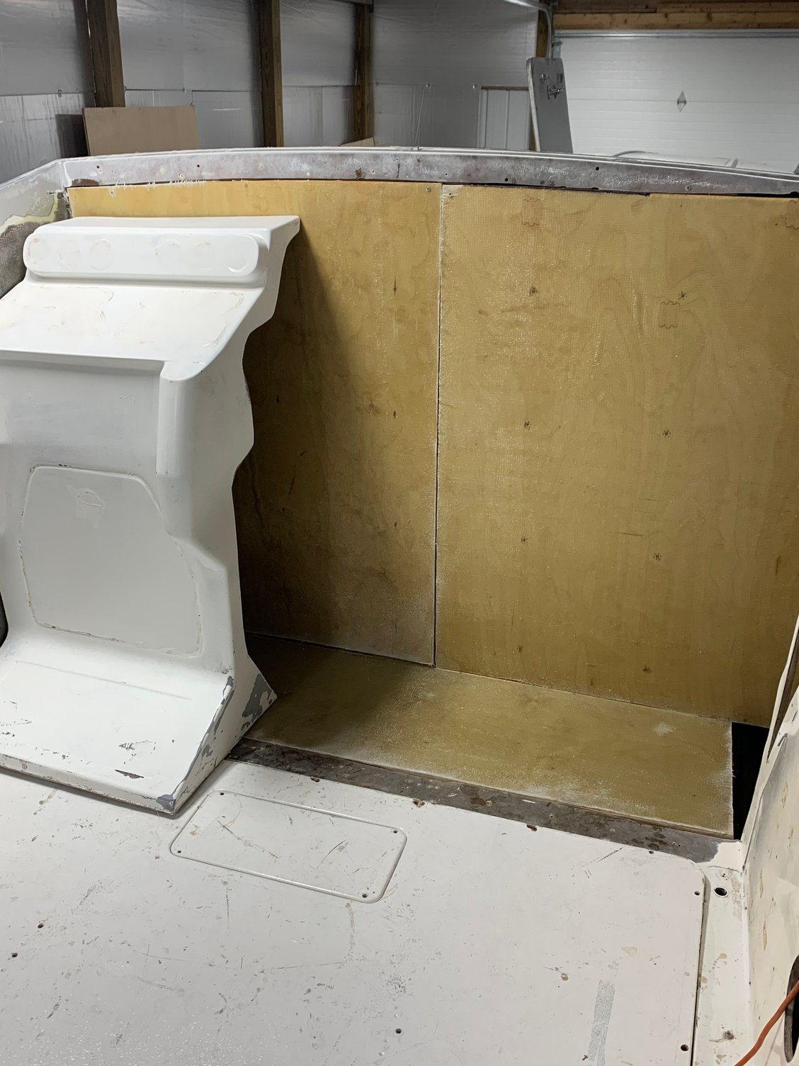

Got the floor extension and bulk head all cover in a layer. Those pieces are all ready to get all glasses in the boat ans cover with som more layers. I’m going to cut the original floor back in front of the new pods and put a permanent piece in then glass a few layers over the hole new floor pieces. With my new tanks being shorter I have room. That will make the floor really strong and have a nice new strong place to mount the new pods. It’s coming along slowly.

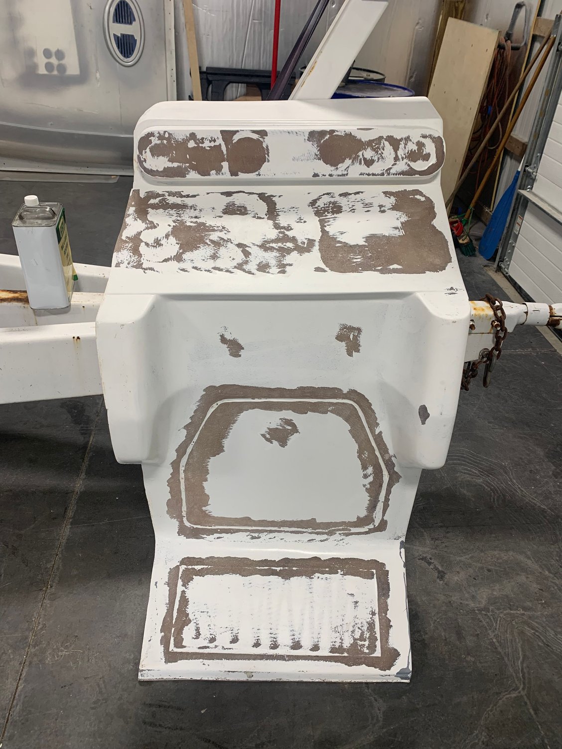

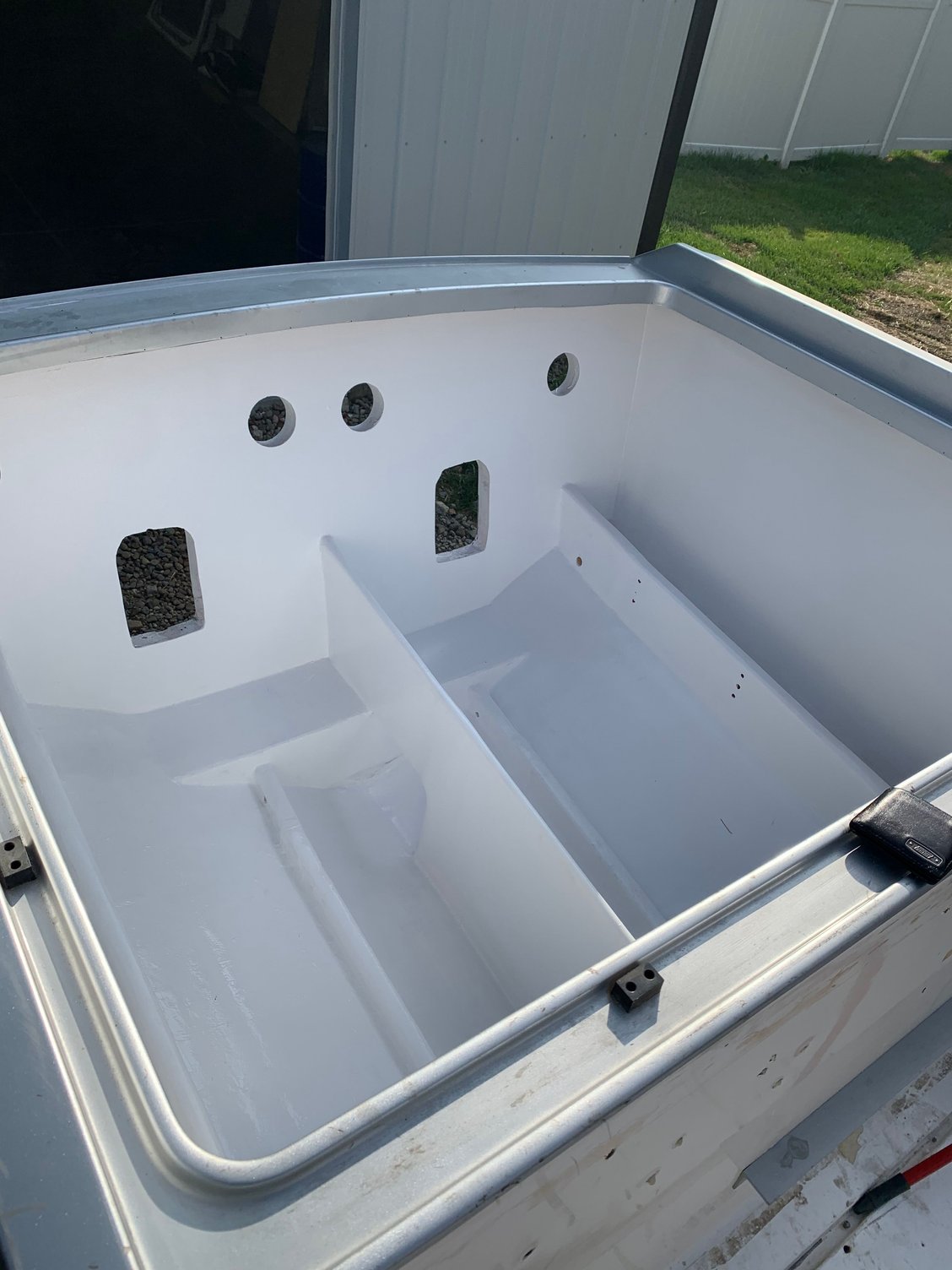

Got the first layer all wiped down with cleaner and sanded with 80 rolled in a second layer of white gel with wax in it cured real nice. Going to sand with 150 to get smooth and spray the final coat of product in.
First coat of filler
Ground flat ready for filler is
Bulk head going in some more tabbing and a few more pieces and she will be ready for gel.
