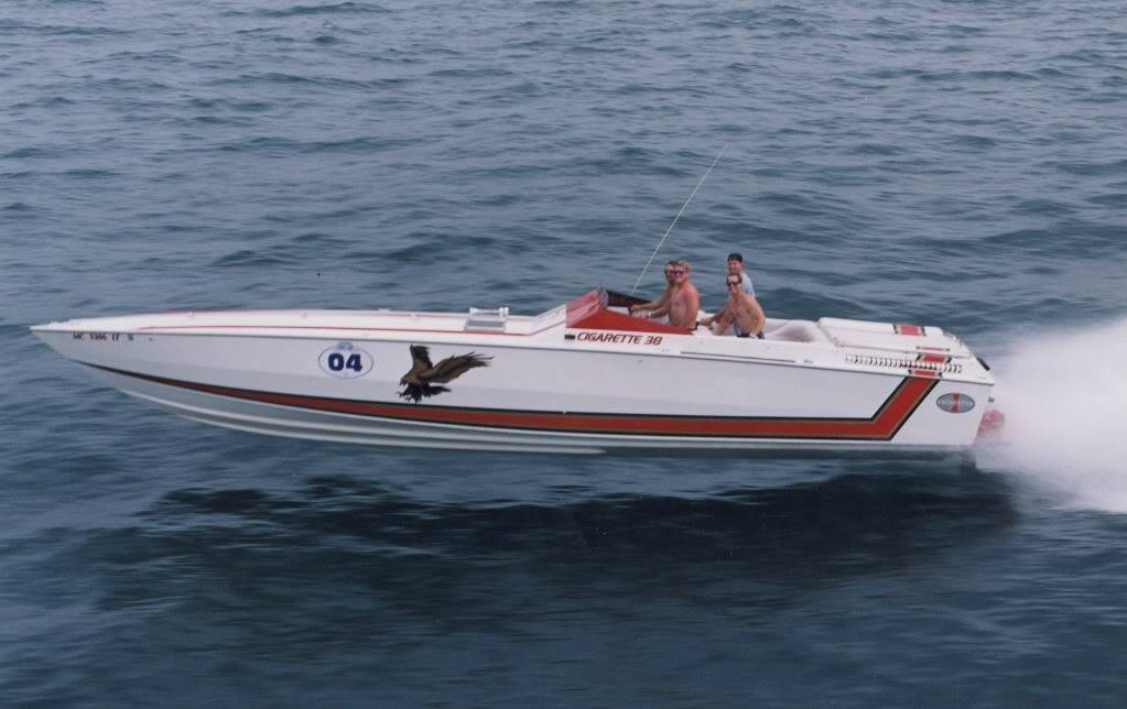

Our 388 has a little over 4ft of lifting strikes removed by the transom to settle it down at high speeds. Different boat, so probably doesn’t apply to your application.

From what i heard about the 388s, was once you were to put big power in them, the full length strakes didnt handle so well at high speeds. However, with a pair of HP500s, theyd pretty much walk past a top gun with 750s on calm waters.
Prob also why the cigs ride so nice. 14ft from the transom theres nothing but a smooth vee . Minimal horizontal surface to land on off waves.

Dan didnt extend the inner strakes. First, he had someone remove some of the outer strakes, in therory to let the transom settle. Then he had them put back on, and did that tres martin wedge thing. I think the wedge helped the porpoise.
Speedy, the measurement i am speaking of, is if you take a tape measure, and measure from the transom edge, to the end of the inner lifting strake. the longer the distance, the less strake you have.
All clear now, the distance where there is no strake

he said 14' from the back of the boat, he is asking if a longer inner lifting strake would make the boat ride out of the water more and less of a wetted surface, the short answer is hydro dynamically speaking, yes it would, but being as the boat would be riding higher the propensity to chine walk and fall to the sides instead of down in the front would be more, also with a longer lifted surface it would change the X dim slightly. I dont think that it would be hard to do, didnt Dan do something like that on his?
After Joe had me measure mine I made a post on FB about this and what you said was explained to me by a buddy that designed Baja hulls, I am also wondering if it has anything to do with the Cig hull being a "rocker" hull?

rocker is different, a rocker hull is like a "rocking chair" that is designed to allow water to travel up to the drives. and certain cig hulls have it and some don't, many hulls with notch's have none. strakes channel water in a specific direction to achieve lift and aren't displacement type hulls. strakes are designed to work under pressure with speed, as joe had mentioned the lifting strake ending at a certain point stops lifting, to extend it further back it lifts more and would raise the hull further based on speed achieved.

Mistress is a rocker hull I looked at gun pic and it’s not like mistress bottom at all

This straight bottom 38 scarab had side by side 850-950hp blower motors, #5 drives. Boat ran 108 if i recall.
if you stop the vid at :16 it looks like the water starts where the strakes end. (further back then any straight bottom cig.)
If there was a way to add temporary strakes I`d try it.

The Scarab 38 hull is also a rockered hull as is the Scarab 43. Larry Smith built a non-rockered 43 for Tom Gentry, and it didn't work well at all. That was the first 43 built. I believe they added 3-4" of rocker to that boat to get it to run well. As to the inner chines, not only are the Scarabs longer, I was also told they are wider than that of a 38 Cigarette. So not only does it get better lift, it also makes it more stable. I would also measure the width of the inner strakes between the two boats. If I remember right Larry Smith race Scarabs and production Scarabs had the inner strakes in different locations. I think the race version had them placed closer together.
I`d also like to try lowering my extension boxes vs. putting a spacer in the drives.
I think Rookie made some temporary strakes for his Panther. PM him and see what he did.
