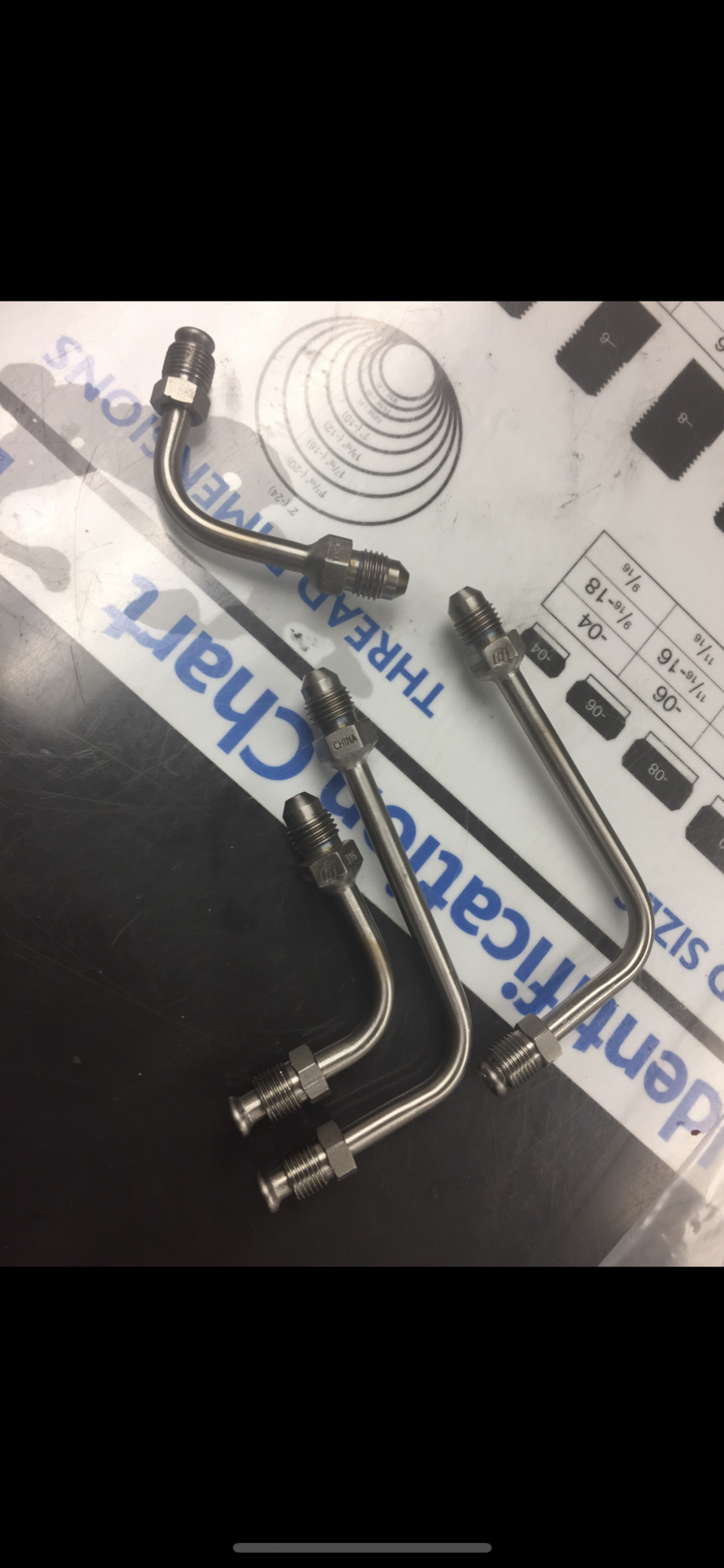

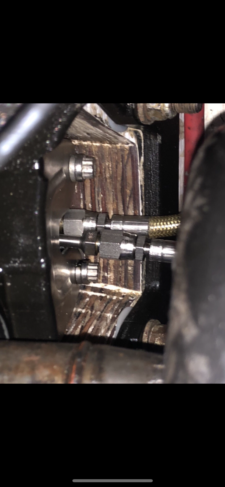

Morning, I sprung a leak on one of my trim ram lines that go from the pump down through the lower inner transom plate to the divider block on the outside of my bravo drive on my cafe. Does anyone know the proper lengths of lines 1 and 2 for a Cafe in this pic? Thanks.

I havent pulled the lines yet;I had trim
oil coming out of the orifice that the lines go through before they’re plumbed to the divider block.

I'd unscrew the block from the bottom of the TA and take a look around. I won't be surprised if the fittings in the block are broken....

I pulled it all apart this afternoon, one of the adaptor fittings (37 degree inverted flare) was fukt. the lines are fine. I need to order new distribution block, trim ram lines, and adaptor fittings.
