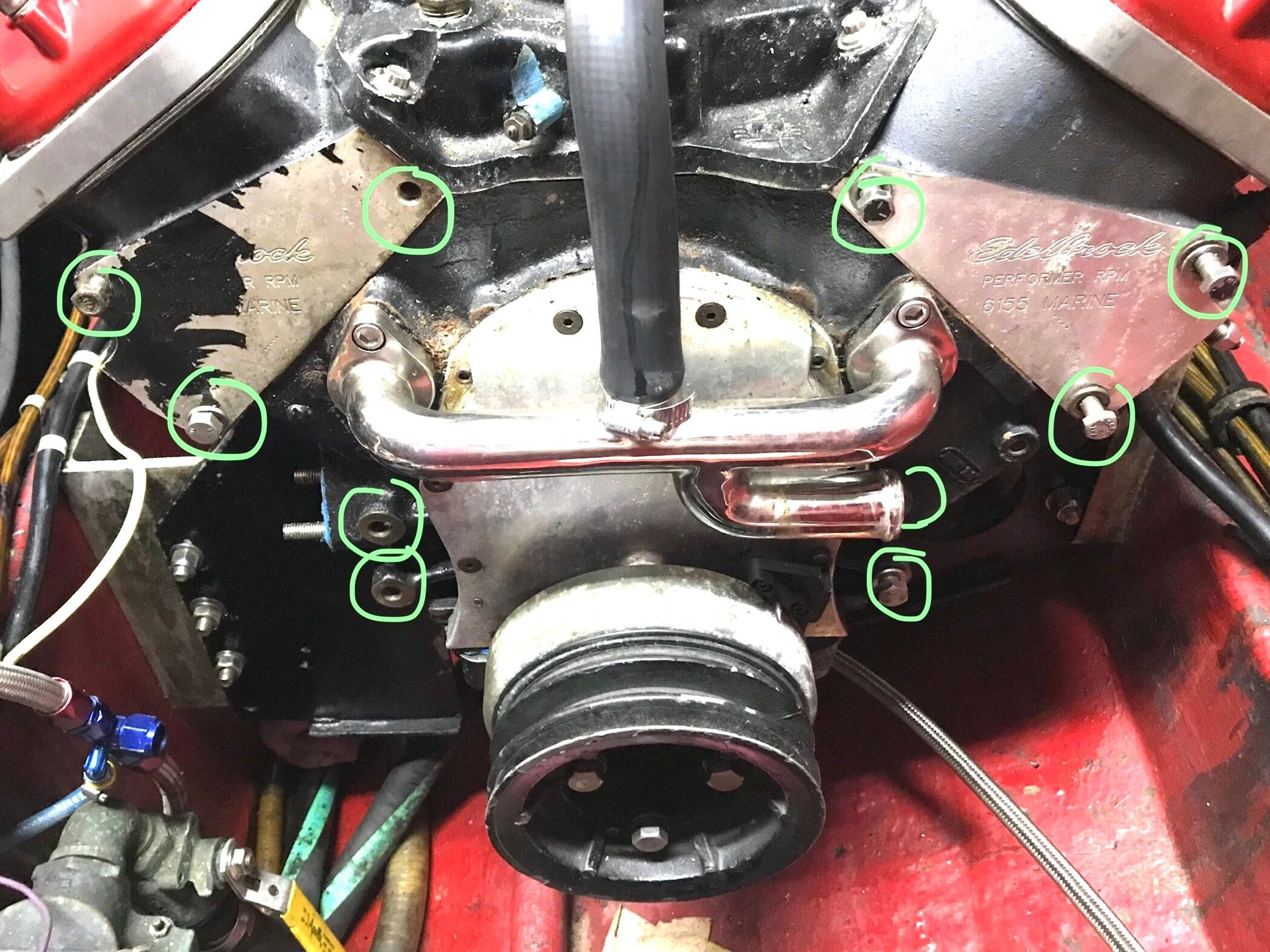

So I’m on my own now and have to see how to get the engines out. Thinking of making two plates which will attach to the marked points with an eye on top for the hook. Don’t want to ruin the aluminum heads.
Good idea or not?

How about 4 - 6" long bolt in front port exhaust bolt hole and one in back starboard exhaust bolt hole. Then use a lifting strap with two eye ends (one on each bolt) and lift. Make sure lifting strap will hold weight.

I’ve seen photos were it’s done as you suggest but I’m a little wary of putting all the weight on the heads as they are aluminum. Or isn’t that a problem?

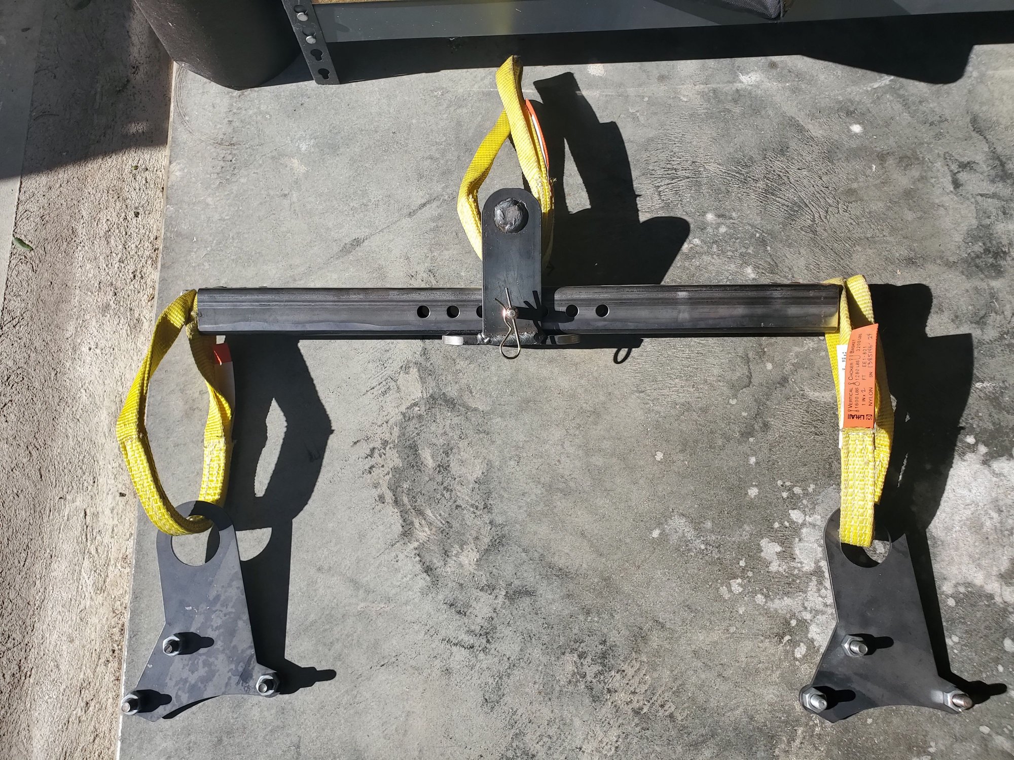

This is what I made, locate the eyelets on opposite front and rear corners of the heads, dont worry about the aluminum heads if you are pulling straight up with the 3 bolts attached to the lifting eye

Nice! Will try it out, seems to be straight forward. Thanks!

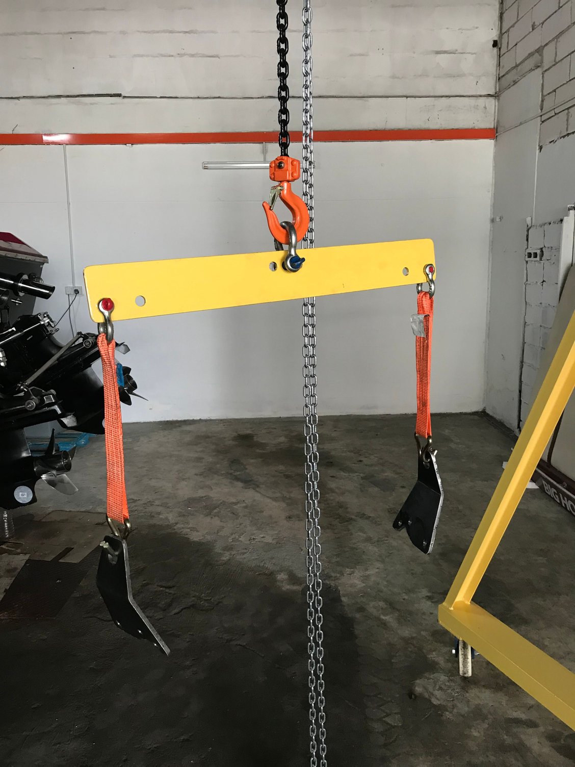

Followed your advice
