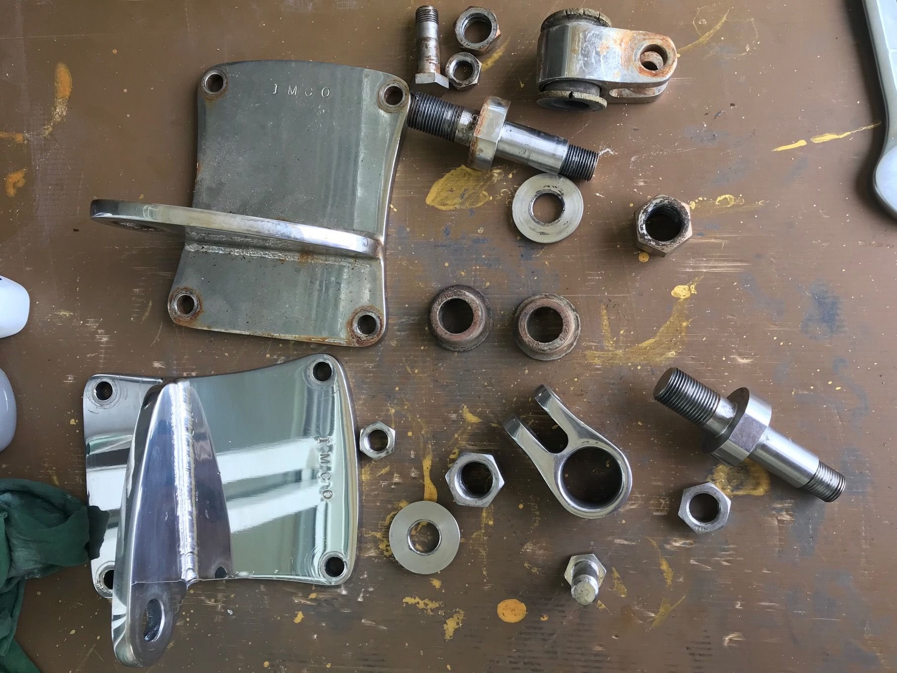

Not much progress on the boat but had a crane build to pull the engines and managed to get the spare engine block to my workshop. Found a local mechanic to help me. Just when we wanted to start Malaysia went into full lockdown because of the coronavirus and I had to abandon my workshop. Before leaving I tossed some parts into my car so I have something to do at home. We have a lot of time now here, everything is closed and we are not allowed to leave home except for groceries (only one person at a time, police and military patrolling the streets).
So I disassembled the Harding water pumps, found broken impeller and corrosion. I really have to inspect every single piece of my boat, because every time I do, I find that it has to be serviced or repaired.
Photo is misleading, crane is only 2 ft higher than the arch and not that skinny
Hardin 2 Stage Sea Water Pump
in pieces
this is what you get when saltwater sits for months without flushing

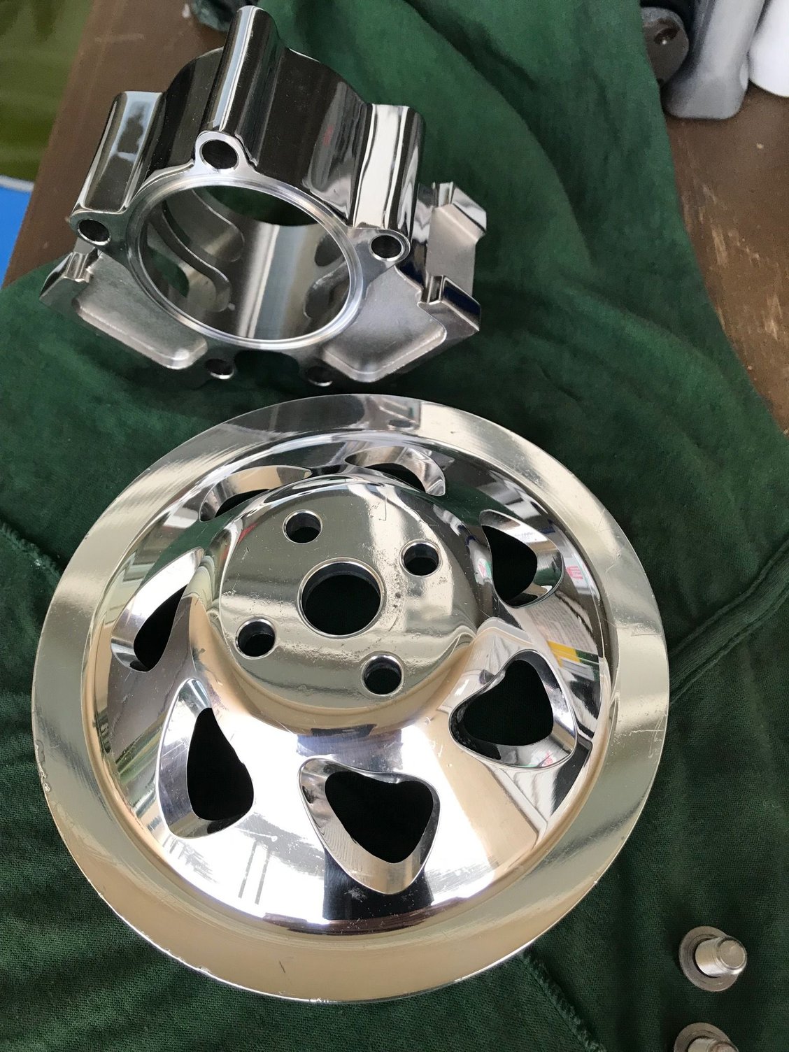

some steering parts
hours of hand polishing

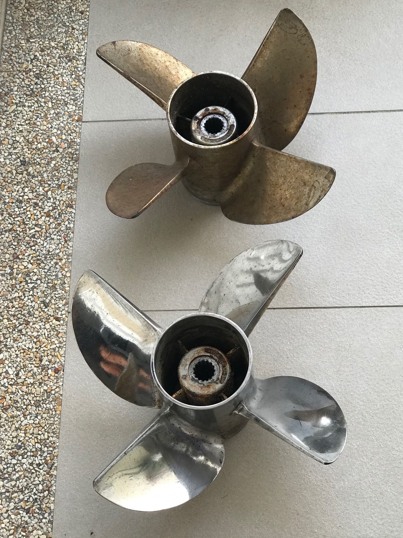

4 days of curfew later
the propeller still need a lot of work

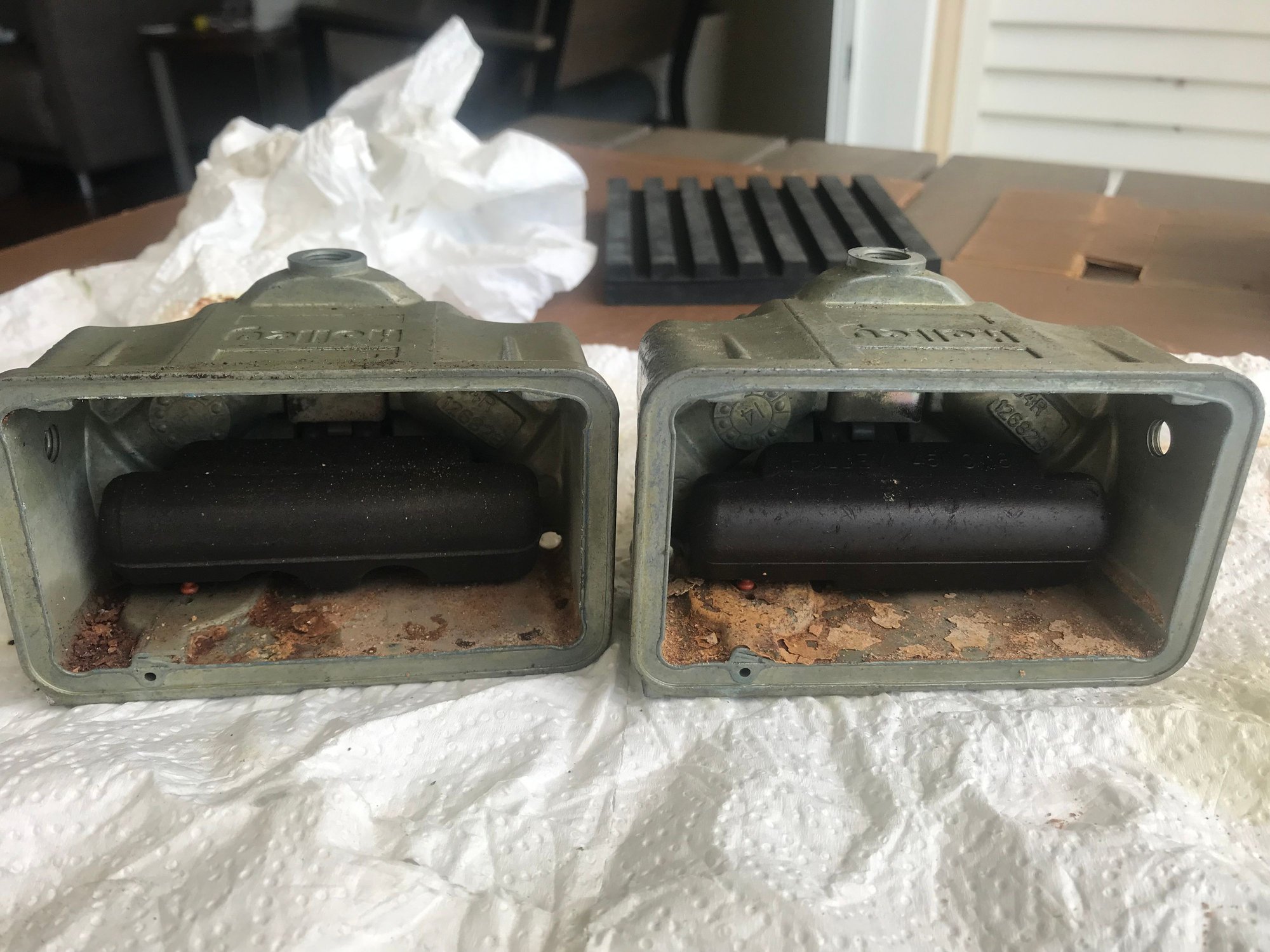

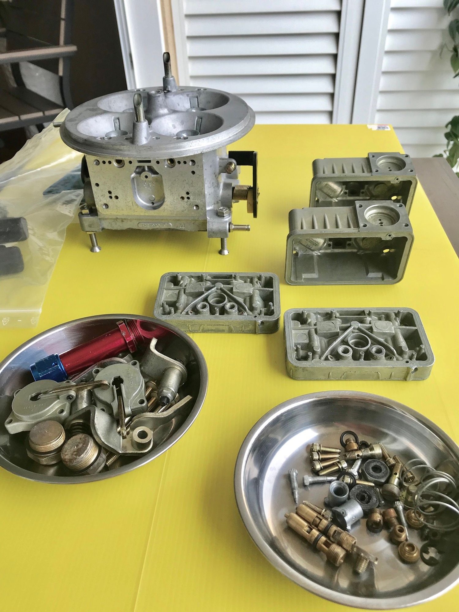

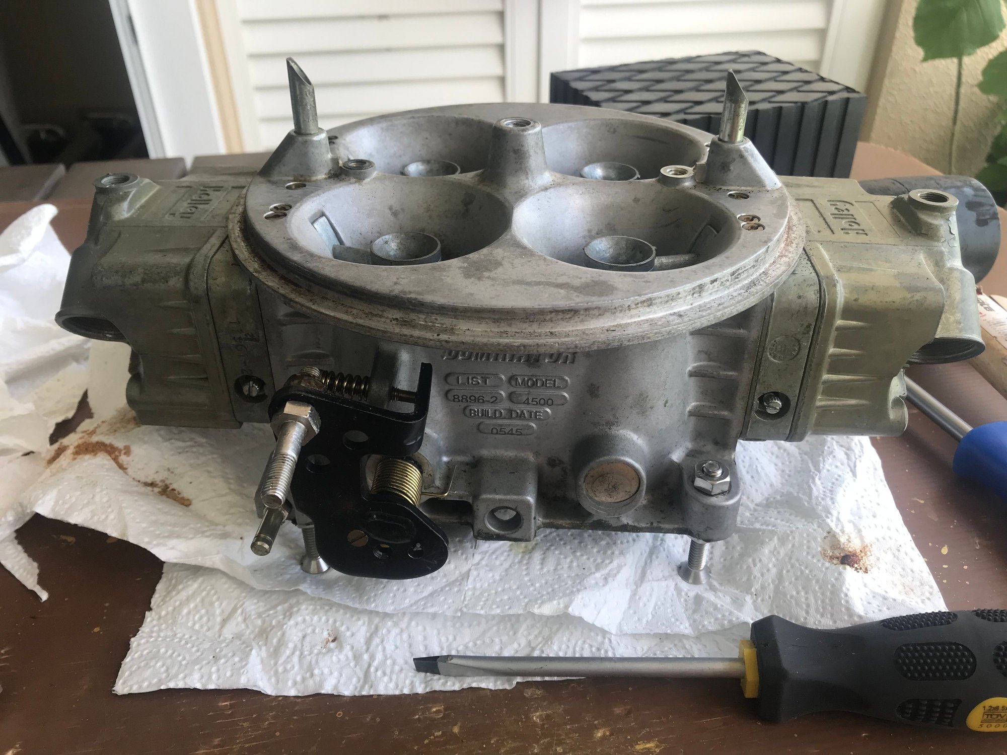

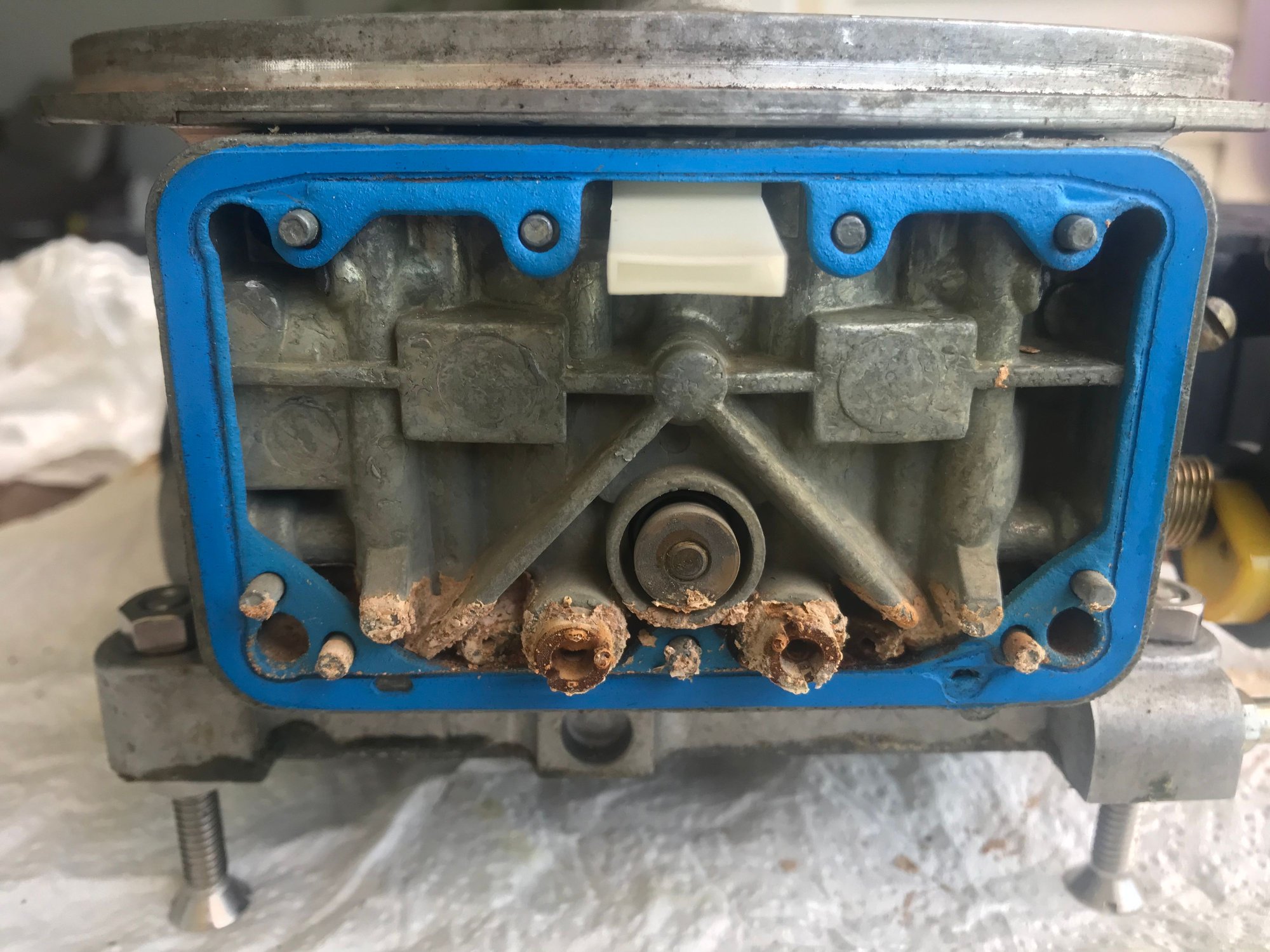

Still locked in at home, so I did some more cleaning. Starboard carburetor this time, lots of dirt and grime as usual. But somehow satisfying to see that there is a reason why the engines didn’t start (well, stbd is seized now anyway).
Can’t wait to put everything back in.
Carburetor cleaning, again
Seller wondered why engine wouldn’t start
All cleaned up
