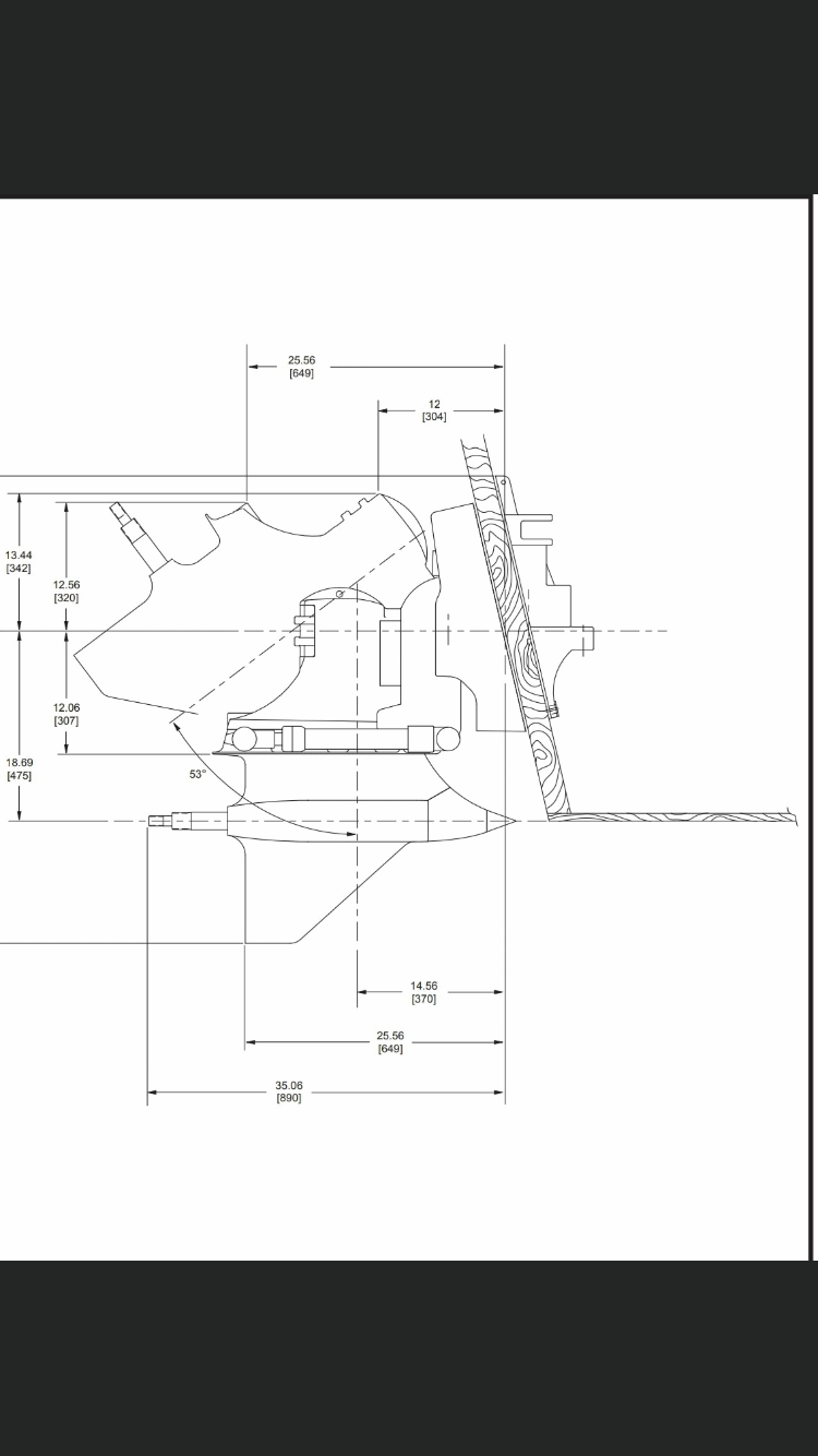

Here is a couple charts to look at
Full Force is offline
