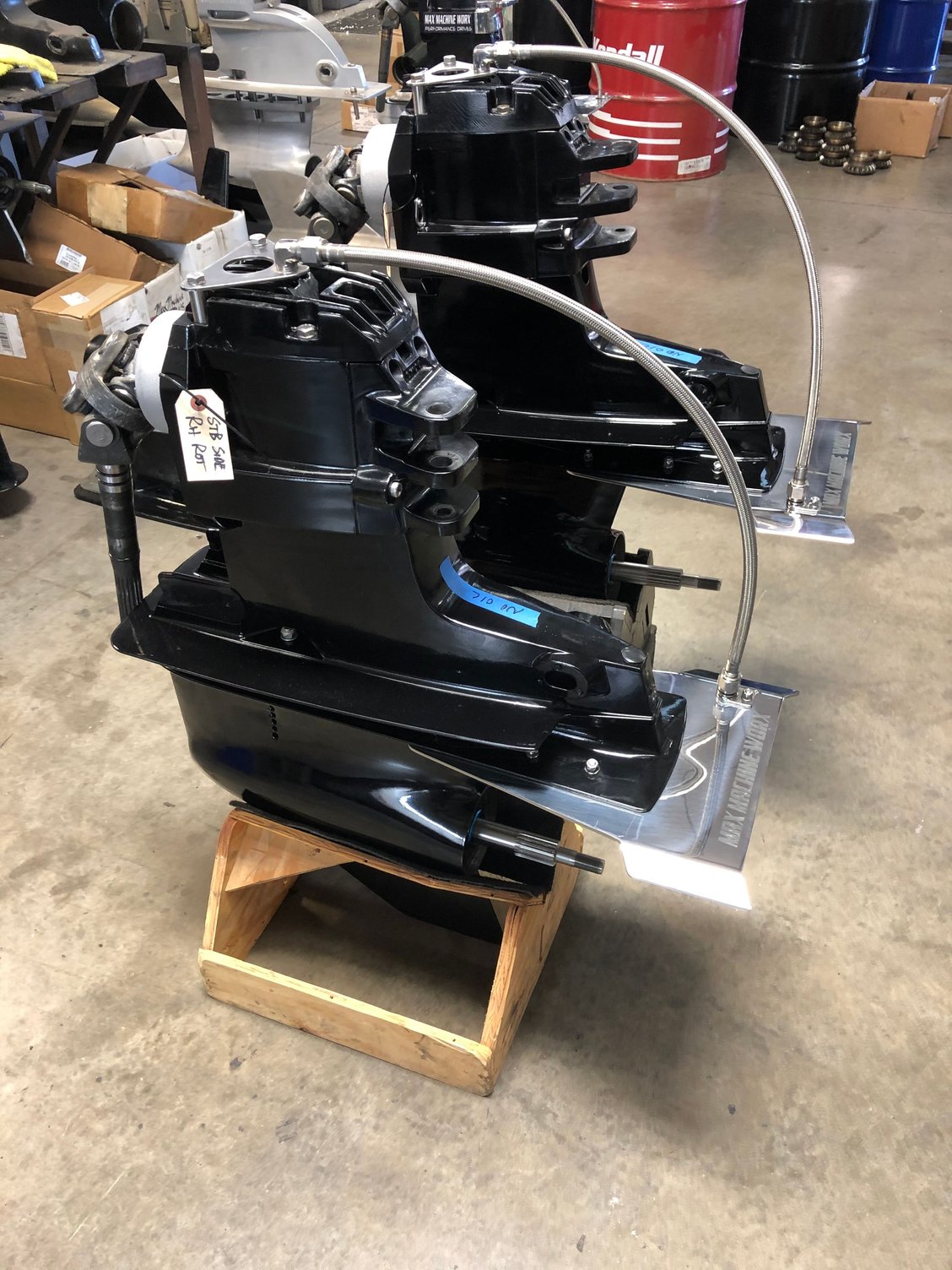

Tank on here, used wings or sometimes called whale tails, by max machine works, that mount on drives. Seems they worked well on his cafe. He might chime in. Might be worth trying, assuming you have a bravo boat.

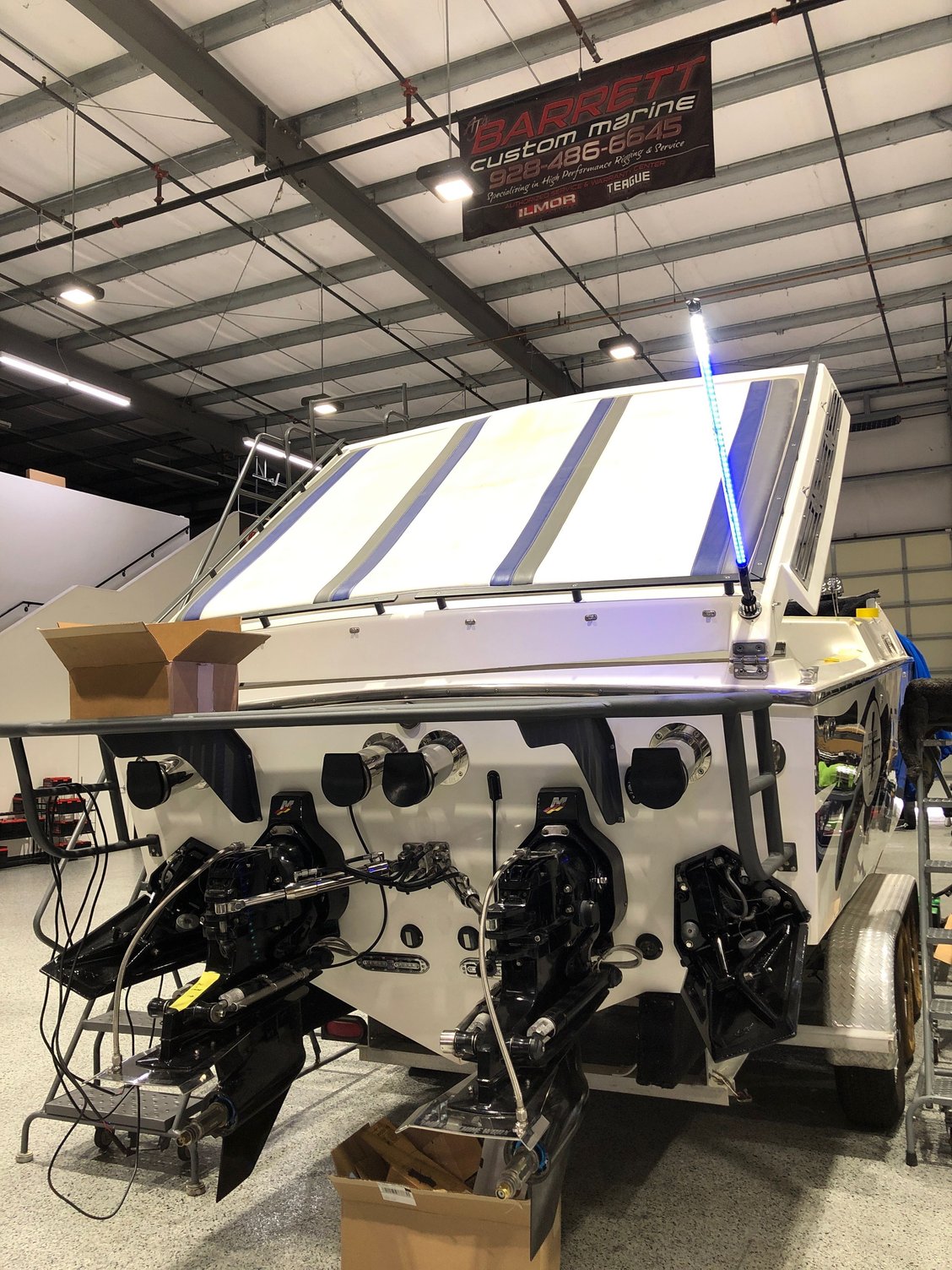

I will say this, as Curt pointed out, Max Machine Works put wings on my bravo drives at Barrett’s request. When I first saw them I was like WTF? I have now just gotten back from running the boat for past 12 days and holy crap! The difference is insane. Our cafe is a non notched bravo / XR boat. The props are 26’s 4 blades but it’s under propped right now. Gonna try some 5 blades and 4 blade 28’s and see what it does.
as it is, I can put the tabs all the way up, drives in and the boat pops right up on plane effortlessly. Then I can either run neutral tab or tabs up and kick the drives out and the boat runs flat! I couldn’t believe the difference. It’s crazy.
i haven’t been able to run it in big water in the ocean yet but am looking forward to seeing how it will run there. It was windy as sh!t a couple days and threw some white caps and same driving manners. It was also dead flat several times and again flat and smooth no tabs.

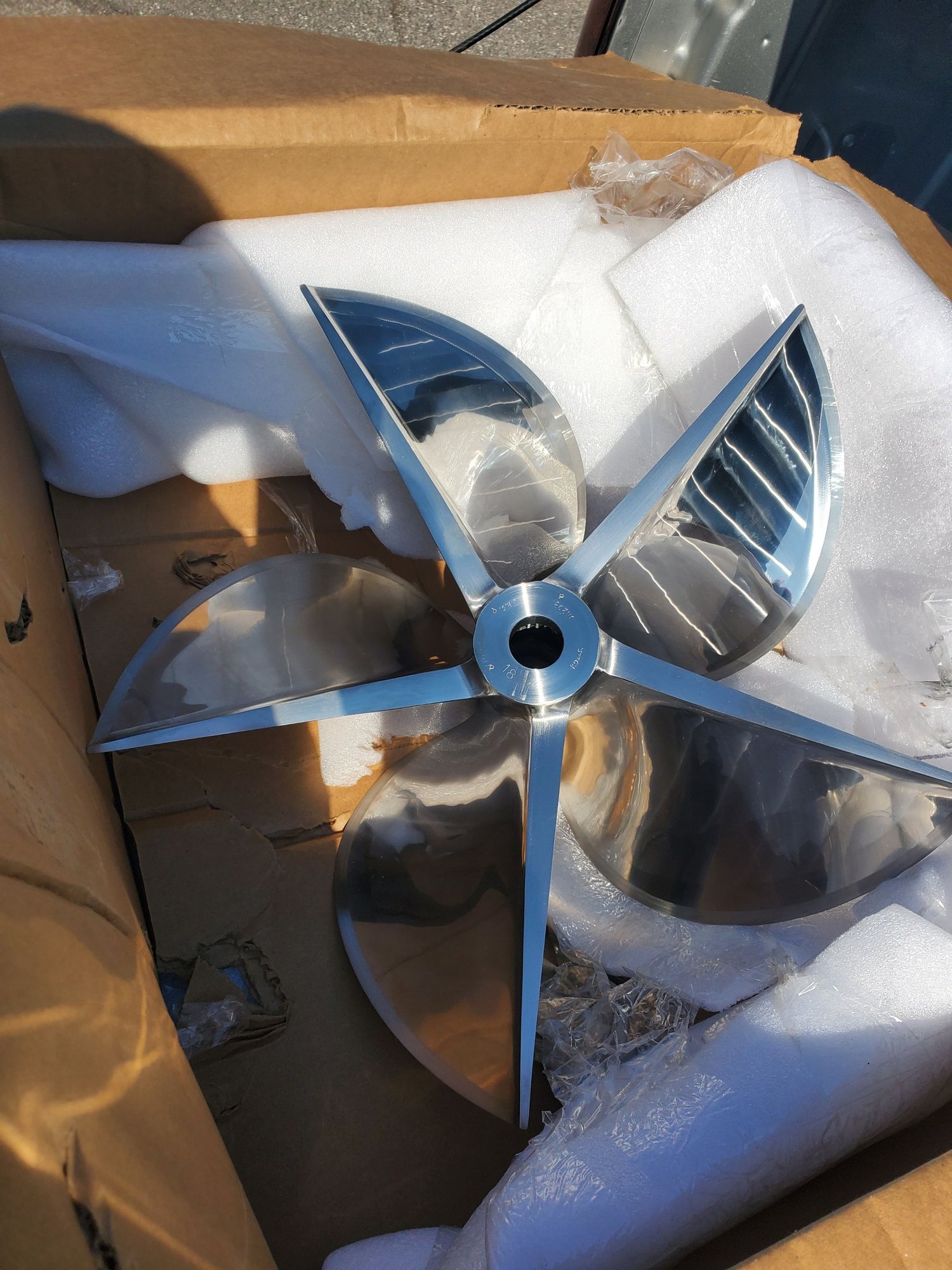

Few weeks ago I tried a set of ROLLA 5 blades . 18x26 These things got me on plane at 2500rpm like a bass boat , I was blown away. They grabbed so hard (would die) during docking the motors needed a different tune.
The made the boat fly straight as an arrow, cut thru waves and handle like it never has before. I was amazed how nice it ran . trim hardly did anything .. I could trim to 8 and still no porpoise at any speed.
I had em scanned and the cup was thru the roof. I think it just carries the bow easily due to the cupping.
Taking into account the cup the real pitch was closer to 32ish .
Rolla makes props geared towards diesels with high TQ , these things are THICK. (so they will never be a fast prop)
Now the bad , they loaded the engines quite a bit and I could only get 4500@75mph (WOT) also hard on drives.
The engines and drives did not like them.
but the boat rides like a dream with them on .. so I had FJ do some work on em . They look fantastic but there was no difference in rpm even with smaller pulleys and more boost.
The issue FJ believes, is that in the meantime I put in 2" spacers
So I`ll take the spacers out and try again.
Long story short , (too late) I think prop selection is key to how the boat handles.

Yes, they machine them and sell them. I would imagine they could do something for a SSM. Give 'em a call say you saw the ones on the Cafe Barrett did and want some more info. They'll know what you're talking about.
