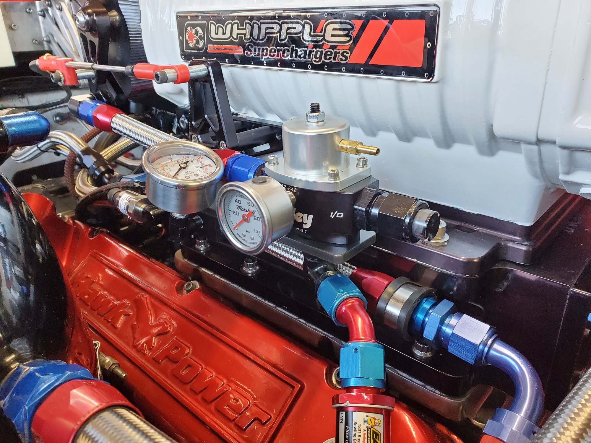

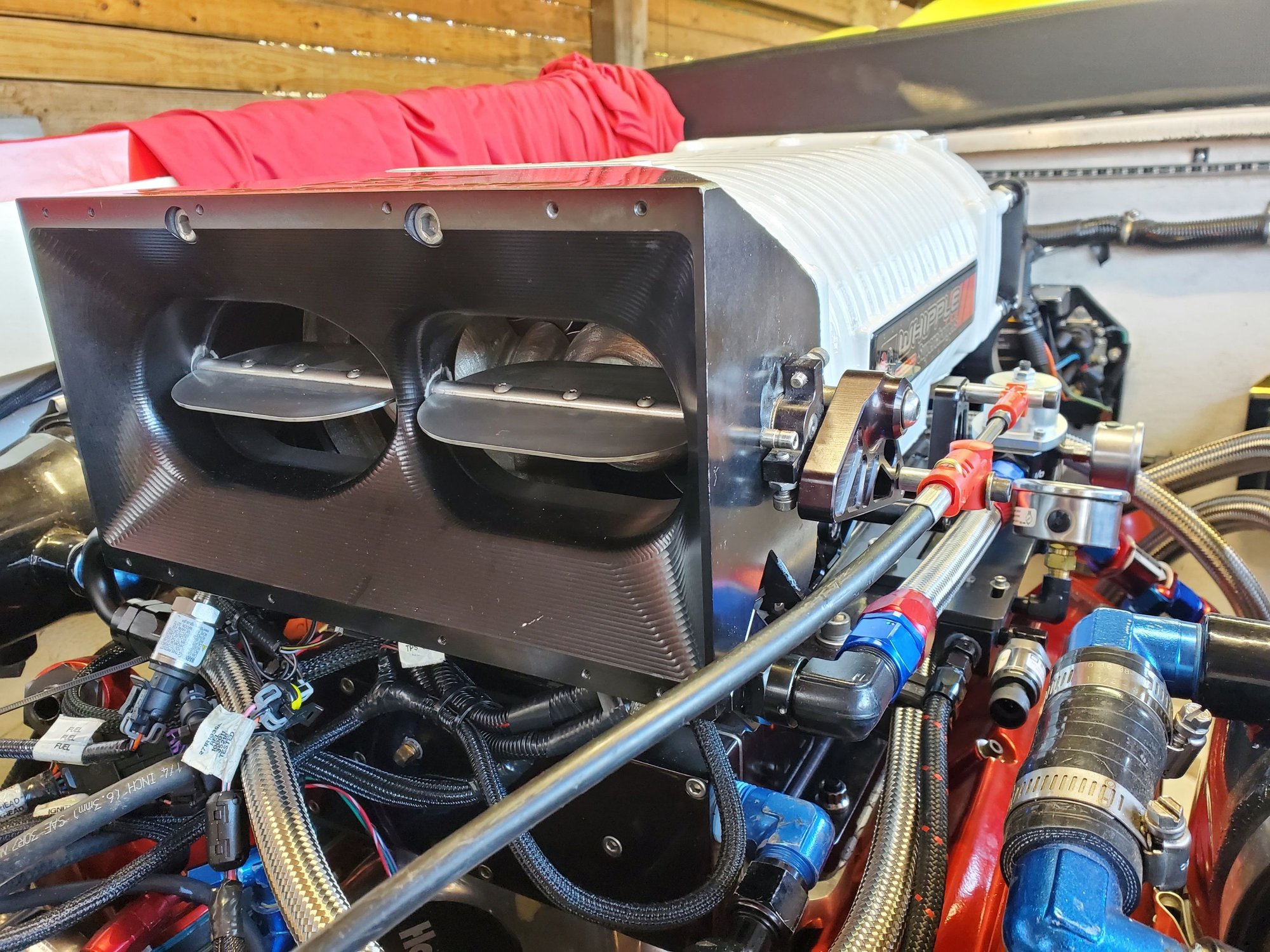

got the throttles figured out (opposite side than carbs and push/pull not pull/push) and my fuel system is done .
gonna need to put the flame arrestor on them 3000cfm throttle bodies, they look like they could swallow small animals.

mine have filter screens over the TB's did yours not come with them ? looks good

Ken , I have the flame arrestors .
