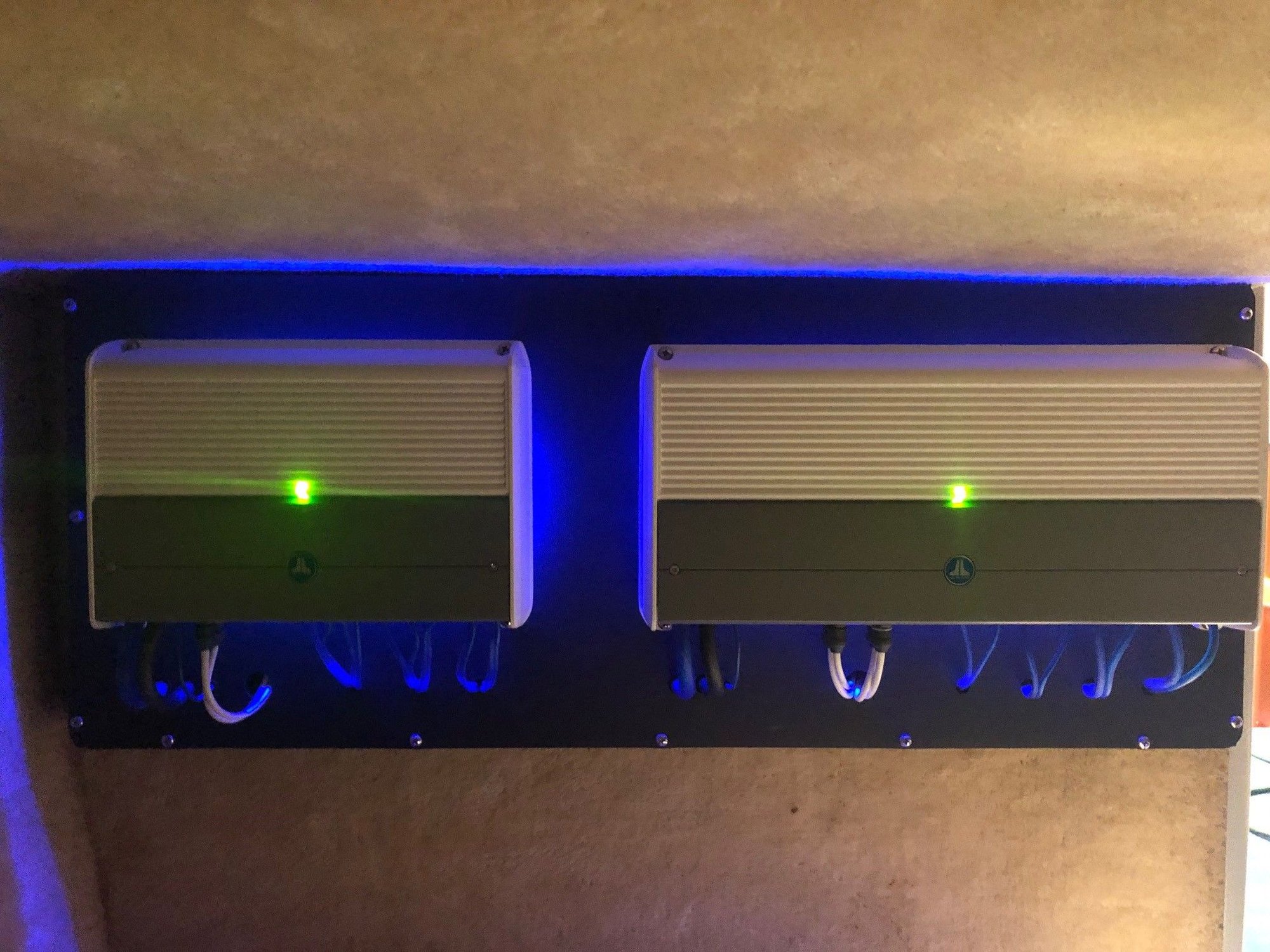

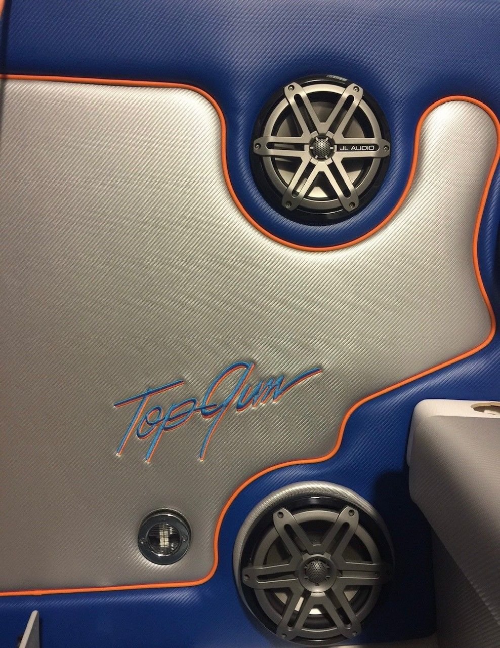

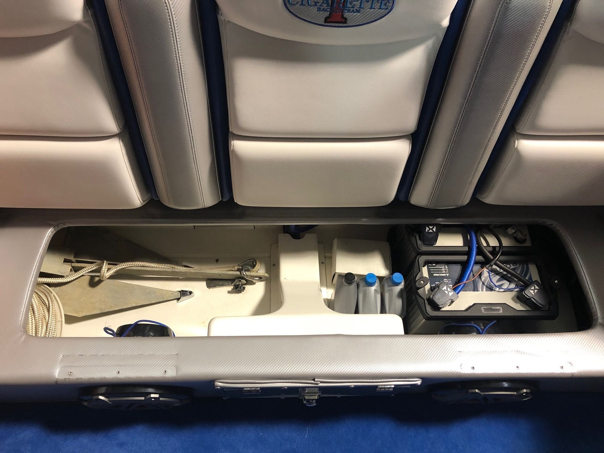

Here's some inspiration pics, not the best pics for location but a general idea. When I updated my cockpit I added JL M-Series which has now been replaced by the M6 Series, I used 1 PR 6.5, 2 PR 7.7, 1 PR 8.8, 2 10" subs, with 600/6 & 800/8 amps and 2 XP3000 batteries. Turned out great and I'm happy, if you can checkout some local boats to see what sounds best to you. Opinions on stereos is like which truck is the best (Chevy vs Dodge vs Ford) all are good, just what ever fits your needs. Also, where I installed the 8.8's I had to use a spacer.

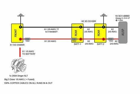

thanks for the pictures those will definitely go to use. my question is how you wired in the extra 2 batteries to the alternator or did you just run an extra line from your existing batteries to charge them off of like seen in the photo below.

I did not connect to my engine charging system, I charge the amp batteries with the XS Power battery charger (HF1215) I installed just for them. I can play hard for hours or make the weekend before charging.

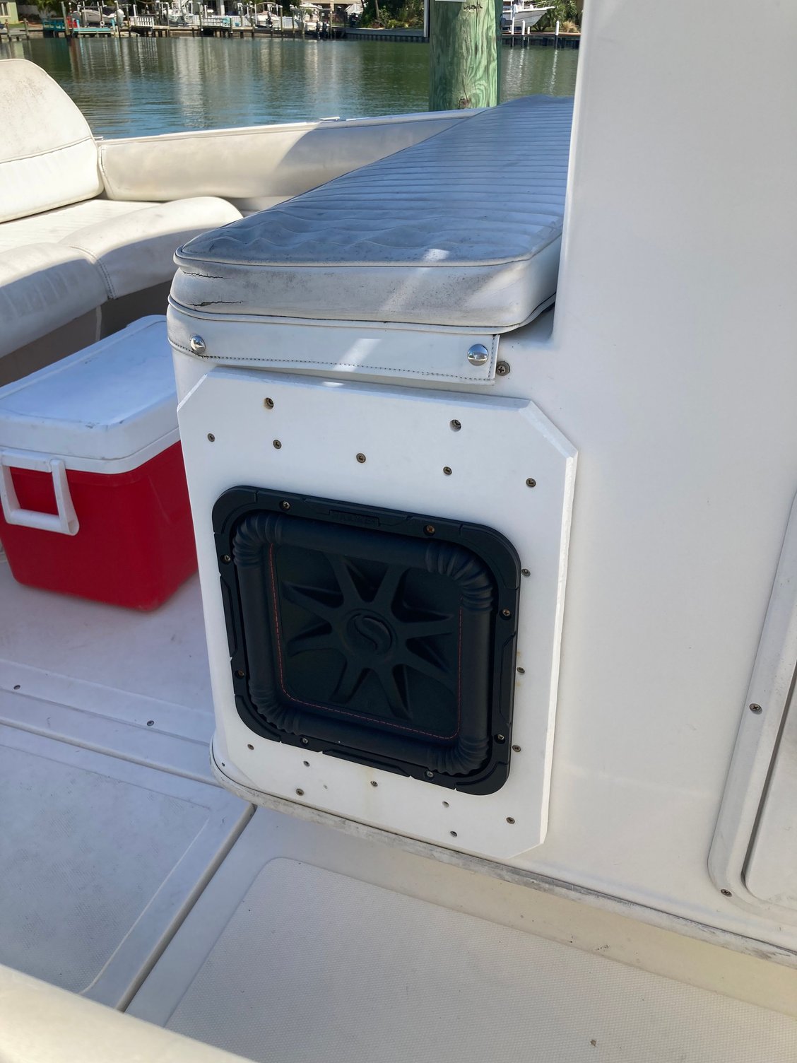

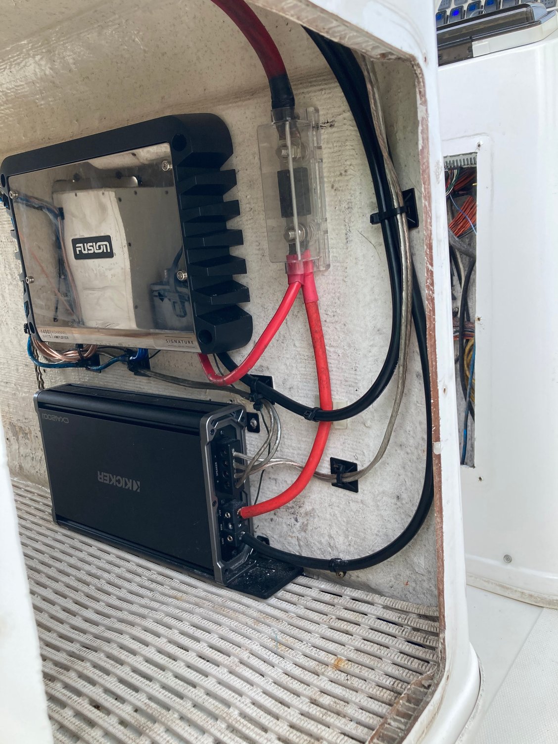

10 total speakers playing highs is total overkill in that cockpit, you’ll have to turn the highs down. All that cone area with the additional 4 10s would make some decent bass though. I’ve found you won’t ever regret having extra stereo, you can turn it down. I’ve only had a problem in a smaller boat where the highs were too loud in the bow because I didn’t have zone control.

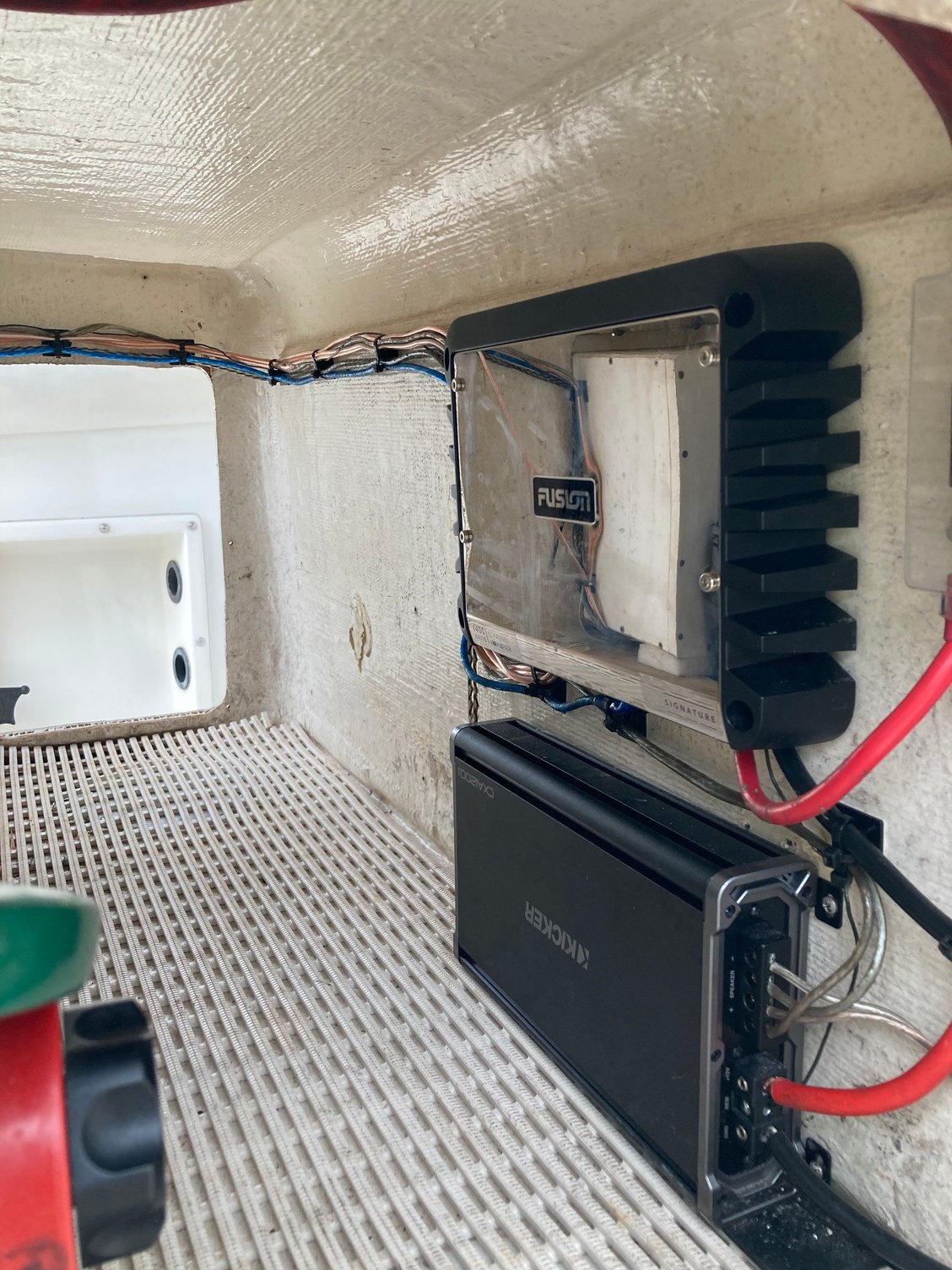

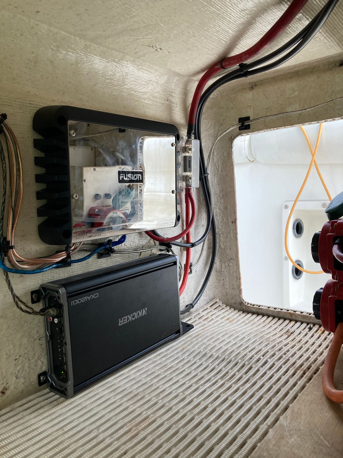

I’m a stickler about building subwoofer enclosures so I can put serious power to the subs. Most boats are fairly lame for bass ime. I’m currently running 2 10” solobarics in starboard enclosures with 12-1400w rms. I’ve got 4 7.7s fusions near the floor with 110rms each. That’s just sufficient for my larger CC cockpit while cruising. Mainly because my backseat is too far from them.
I like kicker and fusion stuff, haven’t been able to bring myself to pay the JL premium.
I currently have the fusion 4 channel for 4 7.7s and adding 2 8.8 tower speakers.
https://www.crutchfield.com/p_917SG41400/Fusion-SG-DA41400.html?tp=96419
I have the kicker 1200.1
https://www.kicker.com/CXA12001-1200...-Subwoofer-Amp
Running 2 10” solo barics.
https://www.kicker.com/10-inch-l7r-2-ohm-subwoofer
in sealed enclosures near the min size.
If you want to run 4 pairs of 7.7s and 8.8s the 4 channel fusion is nice. If you want 6 pairs the 6 channel version is nice.
hogie roll is offline
Old 04-11-2022 | 11:47 AM
Posts: 3,869
Likes: 797
From: St. Pete Beach, FL
You can run more than one amp per battery.
Try to keep your amps digital (class D) and they will be far more efficient.
