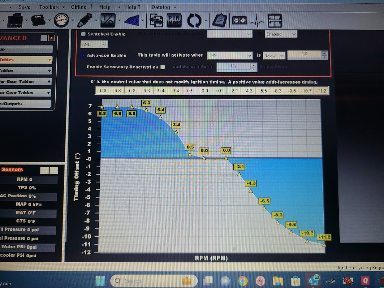

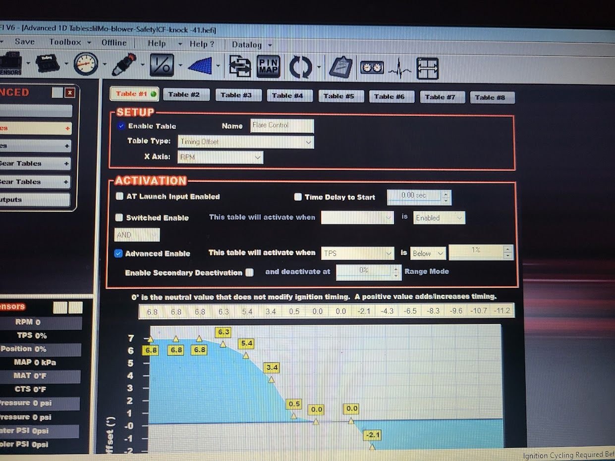

Interesting .... can I see the RPM`s at the bottom?
So when you shift and it falls below a certain rpm it adds timming is that the jist?
I tune the individual cells as I see the bubble travel from neutral to in gear .
I have a custom IAC table that seems to work well also but my spark table for PORT looks like a mess but its the only way I could make it not die.
starboard:
PORT:
IAC:
starboard:
PORT:
IAC:

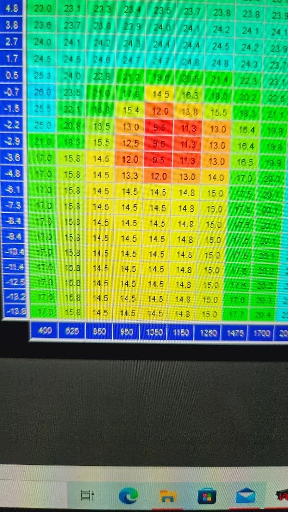

Panther :
What is your take on the MAPand TPS enrichment tables.
They seems to be adding or subtracting too much fuel when accelerating and decelarating.
My RoC blanking was low (2-4) so I think there was too much 'action' I went to 9 dummy that down but I feel in a boat we really don`t need all those tables.
I zeroed out all the MAP AE and handicapped the TPS enrichment.. I`ll see how it goes this weekend.

Dan, those tables for Port and Stbd are quite a bit different as you mentioned.
One of the massive benefits of digital ignition, is giving more than all in RPM advance at idle, cruise and low load, lean conditions.
Dynamic compression is super low with lots of vacuum, and takes way longer for combustion to occur.
I'm stoked to get the Daytona Sensor system for my carbed blowers.
#69
I don't like having the main table all jacked up with the timing in situations like this since it will be adding that timing while cranking and first starting. I want my tables smooth and then fine tune with a custom table to make it work. That's what works for me.
#70
Panther :
Your deceleration enleanment issue is probably in your main table it I had to guess and it happens to quickly for auto tune to correct it and it might need to be smoothed. OR, you might need to turn the deceleration enleanment off all together. Something you have to figure out what's the right strategy for your tune.
It kinda sounds like the tune is a little jacked up to be honest if it's doing all that. In the end I have no way of knowing what's really going on with your engines without seeing it realtime and analyzing your tune. Not something I'd be willing to speculate on online or from a far.
