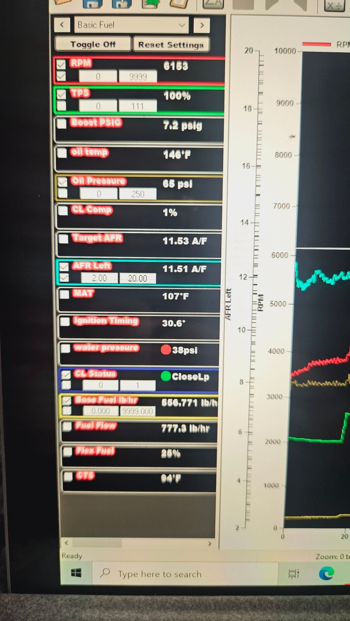

I finally had a day just do only tunning and prop testing and got a lot accomplished and fixed
.The issues were in the main table not in the any accelaration Enrichment.
I cleaned a lot of it up .
Tried some new props and got real close to my number thou.
ICDEDPPL is offline

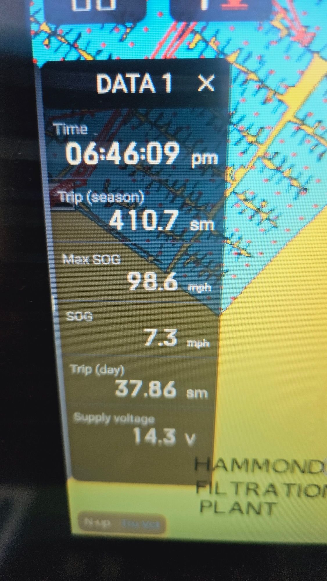

Old 09-11-2023 | 10:45 AM
  #77
Joined: Jun 2009
Posts: 9,989
Likes: 6,484
From: Chicago
that was with 29 pitch 5 blades .
I have another set 32 picth 4 blades that could probably get me closer to that century mark.

Old 09-11-2023 | 09:14 PM
  #80
Joined: Aug 2019
Posts: 1,249
Likes: 420
From: BC
Are the tables close to the same for each engine now?
Doesn't get closer to 100 than that...
How does the hull feel up there?
