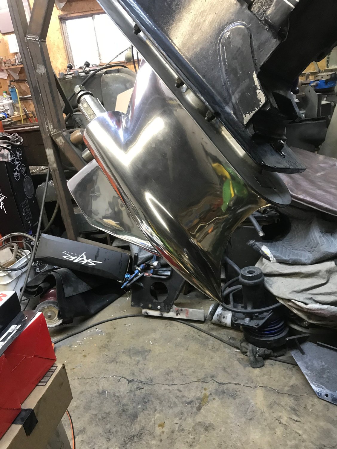

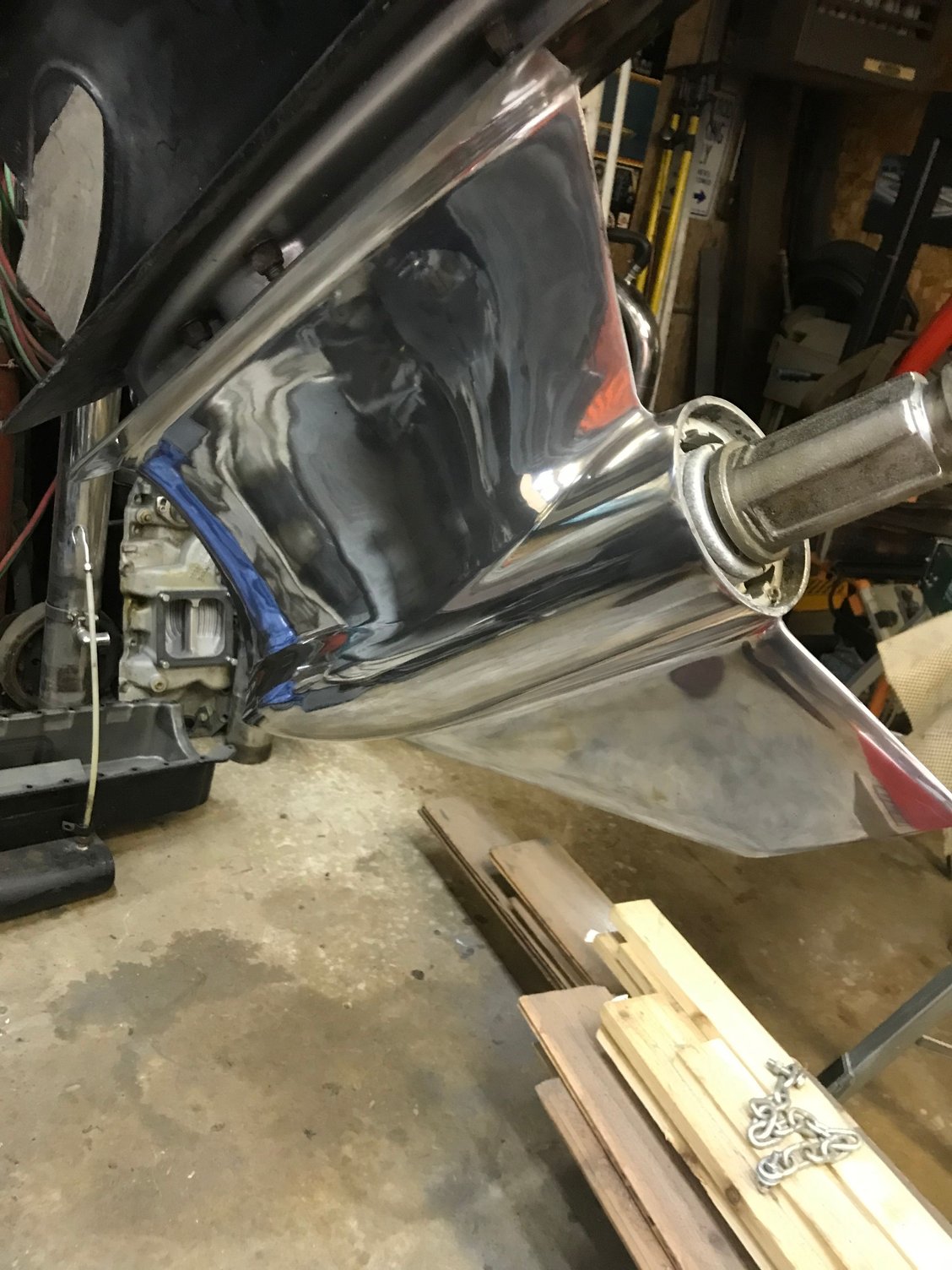

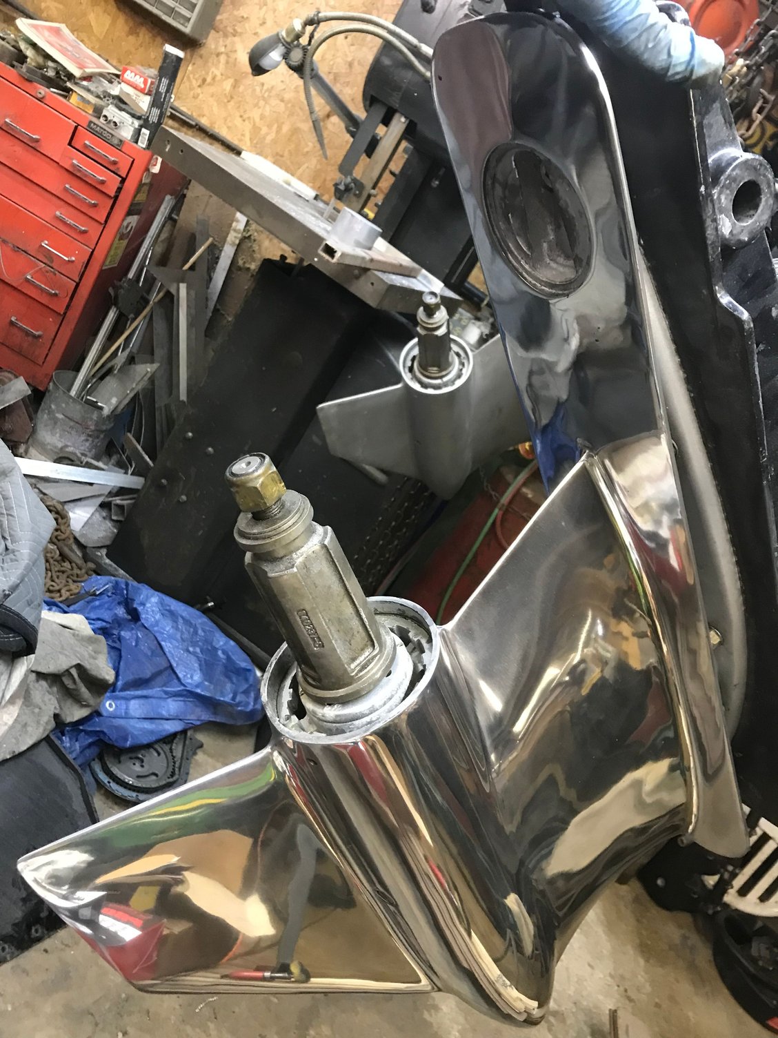

Here is a couple of pictures of the drives I just finished polishing. Hopefully I will get the engines home next week and get some photos of them. I also started on remaking the hatch for more clearance.

dayum!! What was the process to get them
to shine up like that? I was thinking of polishing the lowers on the 6’s but couple runs and they dull up quick again. Polish and clear coat would be the ticket I’m guessing.

These were painted silver, so I started with 120,180,220,280,320,400,600,800,1000,1200,1500,250 0 on a DA in the locked position. Then buffed them with Brown, Green and White bar compound with spiral cut pad, then soft cut, then flannel. It is a lot of work but goes pretty quick if you have the right tools. To keep them looking good use Sharkhide protectant, put on a couple of coats which is really easy. It should last about a month or so getting dragged through the water.
I hoped to be done with this project by mid-August but I keep getting pulled away. I'm now hoping to get it done before we get snow so I can get it in the water and do some tuning.
