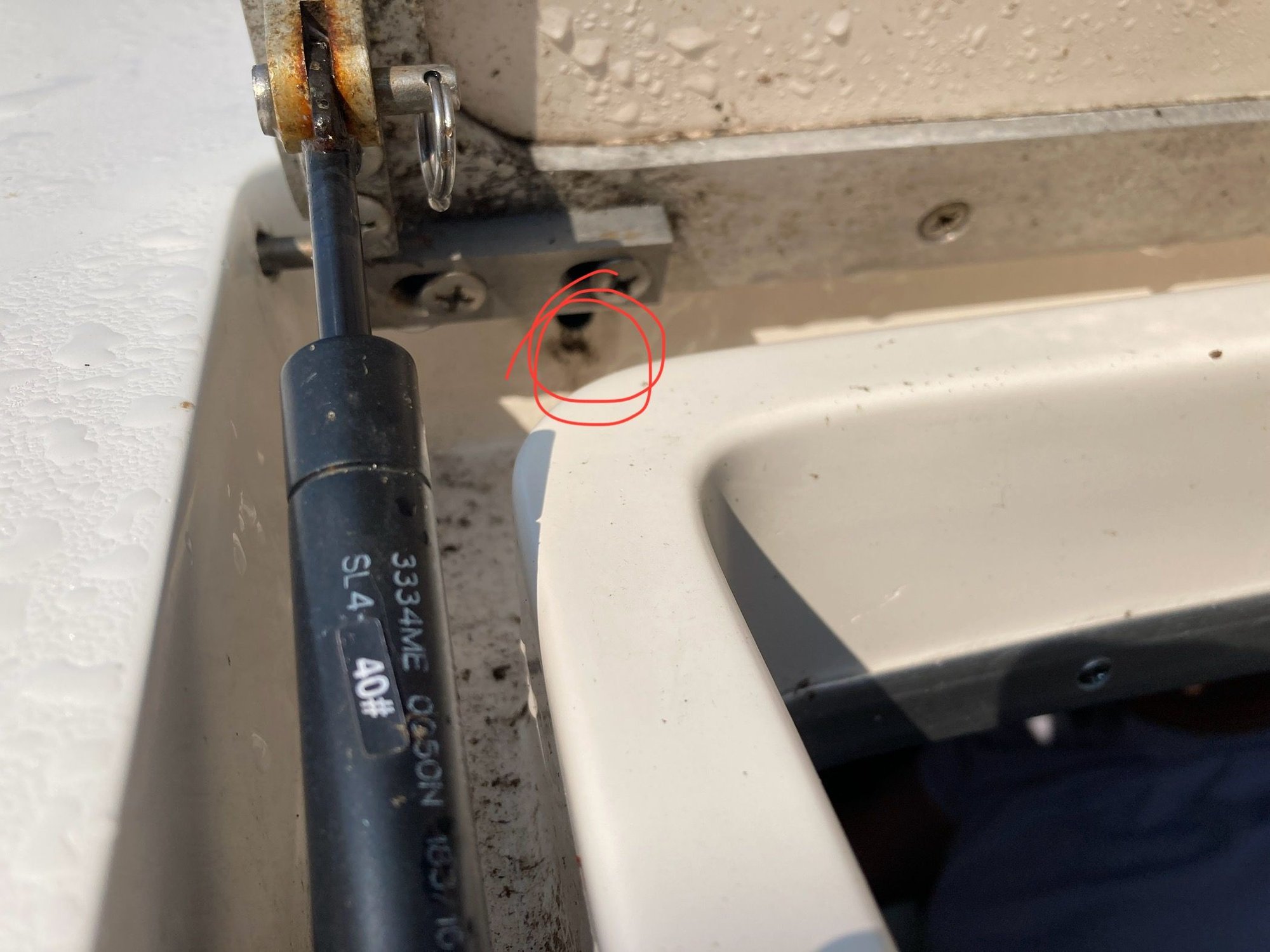

Old 07-31-2024 | 02:25 PM
Joined: Aug 2020
Posts: 76
Likes: 15
From: Charlottesville, VA & Thousand Islands, NY
Default Holes in the deck go into the back of the hatches
Hopefully this shows the holes properly

Old 07-31-2024 | 08:36 PM
Joined: Jun 2022
Posts: 648
Likes: 447
From: Tullahoma Tennessee
Default Awesome!
actually makes sense now! Mine looks to have been covered up by something at some time.
where do they drain to?
thanks!

Old 08-01-2024 | 06:21 AM
Joined: Aug 2020
Posts: 76
Likes: 15
The backside of the inside of the hatch by where the strut connects. I will try to take a picture today and show it.

Old 08-01-2024 | 08:46 AM
Joined: Aug 2020
Posts: 76
Likes: 15
Default Second attempt
Here it is. I tried once and something went wrong. It is the hole under the screw on the right.
TICafeRacer is offline
Old 08-02-2024 | 12:02 PM
seafordguy's Avatar
Joined: Jun 2006
Posts: 5,125
Likes: 968
From: Seaford, VA
I think they are molded so you may be able to blow them out with compressed air……

Old 08-02-2024 | 12:13 PM
Joined: Aug 2019
Posts: 1,266
Likes: 423
From: BC
Looks like a raised fiberglass rim covered completely by the hatch? The only way they would leak is if the drain was plugged and the captured water is sloshing when running getting past the seals, or totally full and weeping past bad seals?
