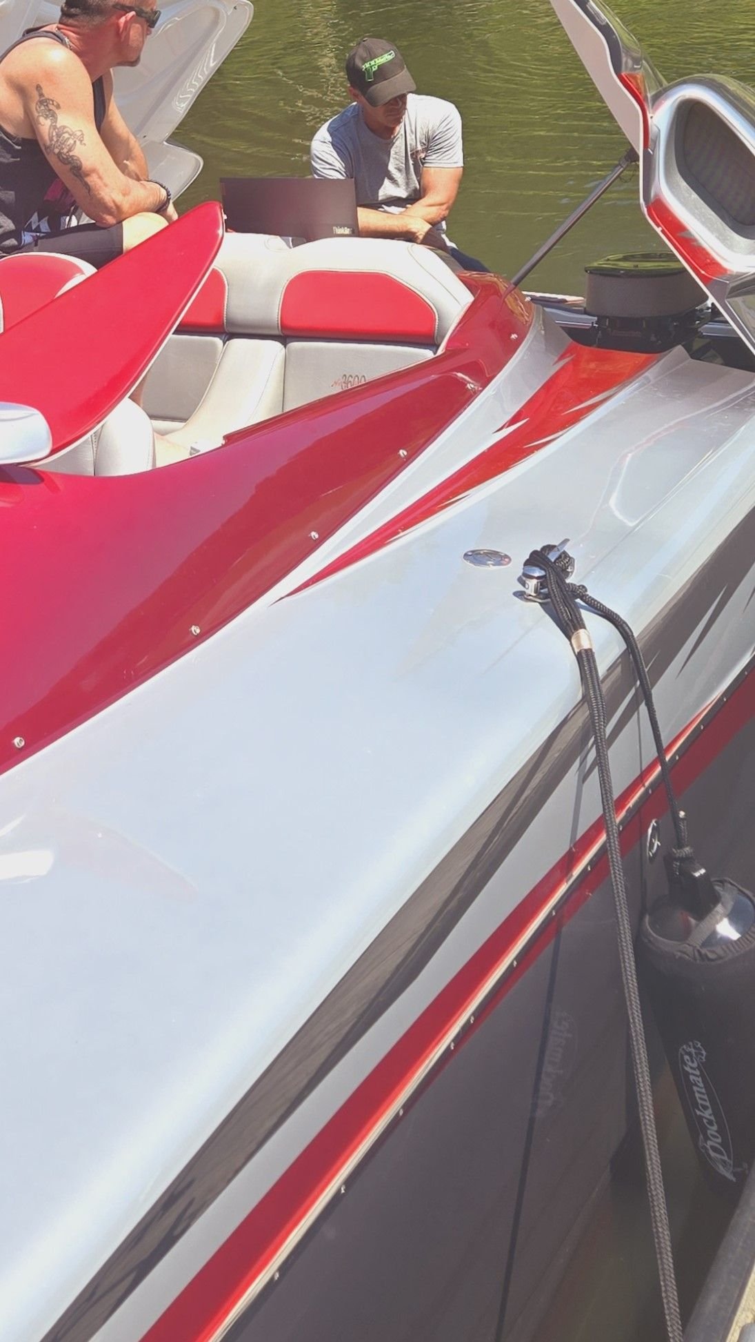

I had the loop style pins on the cafe racer. They were cool. I wasn't worried about them leaking really and they didn't have a "cap" over the hole when the pin wasn't in I didn't like the fact the lines were pre tied on. Fine for docking as most docks align at the same spot. but like you said, side tying sometimes takes fenders at the rail to avoid rail to rail contact. Can't do it when your fenders are pre determined and can't really tie them to a cleat or something else when there's a huge piece of metal dangling around ready to f*ck some sh!t up on the end of the fender line.

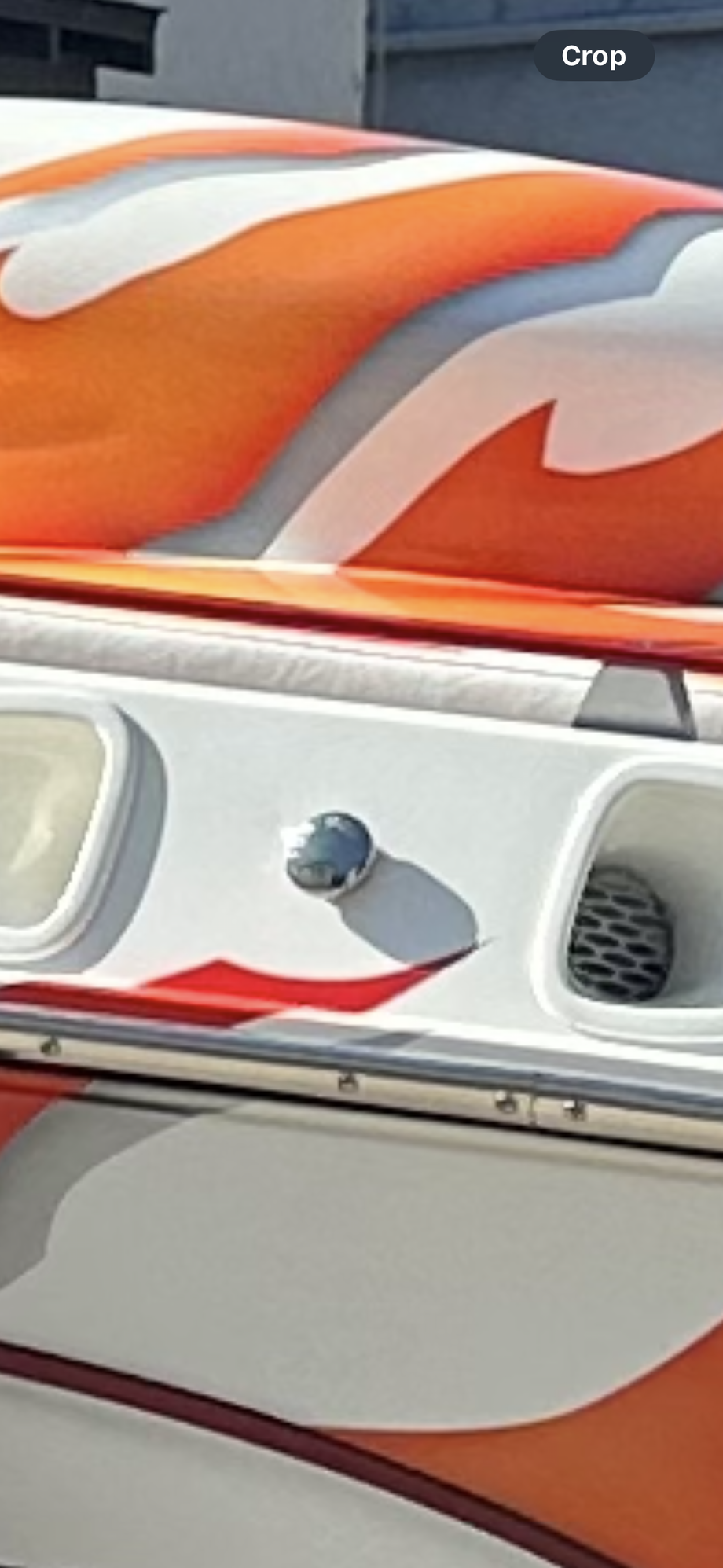

Our current boat has the push / pop out round mushroom looking things to tie the fenders on. Pretty slick. You pop it out and then loop the fender around itself and the weight of the fender keeps it in place or you can do a quick loop / pull to secure it better. Point is, you can lower or raise to wherever you want pretty quickly. And if you REALLY wanted to make it easy you could tie a loop knot in the fender line permanently to hand them at dock Hight quick and easy and then easily raise or lower them by looping manually if you're side tied or whatever. Bottom line, I like the ones I have now much better over the standard pin cleats or pin cleats with metal loop.

I don't like the pin cleats, as you have a hard metal pin swinging wild on your fender line when you are moving them around. That leads to paint and gel chips, especially with those that don't realize they are there. You can't just toss the fenders on the bow, in the cockpit, or throw one to someone during a rush or in case of emergency. If separate points for fenders are required, I definately prefer the mushroom cleats.

For rails I really like the quick adjustability of the Folbe clips. Just make sure you get the right size for your fender lines dia. And for non rail areas I like the spring loaded mushroom style cleats. As said before, you don't have a heavy object dangling from a fender that will damage the boat. Both of these options come in different color options as well.

I have used the adjustable ones in the first pic on both of my boats they work awesome and also can be used on pop up cleats with dock lines at the same time. New boat has some pins in it but I don't use them due to the possibility of scratching things if people (everyone but me) are careless.
